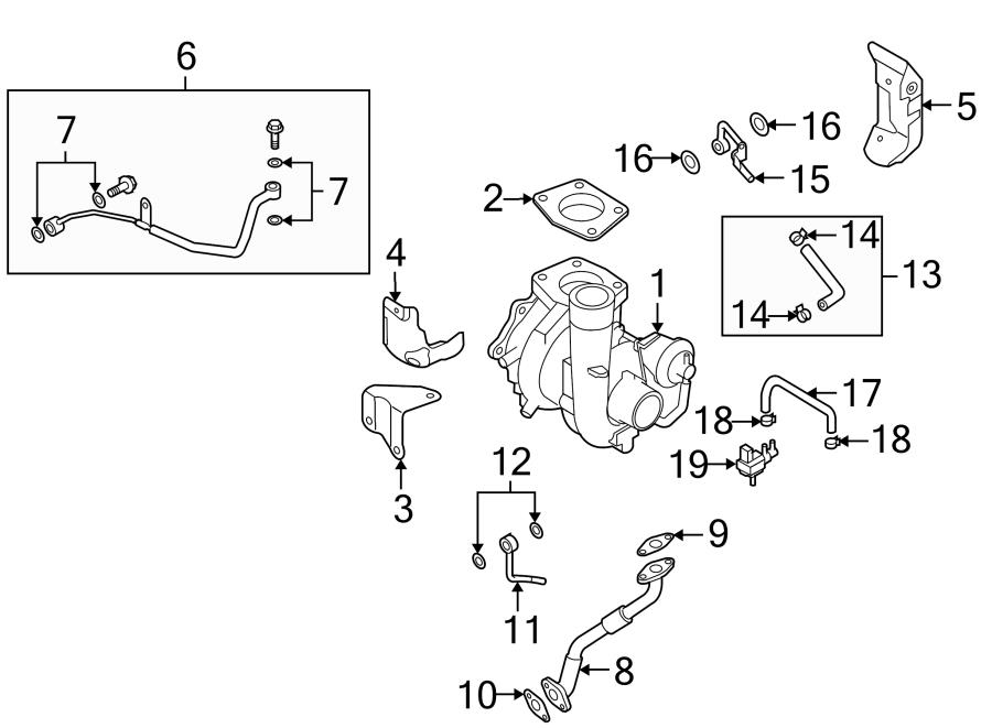

ok so its the copper gasket on the turbo oil feed line? Do you have a part #?
Update: Sorry I mean gaskets 9 and 10 in schematic below?

#9 that's the oil return line

You mean the gasket is #9 (and 10). The hard line is #8 .
I watched the area while the engine was running and someone was raising RPMs and I saw no dripping.
I see wet spots that could be point of origin as indicated by the colored arrows. Red circles are just real wet spots and the black arrows are direction of flow of the leaking oil.
I wonder if the oil return line gasket could create such a pattern of leaking. Almost like its spraying oil under some maybe high RPM/load situations.
I know. I should have worded that better. #9 is the gasket. The gasket is for oil return, not oil feed. It would leak when you turn the car off

Yes indeed return oil back into the block.
I actually saw some minor oil flow from the nut around/under indicated by the RED arrow but I cant be sure where it was coming from.
