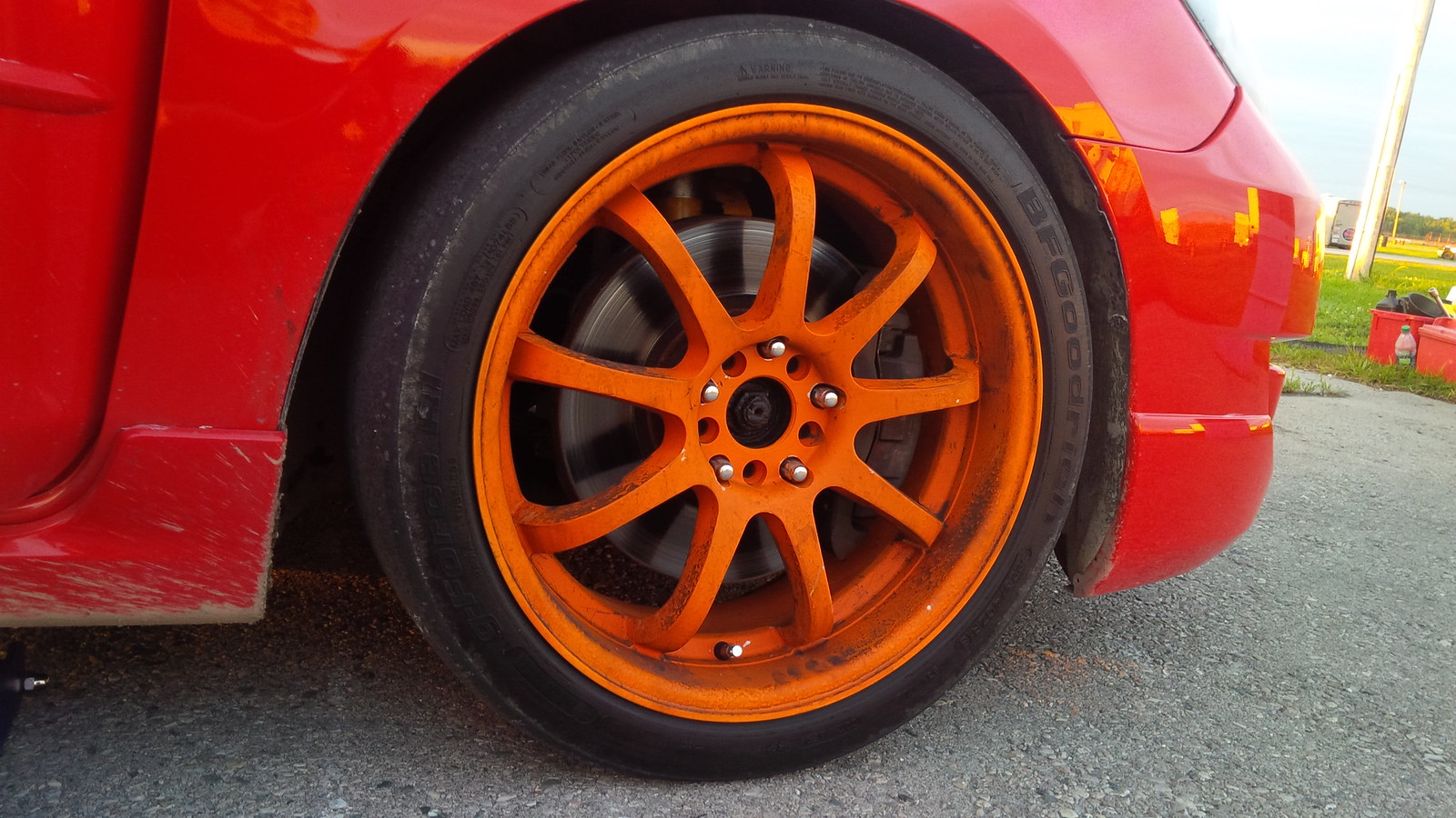

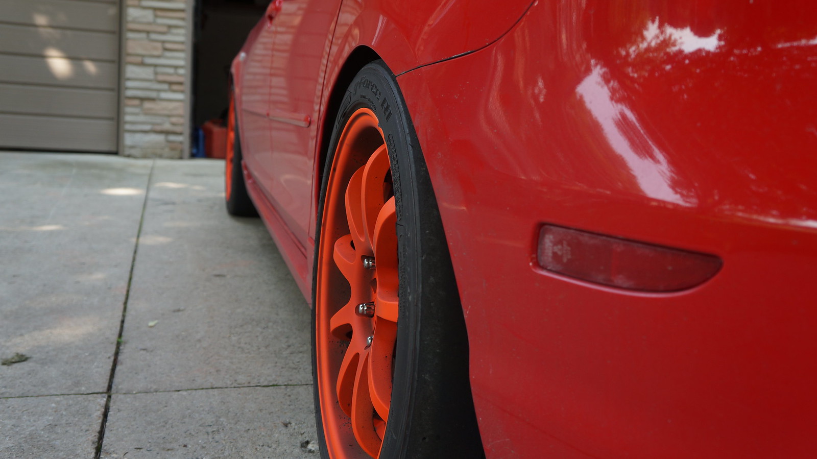

Mid summer the game changed, I bought a dedicated set of rims and slicks for the track.
The RSB really squeezes all available traction from the tires, It was actually surprising how hard I could corner. At the track I was faster than cars that I should never be able to beat.
