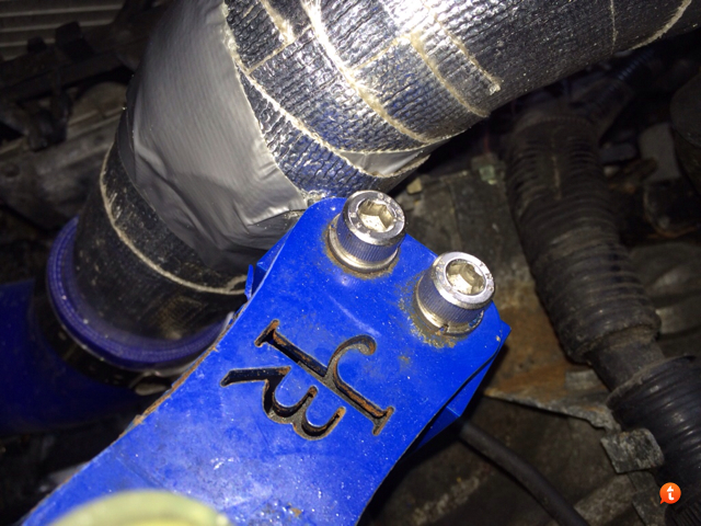

Id buy. For sure. Also plz make it work with your ssp lol my jbr ssp hits my fmic pipes, a smaller weight would take care of that. Im deff down for jbr pipes with tr8. Perfect match.

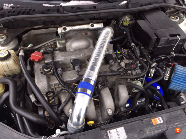

When it's light out tomorrow I'll take some pictures of where my CX kit rubs against your shifter weight and the runner on the intake manifold. I think the CX routing is superior to routing it all by the intake and with some careful bends in the piping, the problem spots could be avoided.

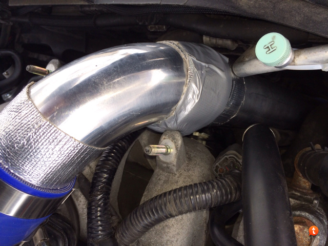

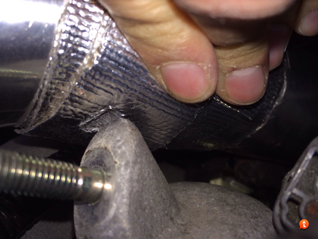

Ok so here is my cx racing kit on a gen 1 speed 3. You can see that the hot pipe runs against the runner on the manifold. Ignore the duct tape lol. It's keeping a piece of rubber hose in place which is keeping the pipe from puncturing. You can also see where your shift weight hits the cold pipe. It gives a feel of resistance when shifting but doesn't prevent me from getting in gear. Hope this helps.
