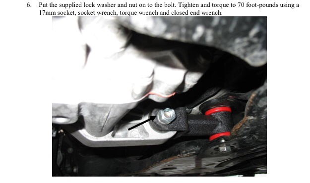

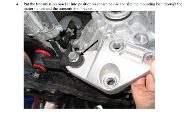

Oh ok I thought it utilized the stock bolt.
As I was
He bought the mount second hand and the seller didn't include anything.
@jbarone; this is what confused me because in the directions it utilizes the stock mounting bolt.
