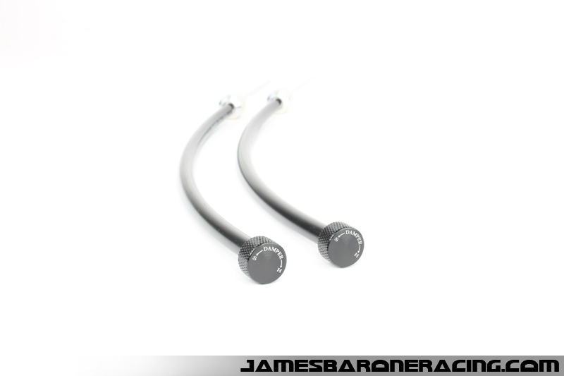

I recommend a different rear shock adjustment knob position. Top styled is a pain to manage with needing to remove the shock for adjustment. There is no rear access from the trunk. There are manufacturers that offer adjustment knobs at the bottom or middle of the shock cartridge.
Also, the rates appear to be too soft for anyone considering more than entry level tracking/auto-crossing. More advanced drivers will easily outgrow those rates especially if they are packing really sticky rubber. Some things to consider.

Our coilovers include long remote cable adjusters to make it easier to adjust than any other brand we're aware of. No need for jacking up the car or crawling underneath.
As for the spring rates...We chose them because most owners are really only concerned about the ride comfort on the street, the drop and the effect on the ride comfort, the occasional auto-x or track day (as you mentioned) and durability.
They can easily be swapped out for any TEIN style spring.

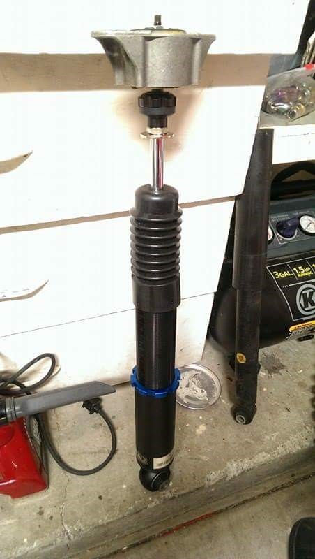

This is what I'm talking about. The adjuster is under the rear mount on the SCALE coilovers. Yes, you have to jack the car up, but you don't have to remove your shock or hack up your interior. Or as seen in the attached pic, for the Mazda2, the rear shock was inverted and the adjuster was put at the lower mount. I know when I used to have my BC's installed (before they blew out at a track event), that was one major thing i hated about them and I know others with Gen1s and BCs/Ksport/ other generic coilovers have said the same thing.
Just bouncing ideas around. It's nice to see suspension advancements on this platform nonetheless
Originally Posted by Solarsurge View Post
I'm not 100% sure about Gen1, but on Gen2 Speeds you don't need to remove the shock to adjust the top. The long plastic interior trim pieces that the seat belts go through and the luggage cover pegs clip into come off rather easily and expose the tops of the shocks. You can adjust them from inside the car.
You definitely have to remove the interior plastics and then hack up the sheet metal that encloses the tops of the rear shock mounts. I'm pretty sure you have to hack them up even with the remote adjusters just to keep them from binding (smooth/natural routing).
