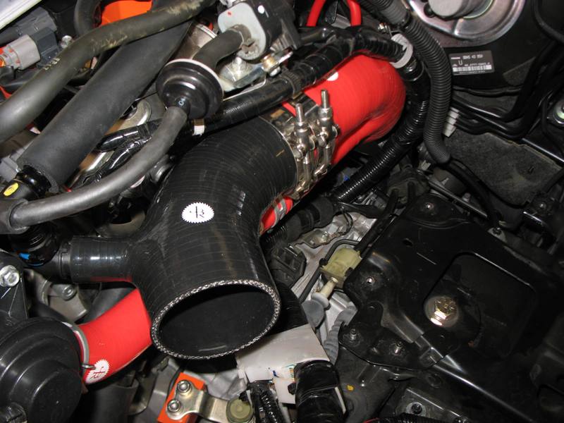

I'm having this same issue. I can't get the hot side to fit right at all. There is a gap on the bottom and the top won't go on all the way.
I have a Street Unit TMIC and it has a little lip on the lnlet of the TMIC and I think this might be part of my problem?

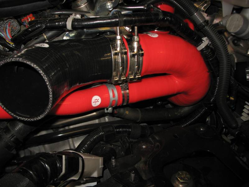

Here is a pic. And the only way I could get the clamp to fit was like this.

I have no experience with that intercooler but it looks like the hose is not on all the way.
It isn't on all the way because it doesn't fit right. Adjusted and took a few more pics. Now it's even worse.

you guys didnt think these were made for the stock intercooler?
@jbarone, may be good to add an intercooler fitment disclaimer for these if you havent lol.
ahfunaki- you may wanna use a smaller width worm gear clamp on areas like that rather than a t bolt clamp.

Originally Posted by Standsideways View Post
ohh fail.

Originally Posted by ahfunaki View Post
Get rid of the wide t bolt clamps on stuff like that, look at the pic...Use worm
Gear clamps.
Looking at the pic ide agree with jamie, you dont have it on properly.
There fuckin silicone boost tubes not sloppy limp dick hoses.
http://www.onpointdyno.com/?p=2676
Click the link, GO TO THE BOTTOM AND READ ABOUT why you waste your $ on fail t bolt clamps.
You should not be using those clamps and you dont have the hose on properly.
Jbr got it right.
Sasha Anis from onpoint/genesis racing-
"Forget T-bolt clamps. They are way too wide to do a good job of creating a sharp clamp on the piping and in many situations there is not enough depth from the rolled bead to the throttle body / intercooler for proper clamp engagement after the bead. This is asking for trouble! Always use high quality stainless steel clamps. Home Depot sells Trident clamps and they are fantastic"
Just your clamps alone are contributing to your headache, they are too big and wide and when you tighten them they will work the hose off the hump(ESPECIALY WITH SILICONE HOSES LIKE THAT)...like explained in the link above.

None of the bigger tmic's require the user to change the stock boost tubes. There's no reason why these shouldn't fit since they are direct replacements for OEM. I would get it further down on the outlet and see about getting the tmic inlet side further into the tube.

To me it looks like it should slide on a little more to the TMIC. If your OEM boost tubes fit then I see no reason the JBR ones shouldn't fit. You can always take them off and compare side by side with OEM. Either way good luck and I hope it all gets sorted out.

I had to trim mine a little shorter as they were about half an inch longer on both sides of the bend when compared to the stock tube. I'm fine with having to do a little trimming as you can always remove material but never add it. From your pictures the way your tube is kinked looks like mine did but I had mine pushed all the way down on the turbo and the intercooler.
