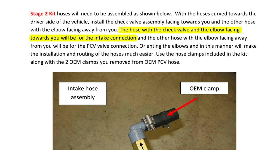

@agentgordon27; you installation is backwards... the check should go into the PCV not to the intake like you have it on your picture #2
That's only if your running the VTA kit. As long as he isn't running the VTA kit he's correct.

it doesnt say anything about vta on the instructions

Exactly, The picture Matches what jbarone explained there, the check valve should go on the PCV side and he put the valve going to the intake...
forget about letters, compare his picture and the picture on the instructions....
@jbarone; is it right or wrong the way @agentgordon27; installed his kit?
Look at his second picture

COMPARE THOSE PICTURES WITH HIS
Looks like were looking at 2 different sets of instructions. Read the screen shot I took. I think the ones that I have are the most recent.

yes there are 2 different sets, but he has the OLD kit so he has he needs to go by the OLD instructions, the ones im saying, The new kits have the valve coming right out of the OCC and in the old kits the valve is in the hose coming out of the PCV valve...
Sounds good @jbarone; you probably should clean this up so no one gets mis informed.

Note JBR changed the location of the CV, by popular demand.
There are two kits, one with the CV on the PCV side (pre 12/12), and another (post 12/12) with CV on the intake side. The CV needs to be set up to move air into the intake, closed to air moving back to the PCV.
The kit agentgorden is rocking is the newer setup.
There are two kits, one with the CV on the PCV side (pre 12/12), and another (post 12/12) with CV on the intake side. The CV needs to be set up to the open into the intake, close to the PCV.
then why on his pictures his CV is going into the intake side on the hose? not right next to the OCC like the instructions show?
Sorry, did not see that must be newer. Easier to fit CV so you don't have to wrestle it up that narrow space?
Don't think it makes too much diff, as long as it points the right way?

my point is that he has his CV going in the wrong spot, he has it going in the intake hose but is has to go on the PCV hose, dont know if that will make any difference waiting on jbarone to chime in....
if he had it on the pcv hose then it should`nt matter in which end.. but this is not the case =\
 Old 05-30-2013, 08:26 PM   #145
agentgordon27's Avatar
Location: Ft. Huachuca, AZ
Posts: 560   (View Stats)
Thanks: 1,541
Check this out, the most recent photo you have is the THIRD set of instructions that I have seen. The first I had that I downloaded AFTER the whole before this date and after that then do it this way.
Also, my check valve was actually built different from what the photo was showing, arrow was pointing the right way but the smaller brass insert (or whatever it is) was on a top instead of on the bottom.
ALSO, the arrow was not shown or specified on my original instructions, the second set I saw were the same as the original I downloaded and printed but there was an added red arrow (correction, black arrow like @DTKII; posted) on the check valve dictating the way the arrow should point when installed. This mention makes it the third set with different info I have seen.
Let me get some scans of the printed out instructions I used and post them up to try to figure this out.

I do understand that there are more than one set of instructions but all of them have the cv on the hose that connects to the pcv and your pictures shows your cv connected to the hose that's going to your intake.

So re-reading stuff looks like I'm fine.

plus looking at the check valve installed next to the can photo, the arrow is pointing the same direction as mine that is on the intake hose side, its just moved down for ease of install. DAMMIT, I knicked up my knuckles feeling around my engine bay making sure it was right, @Cevaes_64; owes me some neosporin and band-aids.
