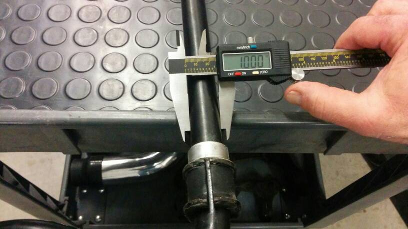

Attached pics.
The top bolt on this side wasn't amazingly tight, but it also wasn't stripped enough to pop out. It's still been banging the bottom of the car.

Originally Posted by Dimenus View Post
Attached pics.
Ryan, come on. You have stripped out holes and you know that. No sway bar is going to perform as designed if you can't torque the bolts down to spec. Whether it's tight enough that the bar can't pop out or not, it still can shift. That bar is not designed to shift like that. The reason you may be seeing issues with the JBR bar over the stock bar probably lies in the fact that you using a stiffer bar. It's going to bring out the worst of the issues.
I understand you are probably going to go back to a less stiff bar as your coilovers help with stiffness enough for your liking, but please be completely transparent when you are posting about the issues you have. The issue isn't the bar- it is likely the inability to properly secure the bar because of a hardware issue with the car.
I wasn't blaming Jamie at all. Someone asked me to post pics.
Calm the fuck down.
There still is a lot of leeway on the brackets with a small amount of clearance. The stock brackets do not have that kind of range even with a much smaller diameter bar.

I'm not trying to attack you or anything. I just want to build the context around your situation so people aren't jumping to conclusions without all the facts.
This bar has still either creaked or clunked since I've gotten it. It used to creak which was mostly my fault (using shitty grease) and since It's been swapped on and off quite a few times, the nuts don't have the kind of threads they had originally.
However, I do want to know why collars that allow the bar to slide up and down are included with the kit if there's a tiny bit of clearance on especially the driver's side. Jamie even said it himself that you should move the bar down as low as possible to avoid it.

Rep Power: 7119
They are brackets not collars.
The brackets are slotted, just like all the brackets every other manufacture supplies because, they are off the shelf. Custom brackets and bushings would push the cost of the bar too high.
Now, if you would address the issue with your sub-frame, this would be the end of this discussion no? The bar WILL NOT make contact if you can get it tight. It will not move AT ALL if you can get it tight.
I as well as several other people have tried to help you. I'm not sure what more can be done to help.

If you torque the bolts attaching the collars to spec they don't move.
Following your logic, I could strip out my crank and then blame Mazda's design when I jump timing since I only torqued the crank bolt to 40ftlbs.
And you answered my question about the brackets. Thanks.
I know most of my issue is related to my own fail at this point. No problems here. Thank you for following up.
No, that's not what I said at all. I was just asking why jamie included brackets of that type. Which he already answered.
