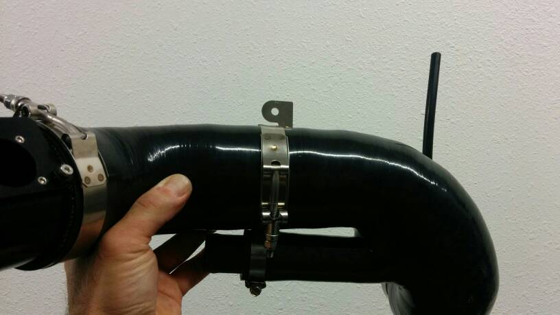

Because the intake diameter is larger the intake should be quieter, or at least have a more diminished sound of that suction sound. This is good or not so good depending on what kind of person you are.
Personally I am pleased with the sound of my current intake setup, but on Monday... BUT ON MOONNDAAAYYY..... we will fit the holy mighty whale penis onto the car and I'll tell you more.
First impressions after putting everything together on the floor:
- the shape of the whole intake shows a lot of attention to detail and care for its shape AND for preserving the 3" diameter;
- a very pleasant surprise was that in the package there's a clamp with a mounting ear that you can put there to use the factory mounting tab that's near the fuel pump;
- I wish the hose for the EBCS bleeding was a bit longer. Most of the people who purchase the 4" turbo coupler version will have an aftermarket EBCS which will not be in the factory location;
- the air filter has about the same base diameter as the K&N filter I'm using now with the CObb intake and CS CAI Box. So there's a good chance that I will be able to keep the CAI Box on the car since the MAF housing allows for a decent amount of adjusting;
- basically in the package you will find the maximum number of clamps that you may need;
- the silicone is very stiff and should not have too much play while it will still be able to vibrate a bit to absorb any vibrations from the engine bay/turbo/whatever. But it's stiff enough that you can beat your kids with it and still fit it on the car no problem after that.
- A few years ago when I opened the box with the Autotech internals I first thought the Edge guys played a joke on me and sent me some collection die cast car. Then I found the internals in and they were looking like some jewels. Well, the MAF housing was wrapped in a piece of hard paper but when my fingers finally came in contact with it I had the same impression. This MAF housing looks simply beautiful.
Mauro_Penguin likes this.

Here's the JBR Tru 3" intake fitted with all OEM parts: OEM battery tray, OEM ECU covers, ...and the CorkSport Air Box for the Cobb SRI!
I threw the battery tray in place with the ECU still bolted to it. The tray is a bit kinked but I could screw the bolts nuts in. WIN!
I thought I was lucky, so I king of forced my luck with the tools I had. the CS air box seemed to be almost perfectly aligned with the MAF location.
We added a rubber grommet (a strut mount from a Smart ForFour) which happened to have the right inner diameter. The idea was to prevent the MAF housing from vibrating against the air box. If it's also sealing it, even better. Epic WIN!
After some time of screwing around with the air box and the air filter we test fit it. Mega WIN!! I was feeling like drinking a beer, even though I drink like 2-3 beers a year.
Time to throw the battery in and put everything together! Galactic WIN!
Job done with all parts. ...out of superlatives... no, wait: Romanian WIN!
The intake seems to be a bit kinked after the PCV feed but not by much. The air box is pushing the MAF housing against the softer part of that silicone tube, but when I will work in that area again I know what I have do to.
Also, the air filter has a larger diameter in the smaller cone area so the top of the air box is also pushing that a bit down. But that's rubber and will kink just fine.
The Stratified MAF cal is -3.1% - +1.6% in the range I logged, just like my old MAF cal for the Cobb SRI. i didn't push the car today for a WOT log because the laptop battery was almost done. Thank you @Lex and @Mike@Stratified for your work on this.
