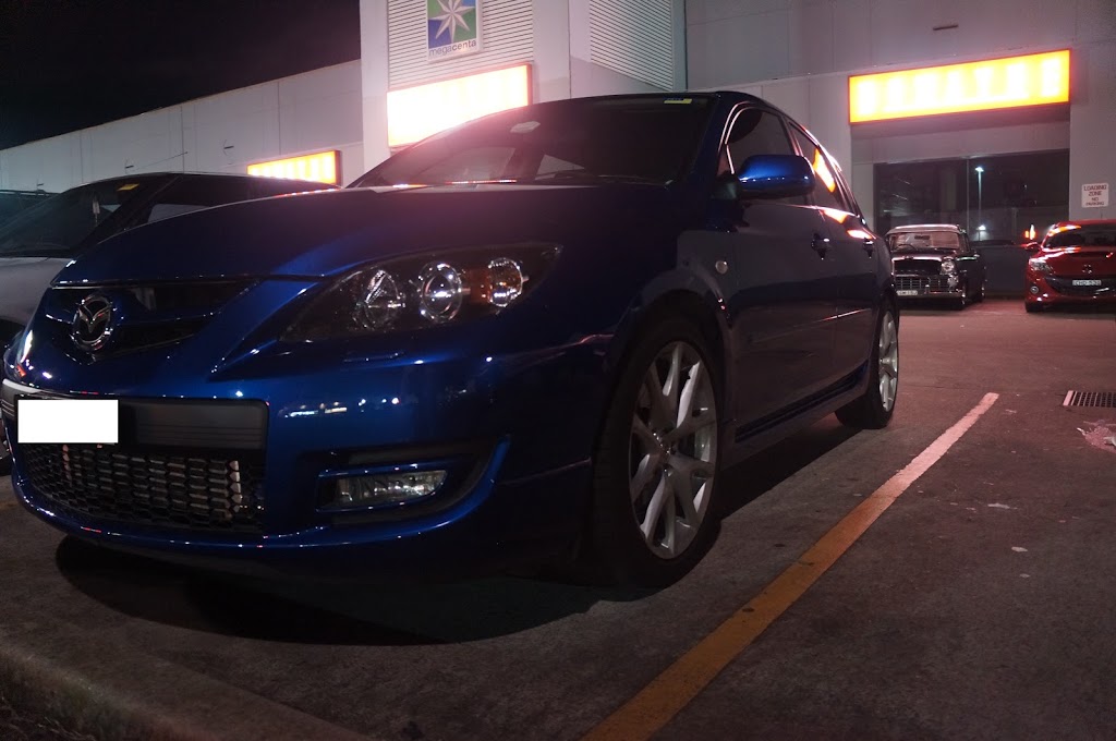

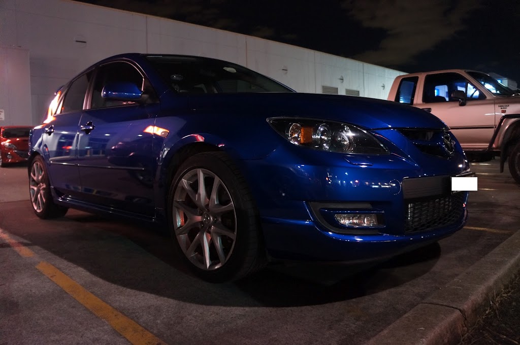

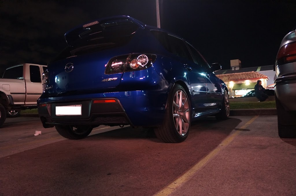

Few pics:
before/after turbo shot
engine bay:
front of car now:
well earned:
Rims on car (taken by phone... rather than other which are DSLR):
thinking they might need to go darker... also, i am struggling to get a decent photo of car side on... simply due to crappy lighting conditions
