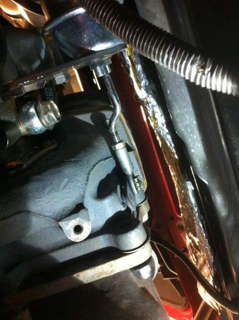

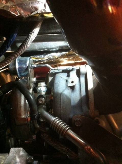

OUpdate: So I have over 1000 miles on the motor now and all ahs been going great. No leaks, boost was good, and I changed the break in oil at 1000 miles in. I was goint to start data logging to get my tuning started and then it happened. Vehicle would not build boost at all and the exhaust was notably loader at low rpm.
I found the waste gate actuator arm off the waste gate. The c or e clip had come off. This was a little odd. I have not touched or removed it.
I ended up scrounging around an getting a seat harness locking clip off a 92 5 series BMW. Fit snug over and locks on.
All is good again.
@rfinkle2; prepare yourself. Logs to follow.
