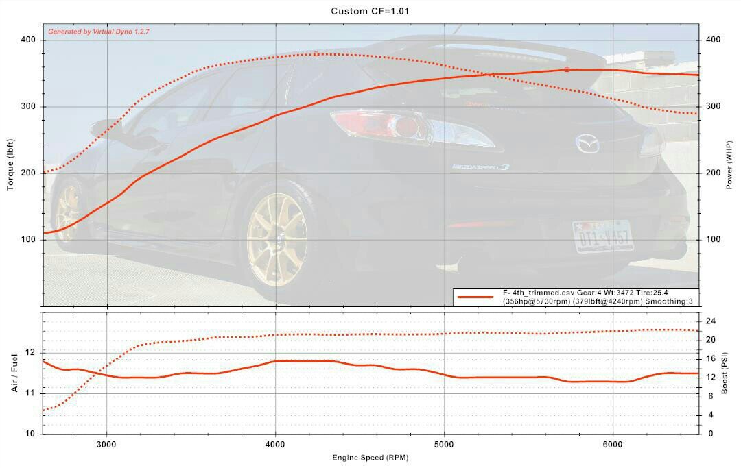

I think it's a great thread, Rob. But I didn't see your experience listed. LOL. I think we should set some guidelines, like relevant data, to see what people are experiencing.
Here's mine:
GTX3071R
TMIC
Valero 93 octane
Can safely run 21 psi, with a max of 11* of timing
Afr around 11:1, with idc's below 100%
This has netted me roughly 340whp

GT2871R
Cobb FMIC
Custom exhaust manifold
Full 3" exhaust no cats
3.5" intake
~100% IDC in 40* weather
11*@22psi
Shell 93
West Virginia/Virginia/DC
I had a tuner ask if I had head work done and other people ask what was wrong with their car. It's all about flow mods, my engine is completely stock.
