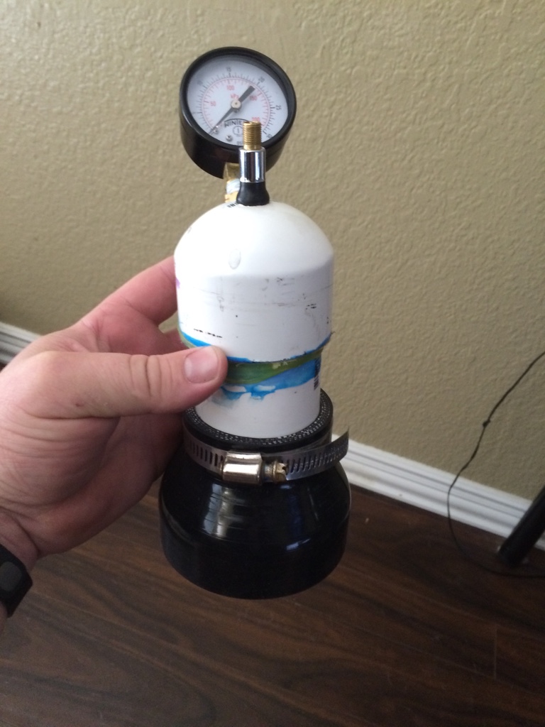

Update on what I thought was a leaky GFB TMS.
@kevdog; @Zdraveca; @Justin@Freektune; @RPM;
Unless I read go fast bit's own study incorrectly, their BPV/BOV are design to leak a certain amount of pressure.
From the results above, it can be seen that the expected leak from a GFB TMS valve
represents such a tiny percentage of an engine’s total airflow that it would be impossible to for any engine performance measuring equipment (such as a dyno,
boost or air/fuel ratio gauge) to detect the slightest change in boost level, torque or air/fuel ratio.
When boost leaks are suspected and tested for on a car, this is usually because a loss
of boost pressure or performance has been noted. Smoke testing or pressure testing
the intake tract will often discover a leak from the BOV, but the size of the leak is not taken into consideration by such testing.
Link to the whole study: http://www.gfb.com.au/images/tech-ar...ter%20leak.pdf
So I'll be putting the GFBTMS back on. Though I still think it was a pretty significant leak. I've only been hitting 19psi on the stocker (not sure what I'm targeting), so I'll see if I start hitting more with the GFB.

That was a pretty significant / fast leak though. I'll run another test on my car soon so see how much mine lets pass, if any.
https://www.youtube.com/watch?t=25&v=RmdhjwNuK2Q
For those that don't feel like watching the video. The boost like test we did left the recirc tube connected to the bpv. Their bpv isn't designed to feel pressure from the recirc side because these aren't normal driving conditions. While we definitely had a leak at the base of the bpv, the "leak" we saw from the trumpet, shouldn't be seen under normal driving/boost conditions.

Ok so basically preasure was coming back from the recirculation tube. That's some good info.

Stocker definitely couldn't hold the boost. I never got it over 19psi. As soon as I swapped the gfb back on I was hitting 21-22psi.
