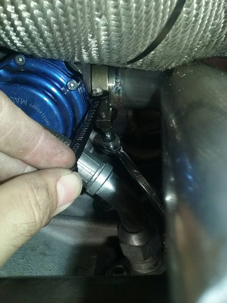

So figured it wouldn't be hard to swap out. Vband bolt and nut were seized but loose, and I realized I must've put it on when the downpipe was loose or off. Burned through 2 bandsaw blades trying to cut a 3/16" Allen key and failed. If it was just a little shorter I'd fit it up beside the DP. But as I was thinking about it in my despair lying there on the ground for what seemed like forever, I don't think I'd be able to tighten it once the dump pipe was on and in the way.
These cars are fun to mod. But not to maintain once modded.
Trying to mess with the EWG while the downpipe is on is the biggest pain in the ass ever. I had to mess with it twice in about a week timespan and it took me so much longer than I was anticipating.

Good news! Did NOT have to take the DP off! I had an epiphany after I bought some tools from sears. Got under and put a 3/16", 1/4" bit in the hex bolt that was facing the DP, then got a tiny 1/4" wrench I just bought and then put a tiny 5/16" wrench on the nut and they came right off.
Decided not to wrap the dump tube this time because I have a theory it came undone last time and wrapped around the axel. I might get it ceramic coated at a later.
I also flipped the bolt and nut around to make it easier next time.
Bit ratchets are awesome.
