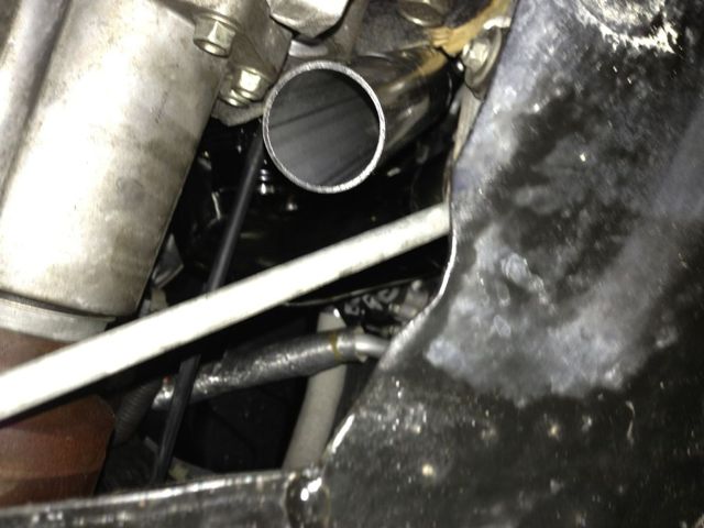

You had to order that 90° adapter from edge with the big trbo because you have a 6 right? Is that 90° adapter your dumptube or is that something seperate?
 Old 12-06-2012, 11:15 AM   #15
COspeed6's Avatar
Location: Littleton, CO
Posts: 419   (View Stats)
COspeed6 is the leader of the worldCOspeed6 is the leader of the worldCOspeed6 is the leader of the worldCOspeed6 is the leader of the worldCOspeed6 is the leader of the worldCOspeed6 is the leader of the worldCOspeed6 is the leader of the worldCOspeed6 is the leader of the worldCOspeed6 is the leader of the worldCOspeed6 is the leader of the worldCOspeed6 is the leader of the world
Thanks: 675
Thanked 447 Times in 200 Posts
Yes I needed the 90* v-band adaptor because without it the dumptube will hit the transfer case. You have to put the adaptor on the turbo, then put the wastegate on the 90*, and then the dumptube goes directly onto the wastegate.
