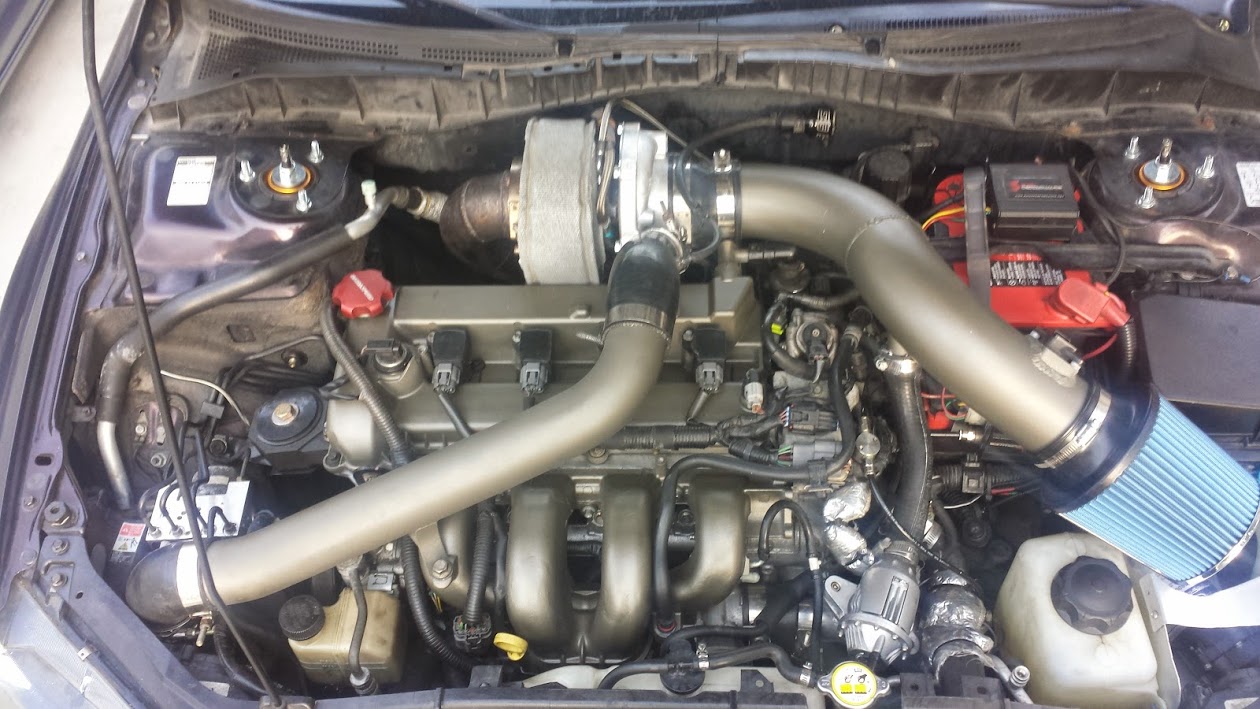

Hmm. Sorry about that. My lines cost about $35 from ATP and then a few adapter fittings on the side. Probably have about $70 in mine. I used the normal metric to 6an nipples on the turbo then 45 degree swivel 6an fittings to short sections of 6an line one end being a 90 degree adapter and then a 6an to barb fitting. The less you have ATP do, the cheaper it is. I needed the extra 45 swivels because my new arrangement is clocked to clear the T4 housing.
You can see them in these two photos.

Hardest part of any build is making things last. That's one thing the oem's are fantastic at, and aftermarket generally lacks.
I'm still so new to the car game in terms of "longevity", and what works / fails over the course of years. It difficult, cause it literally takes "time" to test things out.
What i have learned thus far is heat management and bracing is very important. If something wobbles or flexes a lot while the motor is running, it will eventually break. And if something is in far too hot of a region, it too will eventually fail.
Crazyp, those lines should do the trick, they're expensive, but it's worth the piece of mind.

Originally Posted by unijabnx2000 View Post
Since this seems to be the second turbo to eat itself... think its time to investigate?
3 years apart, don't think they are related personally.
Now after tearing it all apart I have come to the conclusion thats it's my fault really, I drive this as a daily and for having fun and its been super reliable with minor issues.
So what did I find? All the lower exhaust manifold nuts were loose and one was only held in because the wastegate was in the way. Also my intake mani bolts were not as tight as they could have been. My intake filter has a small hole. So I think I overworked this turbo to death, it was spooling a little slow lol. 25PSI at 3900 rpm.
I also found 3 small cracks inside the turbine housing, 2 where the chra is inserted into it and one on the divider. ATP seems to think its ok, but once I get some more funding I'm going to switch it out. Anyways, new pics after sprucing THE CAR A LITTLE
Do you have a vacuum line from your valve cover to intake manifold?
No why?
Reading this post while not fully liquored is bumming me out. I've had some boost leaks for a couple years (cut me some slack, I had to tcob, cpa exams, etc), but lately the girl has been hurting. I've been going easy on her ever since the rebuild 2 years ago (despite only a 2% difference across all 4 post rebuild).
So, she almost died on the fucking highway the other day under moderate throttle, felt like limp mode. I pulled the codes yesterday... threw 2178, 2188, and our old friend 0335.
The leaks had me rich at idle, which I knew, and due to (enter bs excuse here), I just added fuel at idle as necessary to pass inspection. I had zeroed out the maf at early volts per Ziggy et al, and hadn't seen the P0335 in ages. But she almost went down the other day... and I have new plugs coming, and an oil change and fluid change on the way.
So I guess if I were you guys I'd say 'finish your long over-do tune up homo, fix all your boost leaks, recalibrate maf, and stfu.' I may be out of touch, but I get it. guh, nigga I don't have time for car problems. I'm just paranoid, and reading this, I'm like "my turbo is probably shot too."
EDIT: Have been getting on it a few times lately.. turbo lag is like a 35R with ADD... I think boost leaks would just be overpowered, unless some sniper has been putting 50 Cal sniper shots into my engine bay. But wtf do I know. @crazyp; @jmhinkle; @DeezNuts; HAHAHA I didn't know deeznuts was a user name. That was supposed to be a joke. Feel free to chime in, after watching the first 13 secs of my vid: https://www.youtube.com/watch?v=3VuEPH_6Lyk
