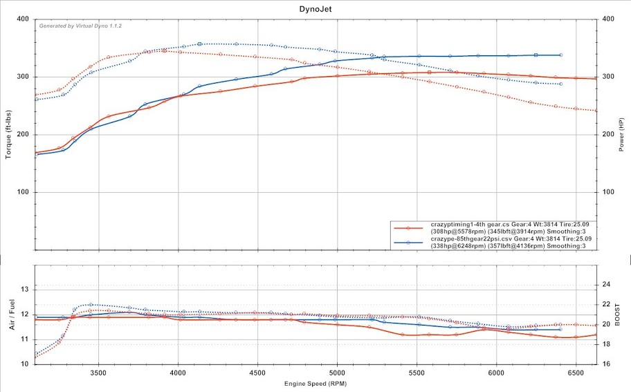

here is a graph from virtual dyno comparing tuning and increase in boosrt pressure improvements. I know the numbers arent real just using it for seeing improvements

graph compares 93 map against e85 map. the knock on the 93 is crappy but no knock on e-85. logs attached

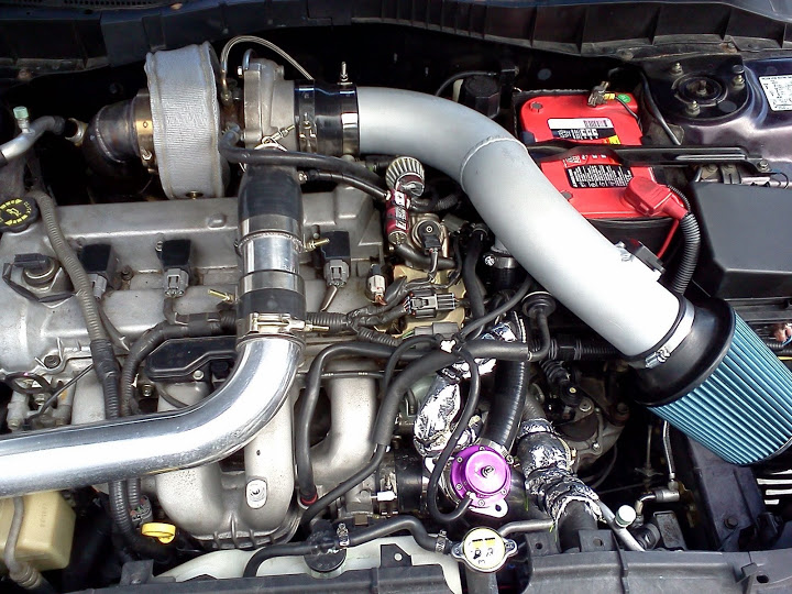

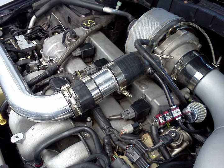

updated pics showing how I run a flexilite fan controller and turbosmart MBC. Plus I installed the silicone coolant line recommended by @jmhinkle

Looking good holmes. That filter looks awfully familiar. I have a manual ECT switch I have to rig up next weekend along with some other knick knacks. I like the FrankenCoupler
Thanks.
I ordered a grimspeed MBC hoepfully with that my boost spikes will go away and Ill be able to dial the boost a little better.
I also cut about a half inch off the intake on the turbo side. In order not to hit the battery bracket I had to shove it in farther in the coupler and it was rubbing on the turbo inside the coupler. all good now.
2006 MS6 -GTX3076 .82 AR-Steedspeed Topmount mani-DJ/PERM Top mount Kit with PERM tune-CXracing FMIC-Tial .44mm WG - KMD Internals- Sure RDM, Turbine tech FDM and FMM=JBR trilogy MM- Whiteline rear sway- eibach prosport springs-jbarone SSP-COBB AP-ACT 6PUCK- ITV22-Prosport Spin On Conversion-Snow Performance stg 2 Meth-CPE Injector seals-Matt Damon OCC
Half an inch? Hmm.... i can do this on the next batch... but i'd hate to make it too shorty (it's always easier to cut more off than cut more on lol).
Thanks for the feed back joel!
This much lol
hmm might be closer to an inch, its perfect now either way
