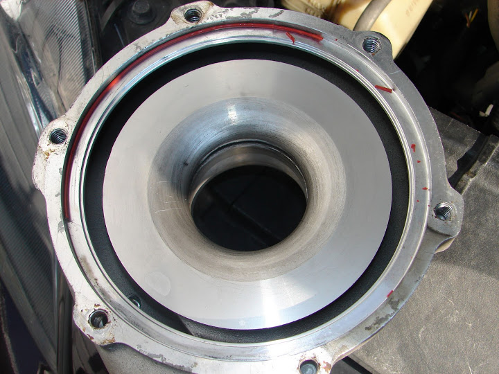

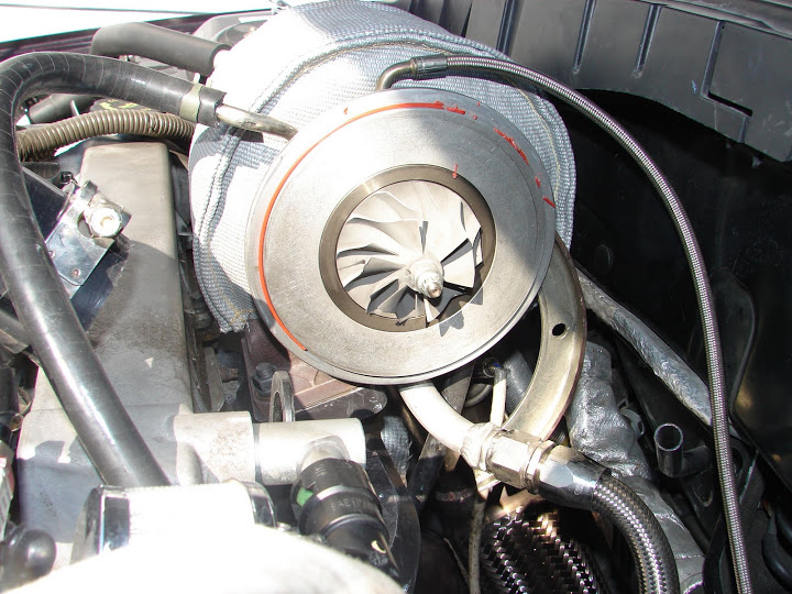

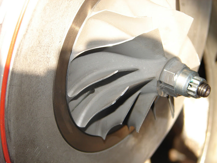

Just throwing this out there - was the compressor housing, the exhaust housing or the CHRA loose with respect to one another? With engine movement and all the tugging on the exhaust and intake side, if any of the housings were just a little loose they could have been pulled towards the spinning turbo and caused some damage.
For some reason this sounds the most reasonable to me.
Right before this happened like I said before I stopped at a gas station. While exiting I bottomed out really bad(really really bad) on my front bumper because the stupid angle was so steep. I wonder if the intercooler piping jostled the turbo enough to tweak it.
as far as metal being sucked in there is no way I dont think. None of the blades were chipped or broken just wore down.
Its ok though the wife is freaking out not me, she asked me how much a turbo cost I told here less than the driveway cost to get poured lol (2650)

Fine metal particles will probably pass through the motor without issue. It's the bigger chunks that can cause damage. Glad they're not chipped.
IC piping shouldn't jostle the turbo... cause there are silicone couplers that will eat up the slack. Not sure.... sucks nonetheless.

just got off the phone with FP, told me the turbo sounds like its a gonner not rebuildable.
However they told me they can reuse my housings and replace the center section if the inspection on them is good for about 1000 bucks.
For 400 more bones I can have a brand new TS GTX3076 <<<---- winner winner chicken dinner.
