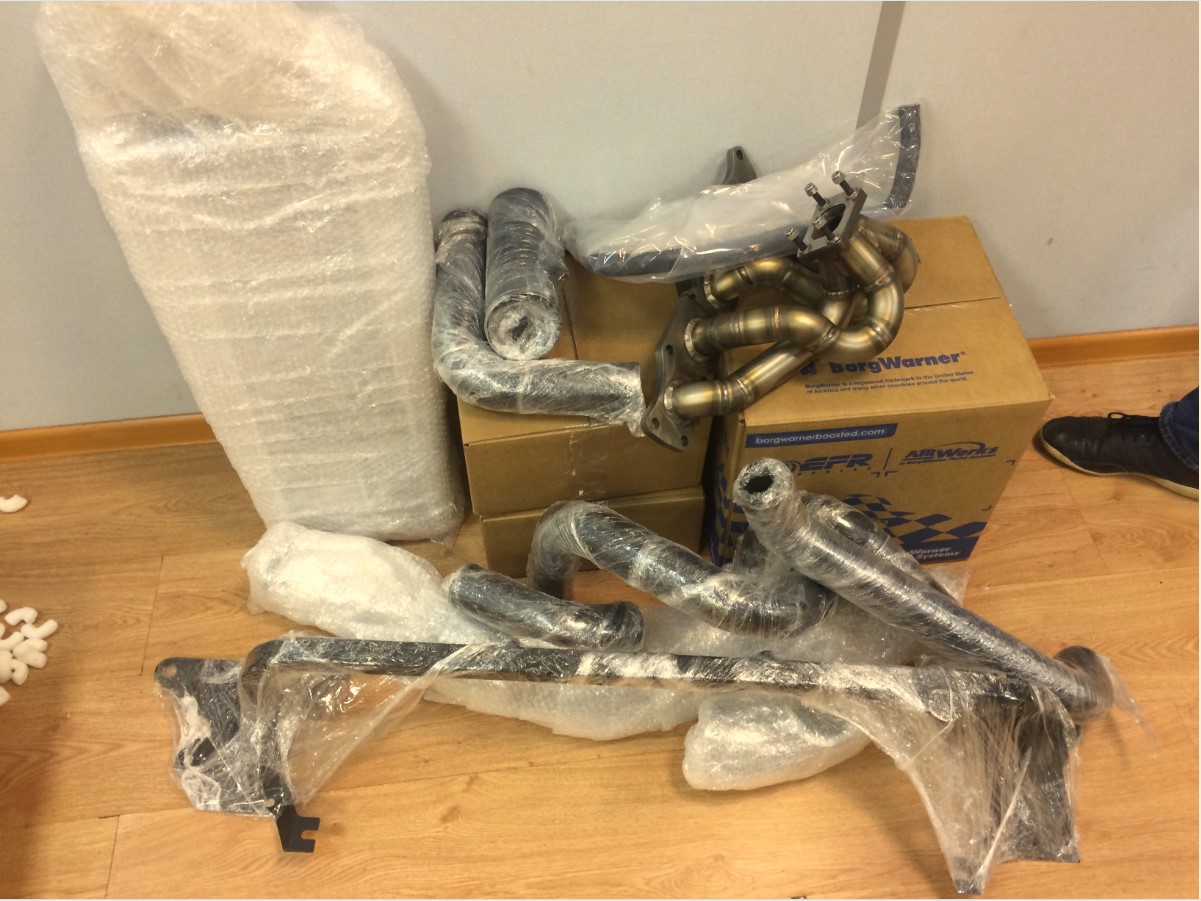

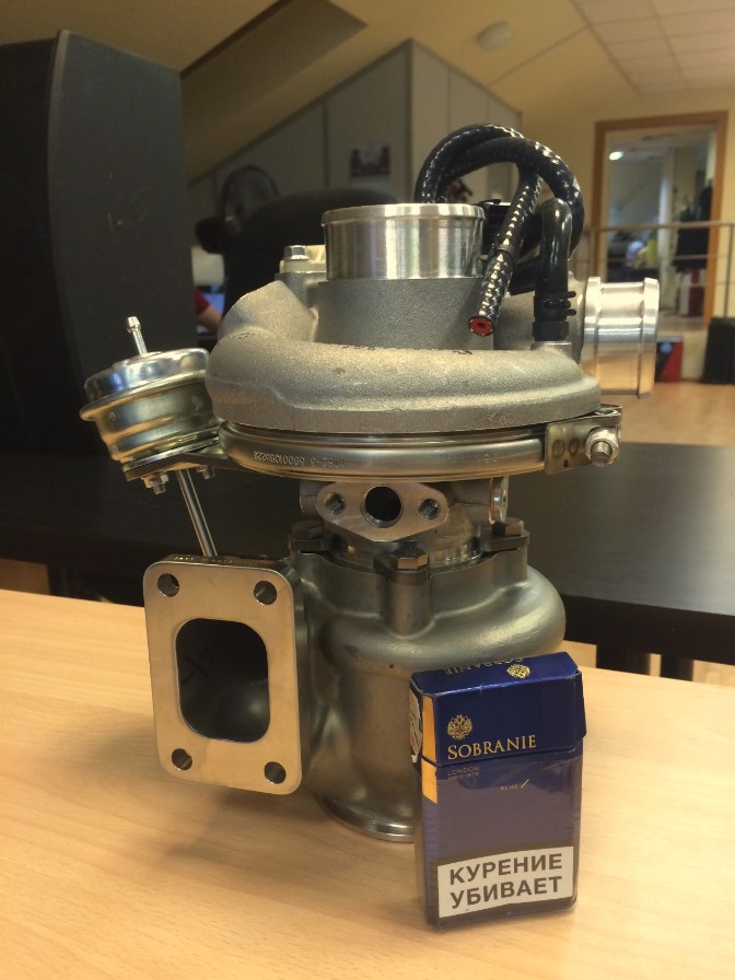

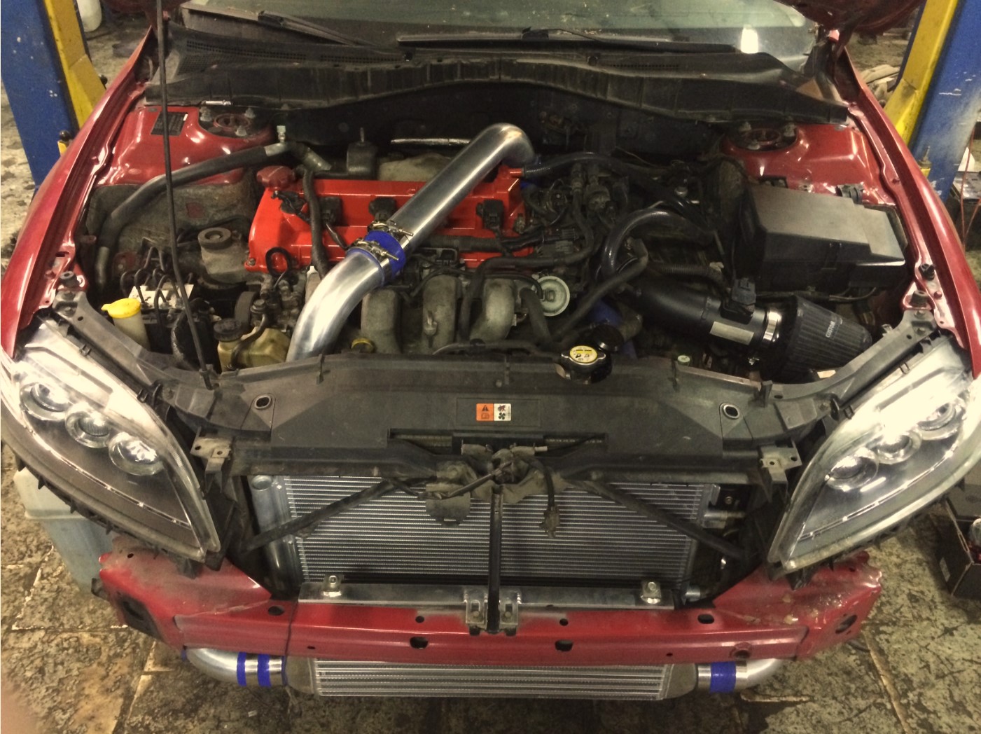

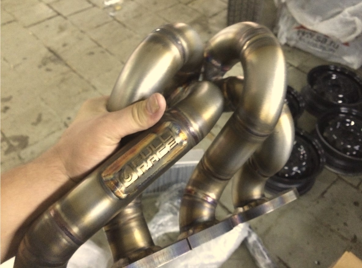

I would like to describe our experience with bolting and tuning EFR7163 ms6 "bolt-on" kit.
The car was not mine - one of my fellows in Moscow. I have even never seen it in real life, only on photos.
Car is true-red Mazda 6 MPS (aka MazdaSpeed6 for oztralia and europe).
Owner name is George, and he owns this car for quite a long time.
Mazda 6 MPS ?? EFR 7163 "????"

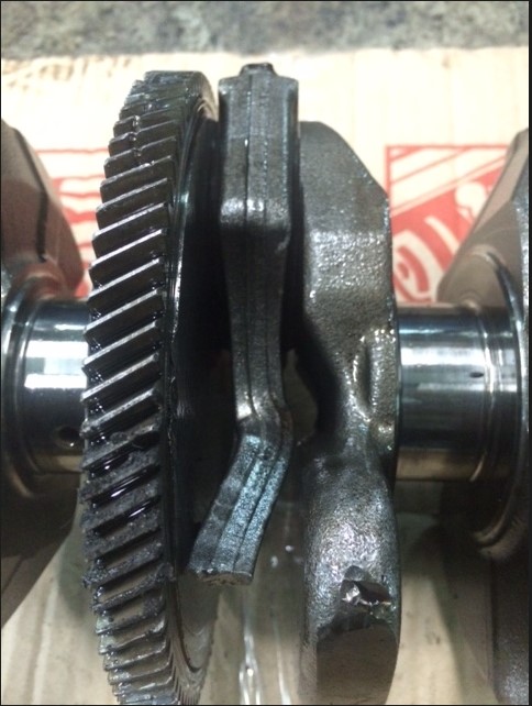

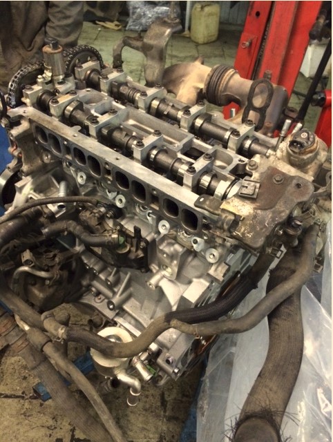

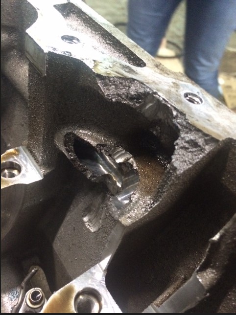

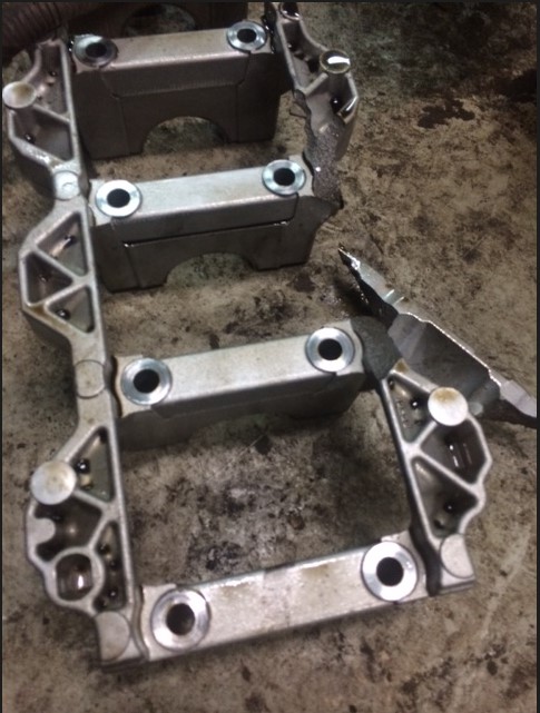

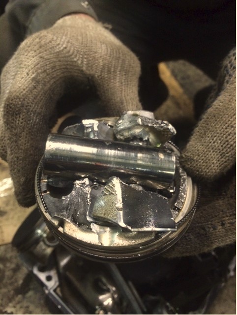

Funny began this winter with rod coming out of the block.

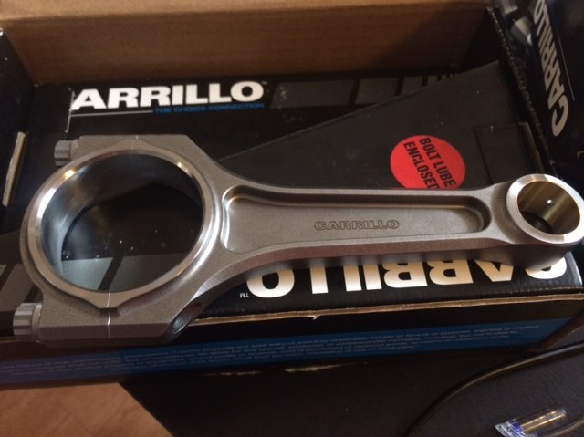

I had Carillos Pro-SA rods laying here with me, but with 22mm wrist pin. I bored and honed them for stock pistons, George got fresh short-block with Gen2 pistons, put carillos on and assembled.
George assembled motor on fresh short-block, carillo rods and stock pistons, put new chinese CHRA in the stock turbo, cpe injector seals, EGR was shut:
I was tuning him at summer on stock-turbo, but chinese CHRA after 3k miles started to blow oil as usual, and George decided to fix it completely... Digged here and there and ordered Full-Race EFR7163 kit. Wise guy!
Well concerning bolt-on... Instructions came were for MS3 Gen2, which is completely different. George was using @Alpha's build for reference purposes. Information about canister and which is pre-installed was just absent. Crank-case ventilation was not intended, and George welded it into inlet for proper operation.
Everybody has its own opinion, but me presonally, I prefer having vacuum in inlet under boost to suck vapors and free up excessive crank pressure, this is what is intended to and this is how I want it to work.

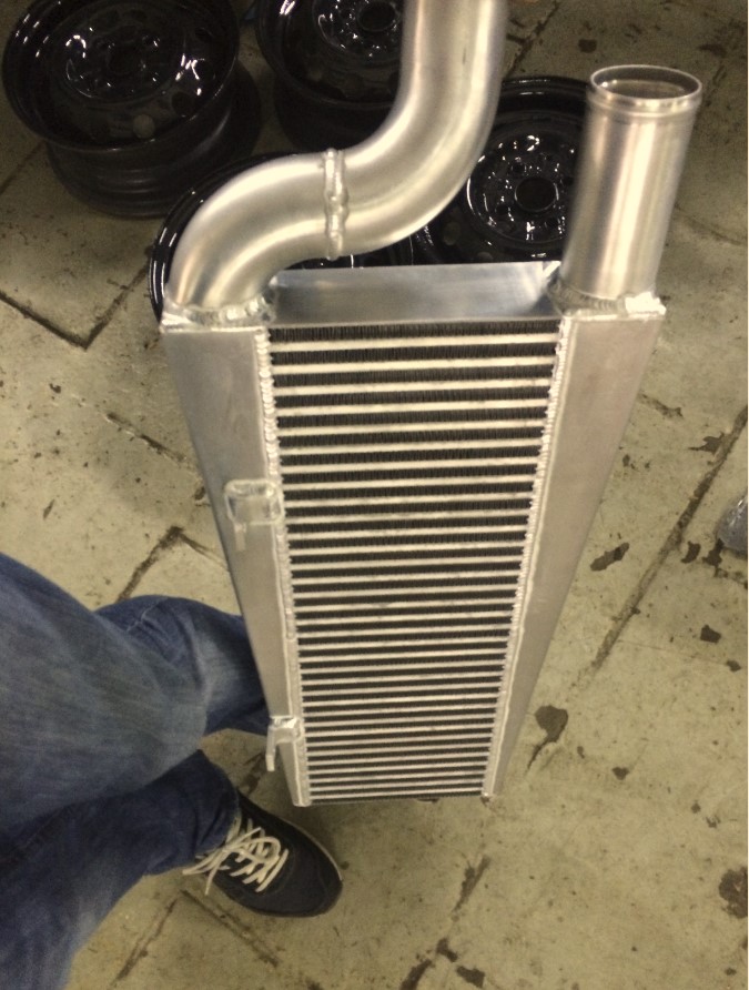

Turbo-inlet was absent at all. Guys fabricated it theirselves. They also atatched air-return from EBCS to have all air metered.
Intake pipe with MAF had no fastener and no PCV recirc (also to have all air metered and to relief PCV pressure under boost).
FMIC pipes had no fasteners at all, and George had to wled them on, to bolt them to engine where appropriate. Not having them for such a price is ridiculous from our point of view.
All in all, it was installed and now in the process of tuning. I am using VersaTuner and tuning George remotely.

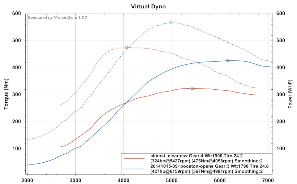

So far we are having slow spool (I guess because of not very proper wg preload) and strange knocks at 5000-6500 even with kiddy ignition, which could be VVT or inproper timing issue.

I have made timing even more kiddy in all the range (got 3 degrees from the table in higher ranges). 10 up-top, thats just disaster...
I did separate-segment maf calibration for it.
I left stock VVT values from 1.25 load up to 5500, and then zero.
And we have got much cleaner log, without huge knocks. Atrtaching the log and the graph also (comparing to previous knocky one).

There's still knock present, but it is significantly less. Only the spark plugs were changed for this result?

Not only.
Ignition was moved 2-3 degrees even less, spark plugs were changed, VVT was moved to stock. As I had 3 things which alters combustion, I am not sure which one was the main one. Oh, and I did very tricky maf_cal (splitting of several pieces of exponential trend-lines, damned excel, usually 1 power function covers the whole maf voltage range, here I had to use 3 different piece-wise functions)
But at least now we can start adding timing and see how it goes.
Does your MS3 start when it's -30C (-22F)?
Forged, bolted, tuned, gtx30/tial/ewg. Thanks.

Well the car is hitting higher timing than it was now, so that's good.
