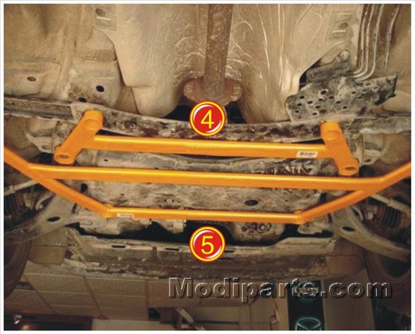

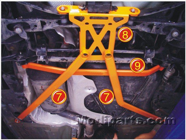

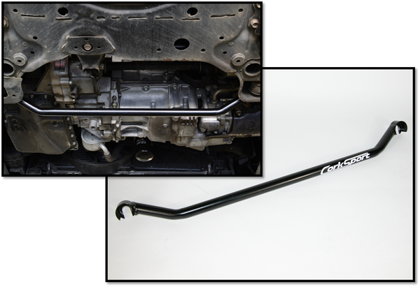

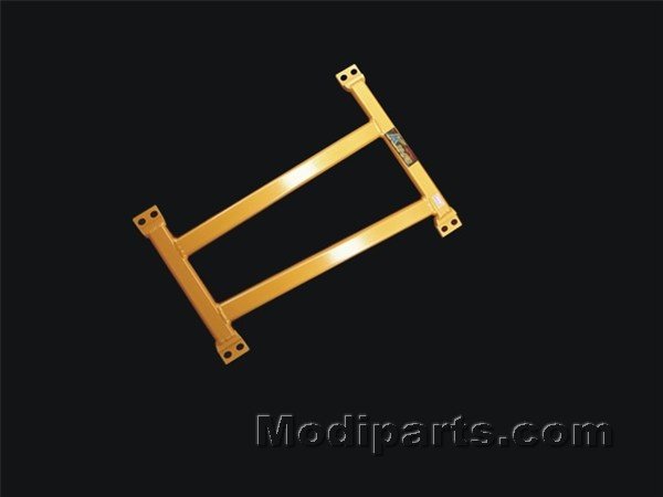

Now, because there aren't too many things to address or upgrade I have two goals for this spring:
1. get a revised tune from @Lex, the idea is to get improved/faster spool and eventually, if possible and it's still safe, to rev a little higher to make more use of the 3rd and 4th gears especially.
2. because the car has a respectable age and the chassis seems to have soften a bit we will put these on the car:
* Lower Control Arms from HardRace (they are on their way here):
* Corksport front LCA tie brace:
* and some braces from the Chinese manufacturer KF3:
The last two items are already on my balcony, the KF3 braces just came in earlier today:
Yeah, I know, they are yellow. But they are from China so what would you expect, to be green? They will be underneath the car anyway, but actually the finish is pretty nice, they came in with all the bolts. These ones don't seem to use rivets which I tend to like more, if I don't like one I can get it off of the car in no time.

How is the quality of those braces? I have a set coming in as well.
The quality is very good, they look so nice that my 3 years old daughter wanted to take one with her in the bed when I told her they are for my car.
I have no idea how the fitting is, but I remember that @Haltech tested these braces a while ago and wanted to organize a large group-buy, just that the deal was off because the guys from China were unable to find some reasonable transportation method to the US.
IIRC these guys designed and/or manufactured these braces for GT-Spec. So they are supposed to be the same braces only that they're painted with a bright slick yellow paint which is very nice to touch. I think I'll wax them before fitting them, they are that nice!
Today after looking better at the pictures the CS LCA tie brace may be incompatible with the large triangle brace. I don't know how I could not notice that and I don't know which one I'll install now, but probably the big yellow triangle bar since it added $50 more to the shipping costs

The front LCAs fir perfectly, I'll have to re-do the alignment though (I'll have to replace one of the ball joints anyway)).
The KF3 bars on the other hand... epic FAIL.
These parts have serious fitment issues. Basically I could put on the car only the bars from the picture below:
...which I did not because I didn't want to make only the front end stiffer.
Part #9 from the picture below hits the fuel tank:
and part #8 will not sit correctly because of a lip on the rear suspension arms (most importantly) and also the surface is too slick which will allow those rear arm bolts to rotate too easy which will affect the rear suspension alignment.
Obviously because I could not fit correctly part #8 those bars labeled as #7 could not be fitted either.
The middle lower chassis X brace didn't fit either, the holes for the bolts were about 3-4mm off.
So right now these bars for me are $420 thrown in the trash can... I should have bought a meth kit instead.
Ok, so I attempted to fit the front braces and they didn't fit either. The holes were off a few mm. We were able to bolt them in 3 bolts and the 4th was always off.
My car has never been hit in any possible way, it actually has 100% original paint on it.
