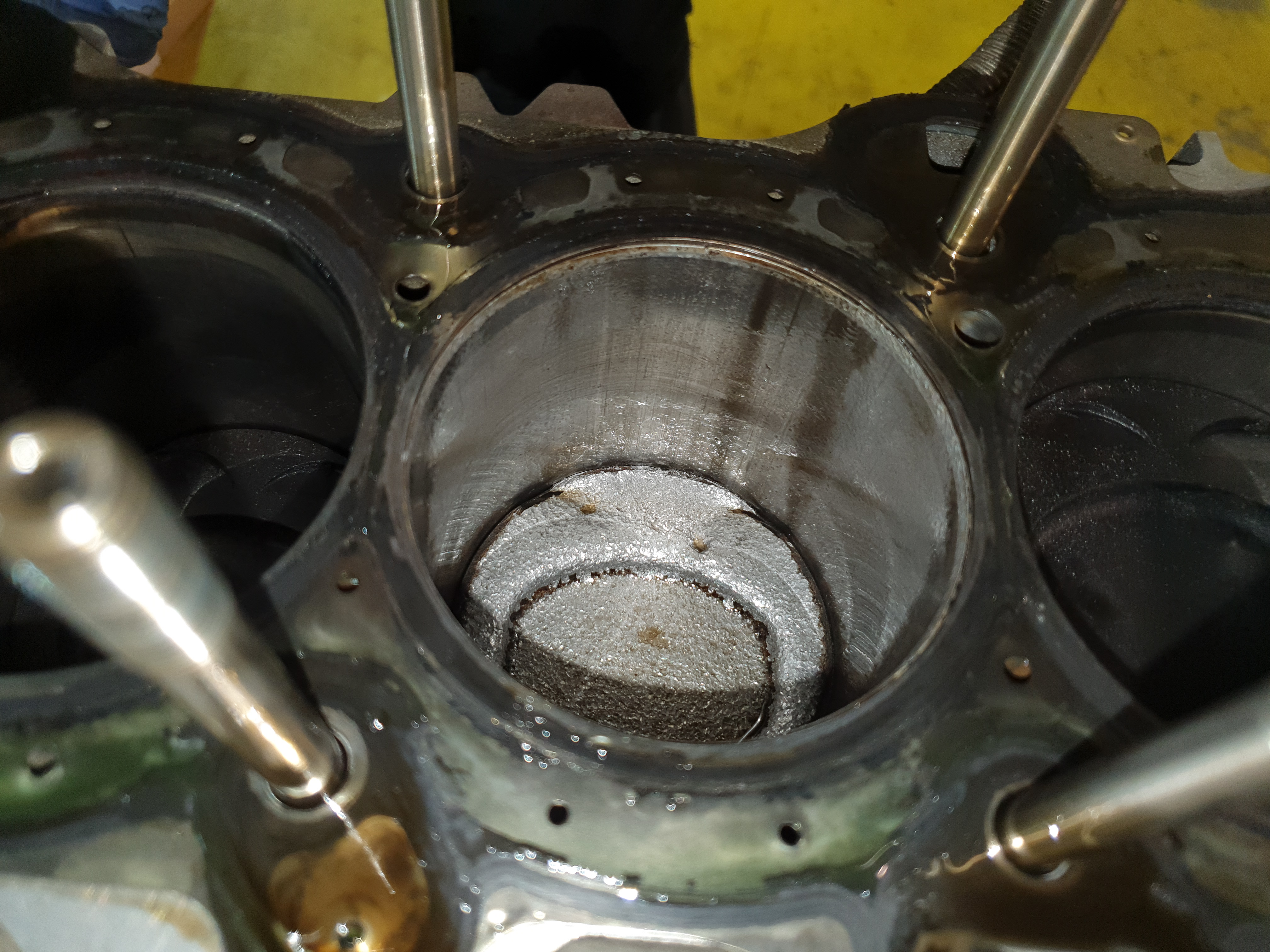

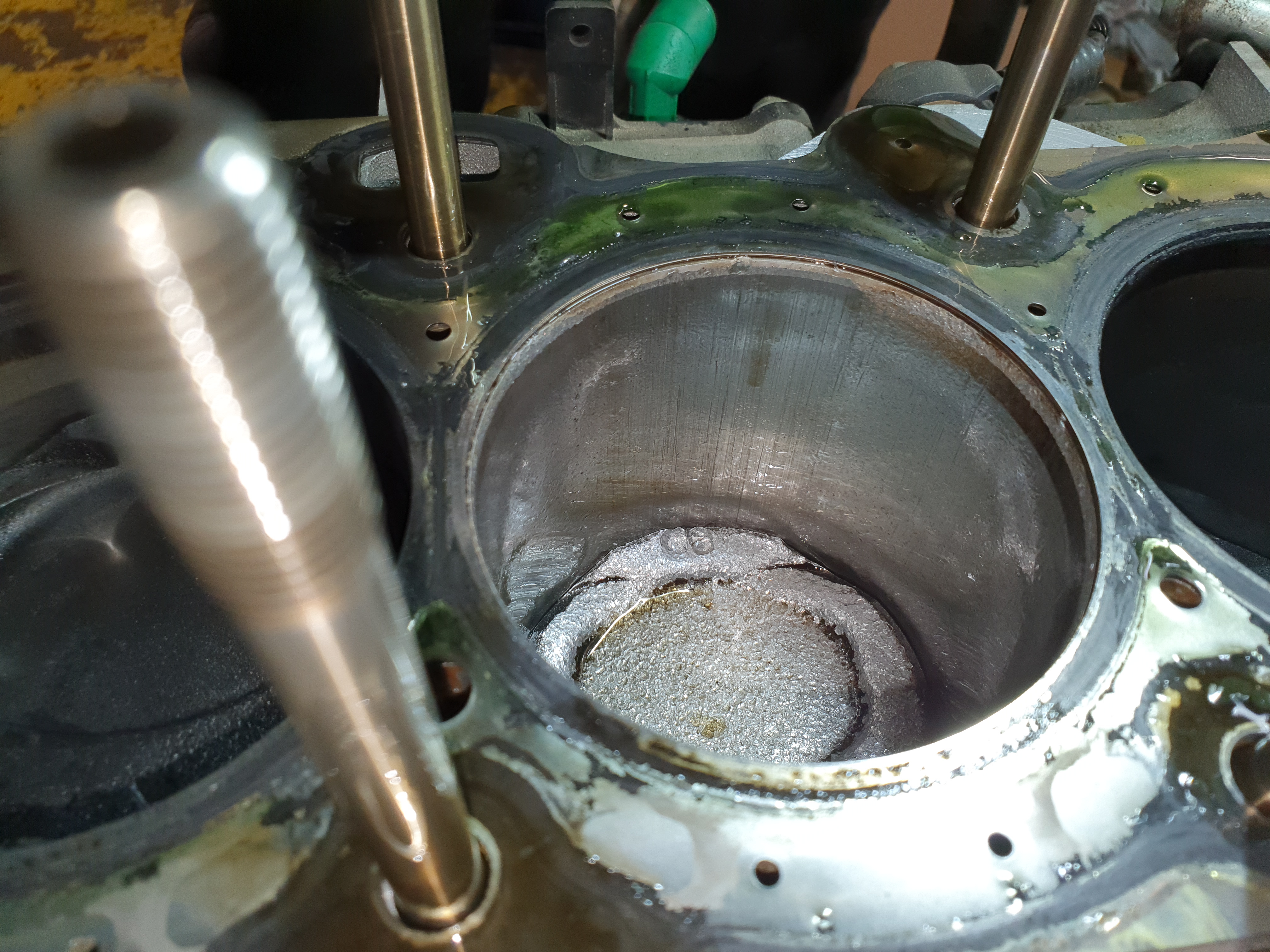

Ok, so the turbo play is axial, not radial. This is the sound it makes when pushing the shaft back and forward:
https://www.youtube.com/watch?v=6jfFdbwDqkI
I will probably leave it in the engine and let it eat the steel dust resulted from the break-in - if there will be any.
The engine is totally apart now. the fresh oil in the turbo housing was from the valve cover breather hose. Maybe the low compression on cyl 2 and 3 was increasing the pressure in the crank case and that was leading to an overall oil pressure increase making the fresh oil form the cam housing to be pushed back into the intake?
Cylinder #2 and #3 had some hair thread cracks on them. Maybe the one in #3 was slightly larger and because of that the top of the cylinder wall had a soot stain in that area.
Otherwise the engine is absolutely and immaculately clean, if it didn't have any oil in it one can get heart surgery in there with 0 risk of contamination.
The SPEC disk and pressure plate are 50% worn. Thinking to replace them if I will have the other clutch reworked soon enough.

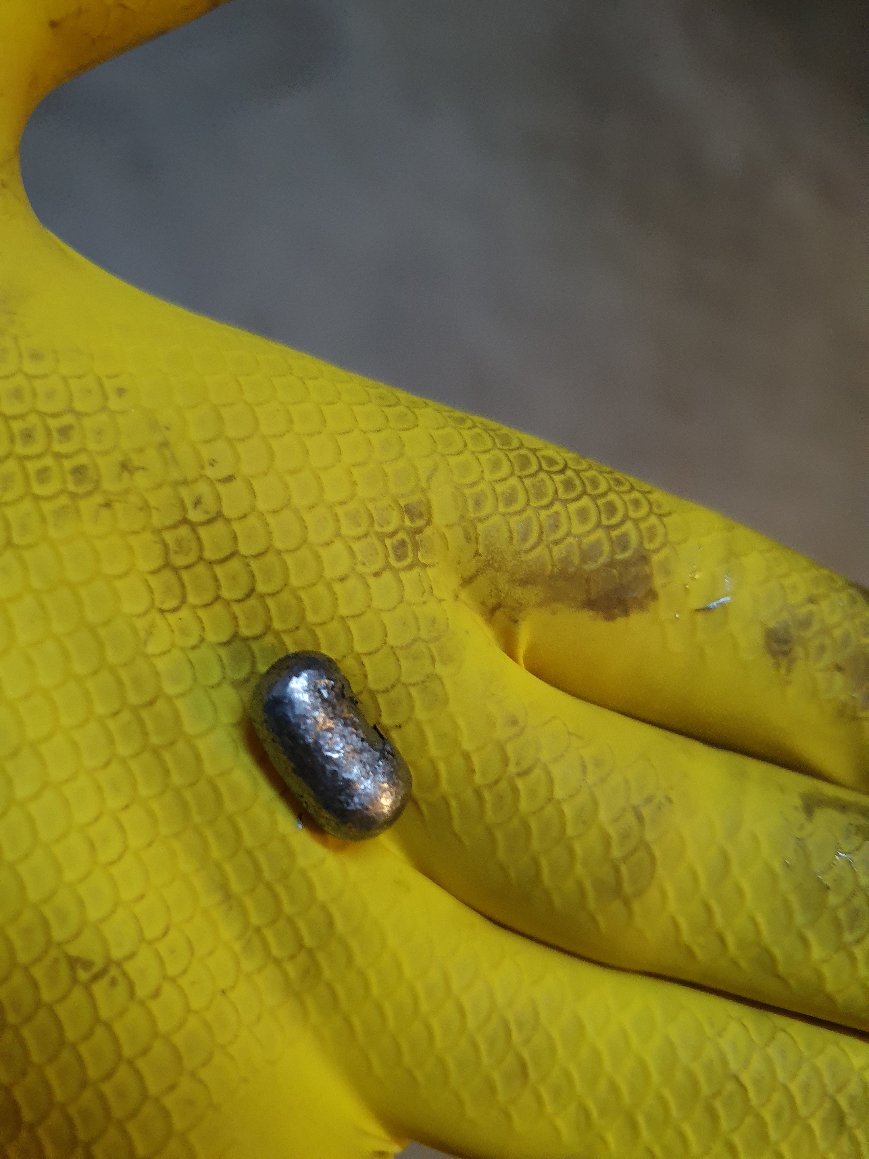

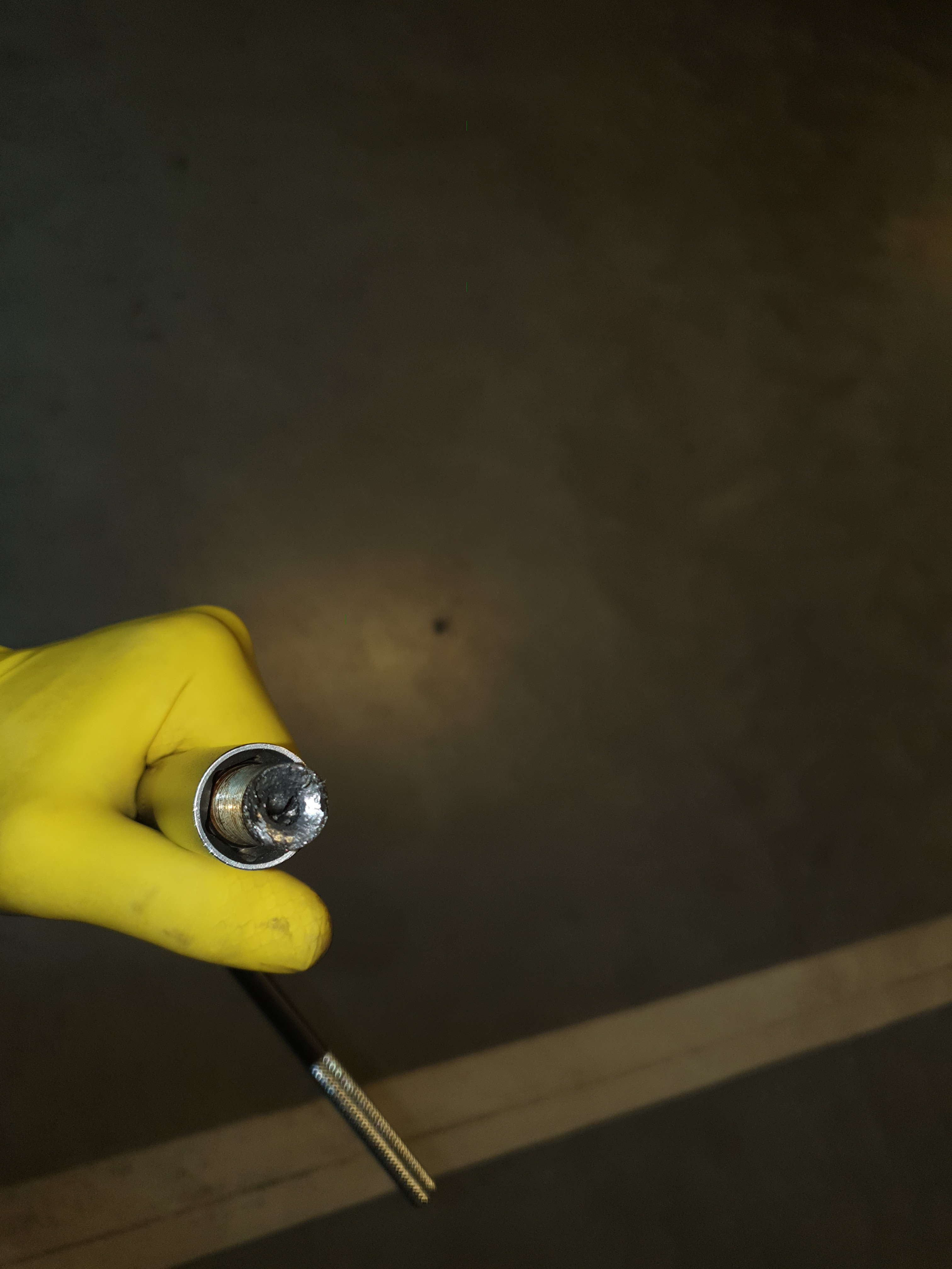

That moment when you think your car is on meth but it's actually sniffing metal bungs:
https://forum.clubmazda.ro/uploads/m...4d413cd709.jpg
https://forum.clubmazda.ro/uploads/m...2acb3dcda0.jpg
https://forum.clubmazda.ro/uploads/m...cdc9affc59.jpg
https://forum.clubmazda.ro/uploads/m...b1bf7077ab.jpg
https://forum.clubmazda.ro/uploads/m...731757c0b8.jpg
