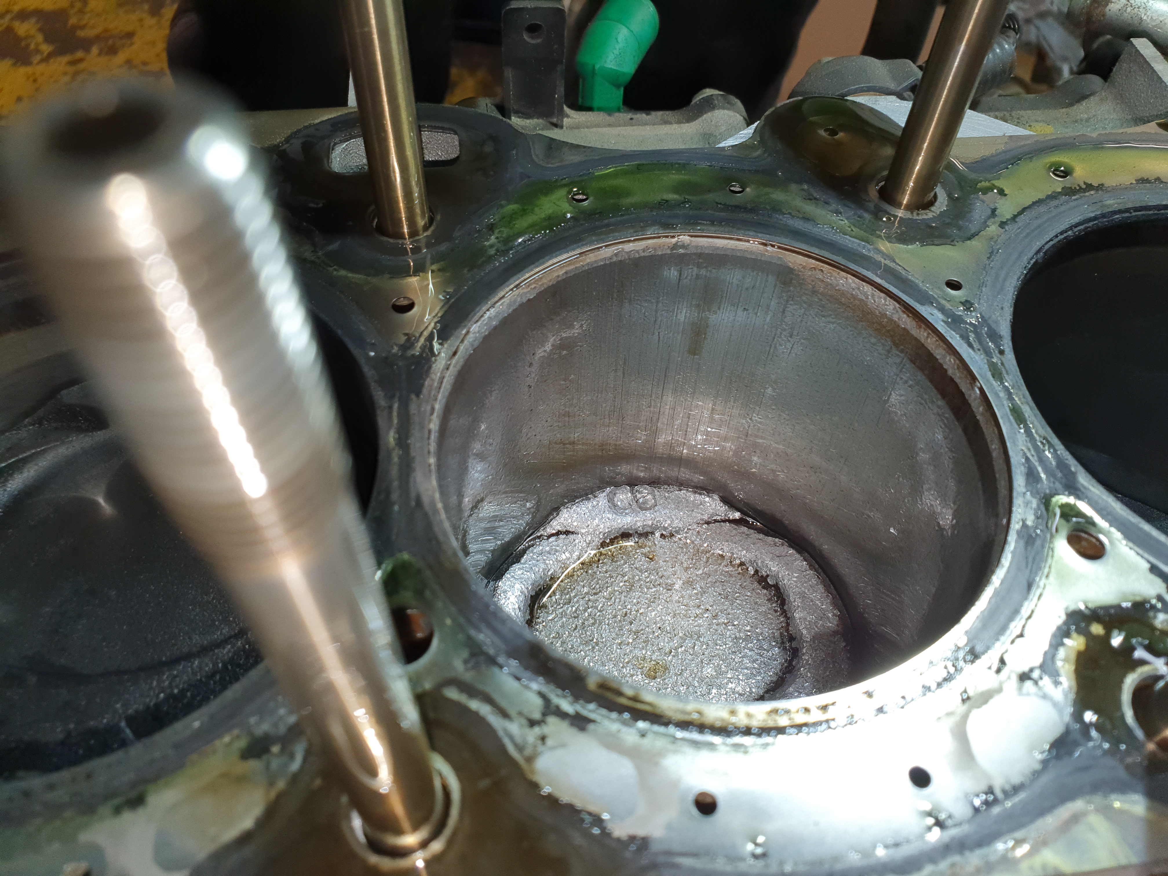

That moment when you think your car is on meth but it's actually sniffing metal bungs:

WHAT THE FRICK did you do?!!

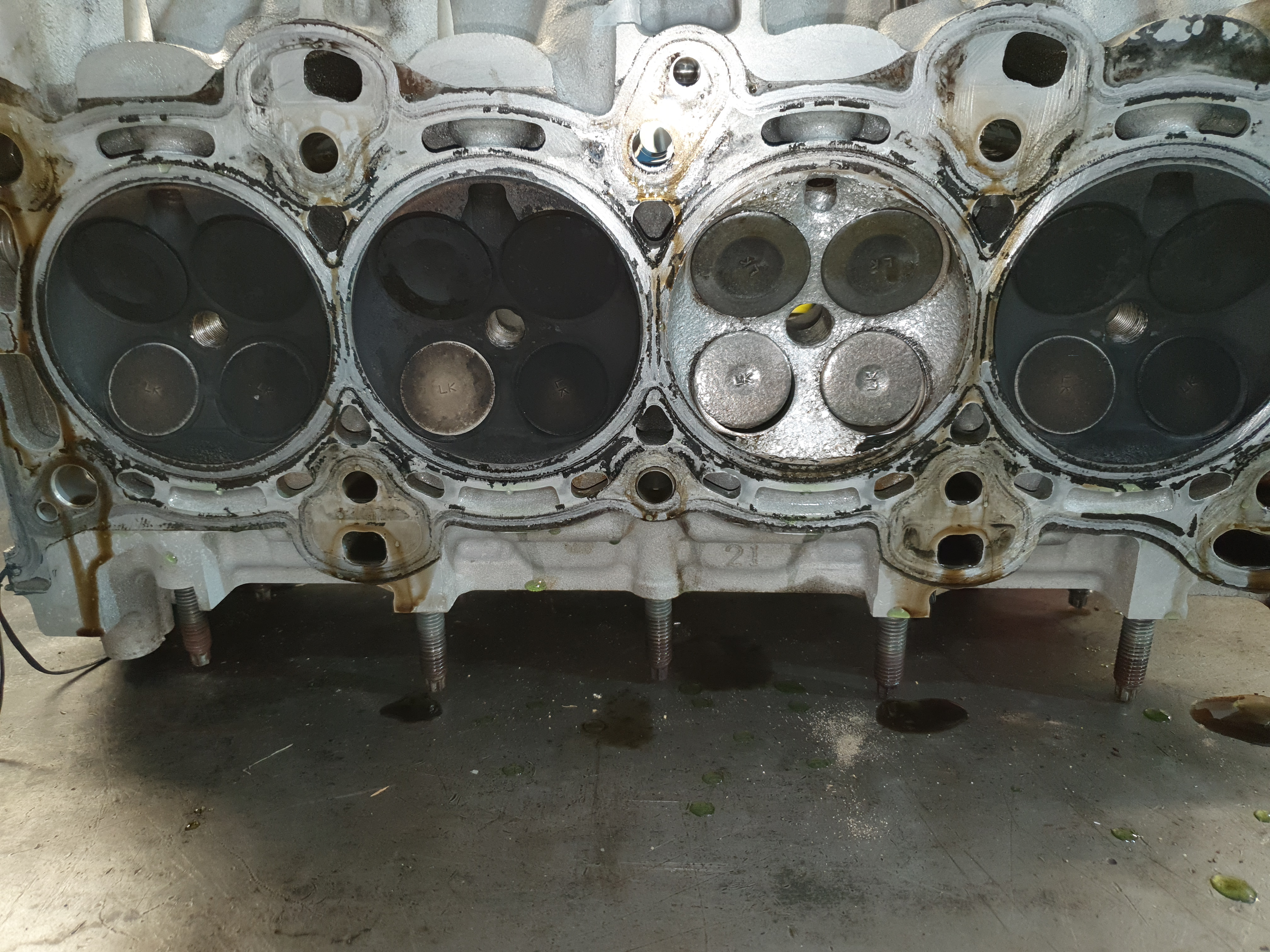

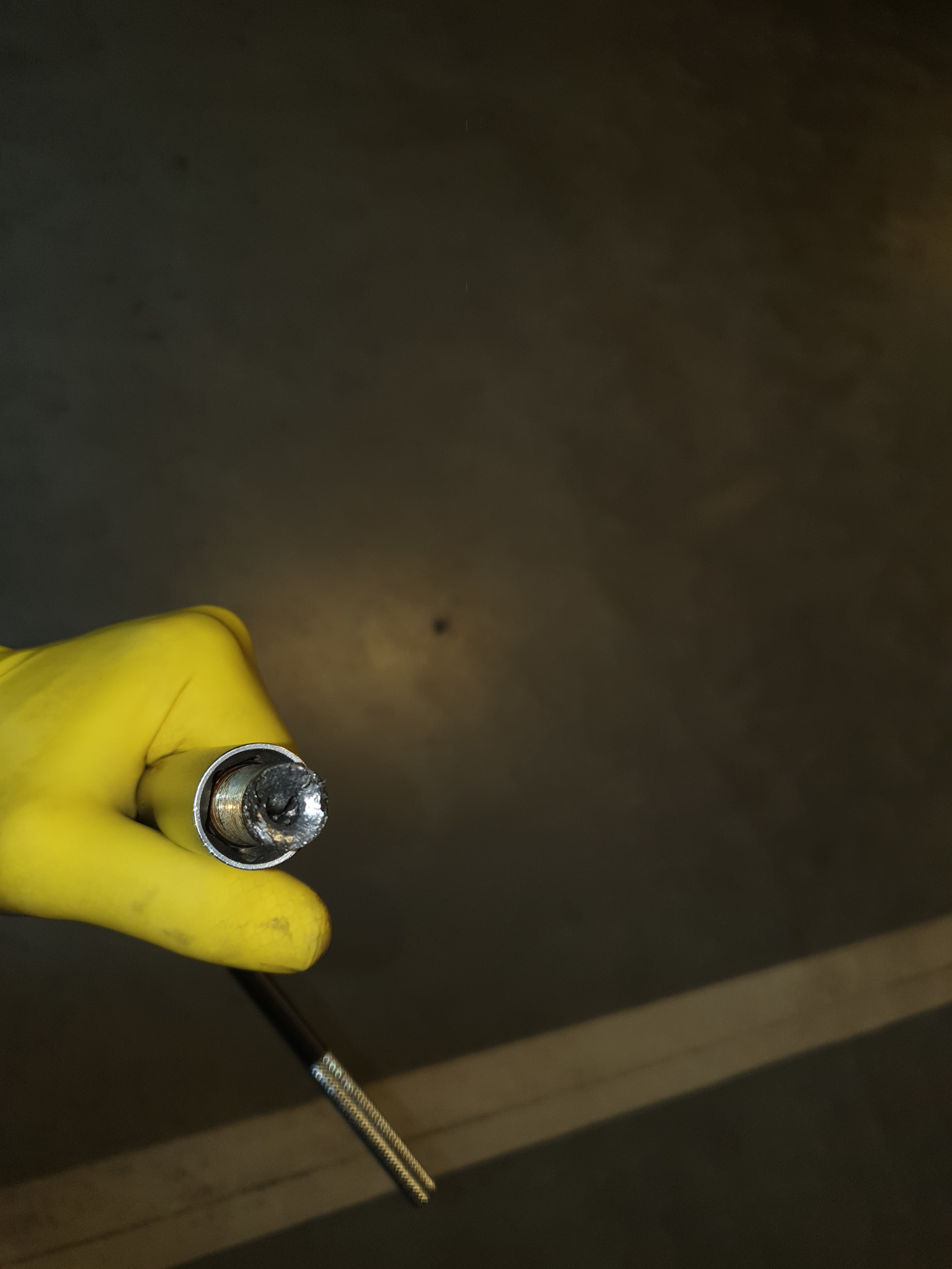

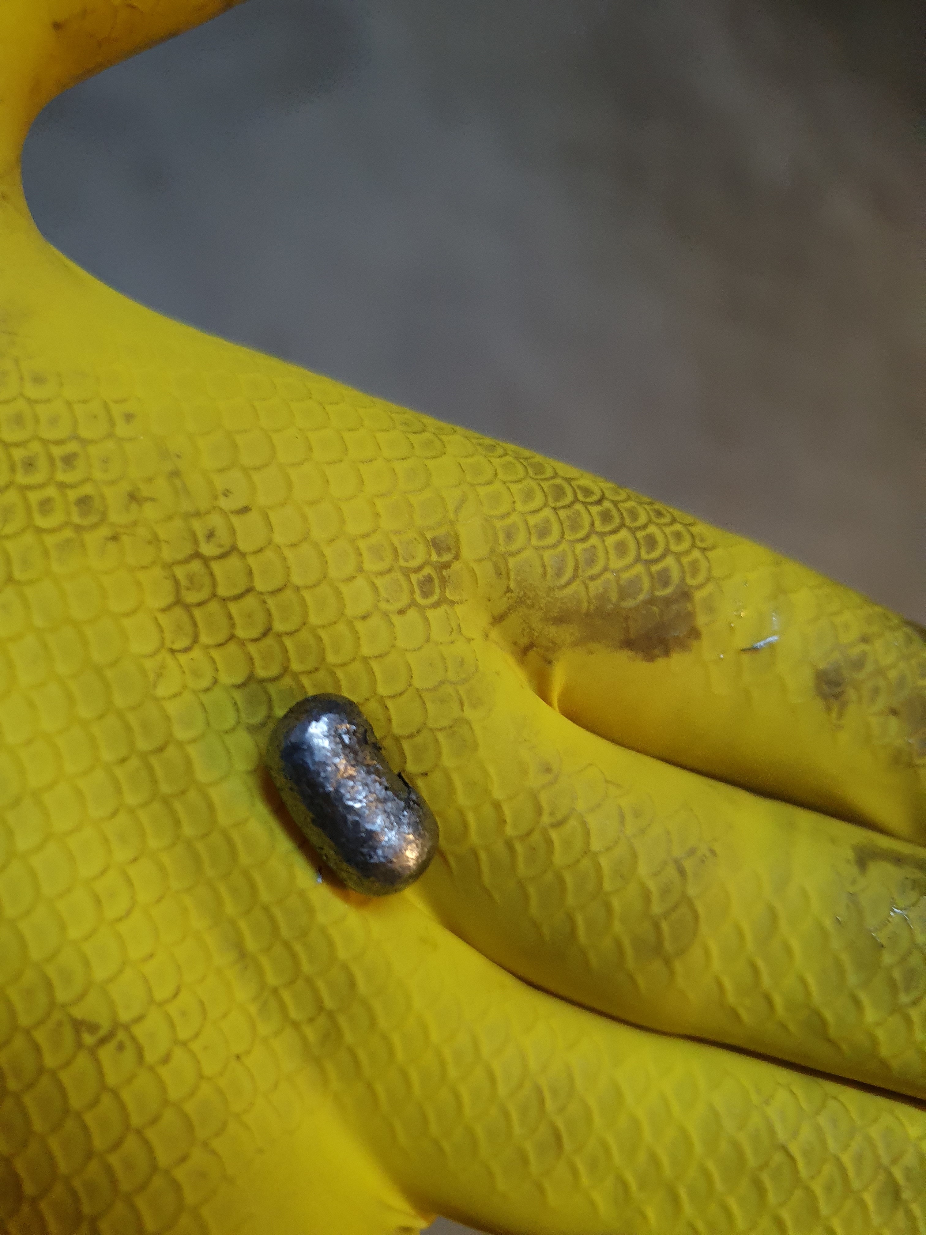

I asked my fabricator if we can cap the holes between the intake manifold runners after removing the VTCS shaft. He said he can, provided a solution I agreed with.
One year later those studs were rattled out and started to come loose. The first one that got out, a 2.5cm/1" stud, went into cylinder 3 when I was WOT at 6000rpm. At that moment I did not know WTF happened, I thought I popped a hose or something, so after pulling the car on the side of the road and managed to start it again I drove back home 25kms/15 miles (slowly, not exceeding 2500rpm, as the car wasn't really pulling), with a check engine light because missfire on cylinder 3.
I went back to the rented parking and started to work on the car. Because of the hit that spark plug took the electrode side was shattered so the thread on the head was fucked as well. When unscrewing the plug and figuring that it turned way too hard and way too many times than it should have was the time I dropped a smidge of piss in my pants.
When I pulled the spark plug I managed to also drop a smidge of shit in my panties, and while holding the spark plug in my left hand my right arm suddenly became numb and I hit myself in the nuts while still having the wrench in my hand.
When I stuck a magnet inside #3 and heard that "Click!!" sound a thick metal bung sticks to it I figured that my engine just got its holy fuck this year.
The fabricator used studs like this to cap those VTCS shaft holes. These were threaded in and then sealed with tin I guess.
The exhaust valves are bent but they did an amazing job at shattering that metal and not letting it by to the turbo and cats.
I will try to recover the block which may be fine after boring it at 0.5mm over to 88. The cams, caps and everything else in that area is good, so may be the bearings, rods, griddle and crankshaft. The iron of the head is royally fucked.
So a rebuild is already being done. I have a new GTX3071R gen2 and CorkSport cams, which is what's going to be different from the previous build. So we will make the power and 60-100mph record holder on stock manifolds and full emissions compliance (EGR, double-catted exhaust, and so on) even stronger and will try to surpass the current figures (476WHP/509PS at the crank, 3.62s for 60-100mph).
I have no idea what's going to fail next, I suppose the cats or something on the exhaust side.

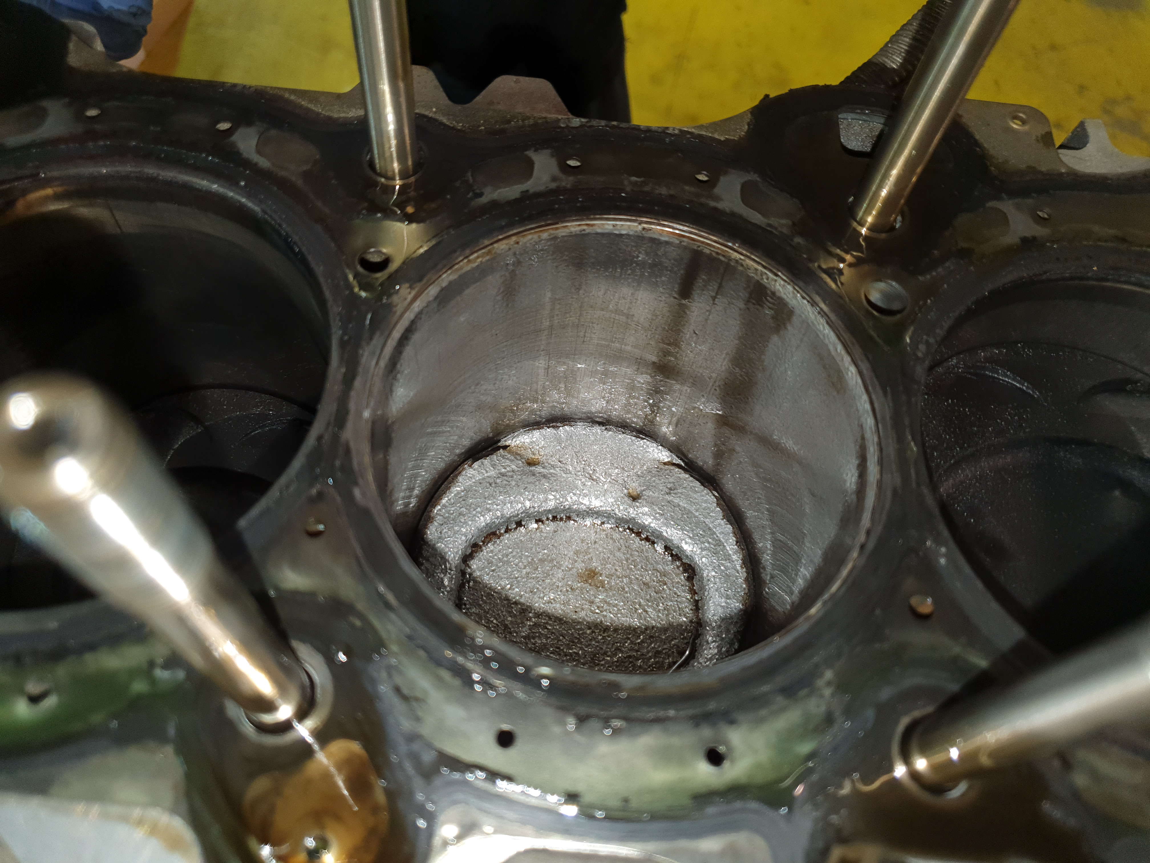

Pulled the pistons today. I was more interested in the one that took the hits.

Yep. I figured broken ringlands was the problem.
That piston (and head) took a beating getting you home. But it got you home. Winning.

4032 ? It lasted quite well, it could have been worst if the piston exploded and let the rod break the bloc....Was the bearing damaged ?
Yes, Mahle 4032.
The rod is untouched, the bearings are clean, the engine builder decided to reuse the crank for the new motor even though I had a spare one which was also within the factory specs.

So sorry. I’ve been following your posts and learning from your experience for years. Glad it wasn’t worse and that the bottom end other than pistons and bore are good and can be reused. I hope the cylinders clear up with the bore to 88mm. Probably not enough room to sleeve it.
Jeff’s story reminded me of an experience I had with my first car at age 16. It was a Fiat 1100 sedan. Freshly rebuilt engine. Driving home from school the tires locked up, just like the diff was frozen. Turned out it had sucked in a nut from the air filter housing that had not been installed with a lock washer. The nut stuck between the piston and cylinder head combustion chamber. When we pulled the head, the top of the piston had a neat hexagonal imprint of the nut. We removed the nut, saw no other damage, no bent valves, put it back together and it ran like a champ. The little engine, even freshly rebuilt, just didn’t make enough power to hurt itself. Not unlike Jeff’s lawn mower. I sort of had a four door lawn mower, anyway. I believe the engine made about 40 bhp.
Keep us posted on the rebuild. I hope the fabricator that failed to retrieve that piece of metal steps up and helps you. Probably a good guy who just made a mistake. But actions have consequences.

It was a fun day:
...especially when the engine stalled the moment I stepped on the clutch for more than one second to pull over. That's when I knew I fucked up.
