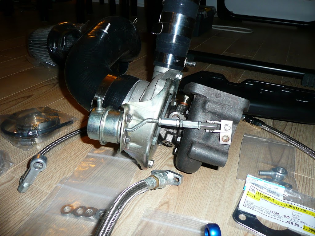

Nice stuff , you got any pics?

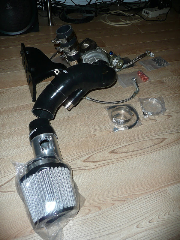

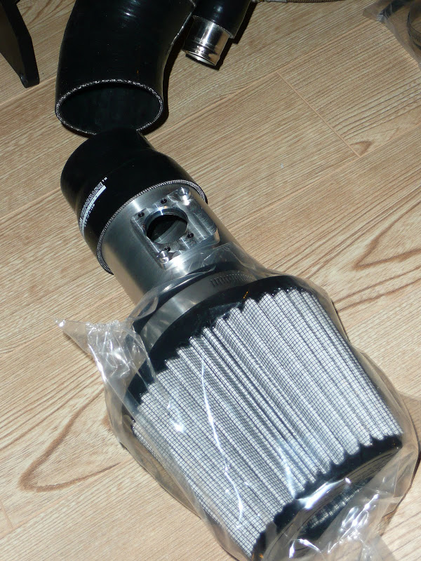

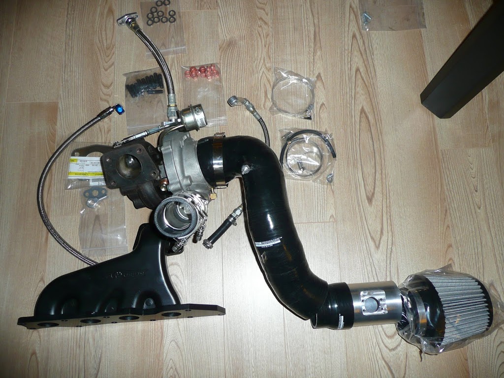

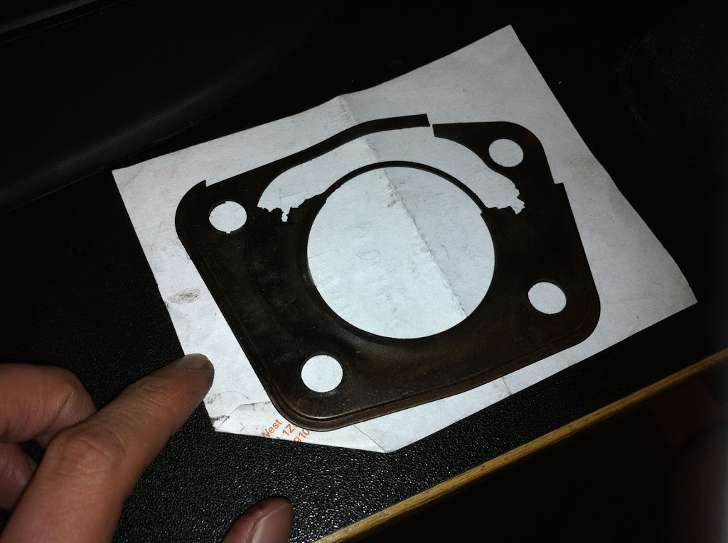

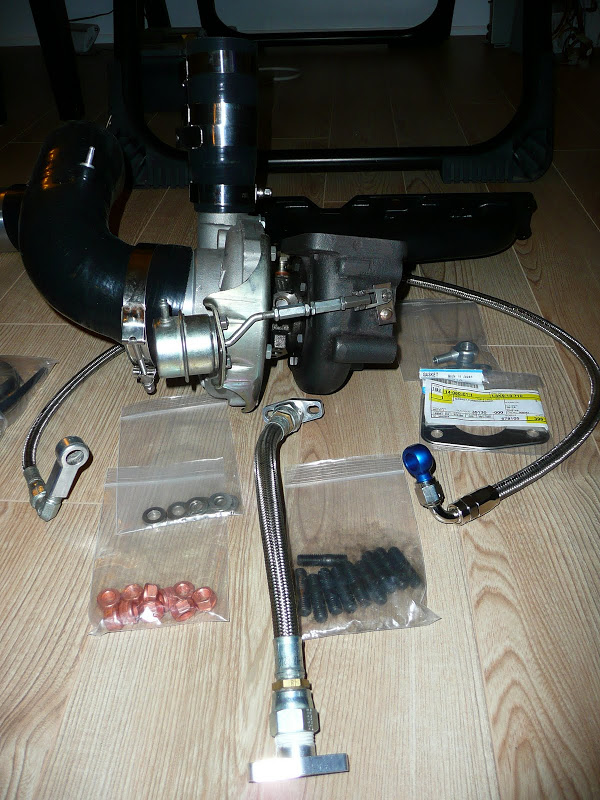

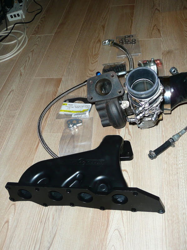

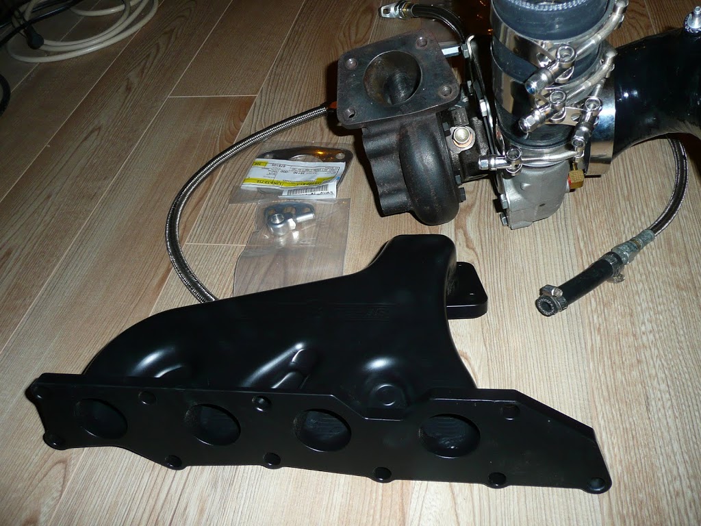

These are the only pics I've got of the parts...engine bay looks like everyone else's, except mine's kinda a mess...lol...not too proud of it, but I'll snap some this wknd.
And this is the reason why I started this to begin with...blown gasket...after over 300 logs, over 100 map revisions...about 90,000km of track, hwy, stop and go city traffic...
A pic of the car on track with a rich base tune...

Love, it . The flaming ass pic is great all my rx-7's did that. Good luck with everything I know u said your still dialing it in.

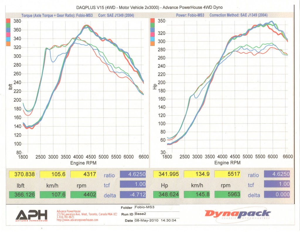

Originally Posted by opt_ms3 View Post
The club I ran with for the first time at NHMS (COMSCC), did Mosport as their first event of this year. hopefully I can make it if they run it again next year.
let me know if you make it up and I will try and join you guys. Must be a bunch of dedicated track dogs to make it all this way up north...would love to run with you guys.

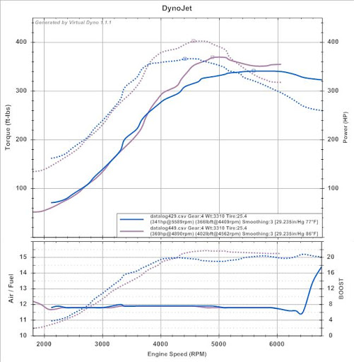

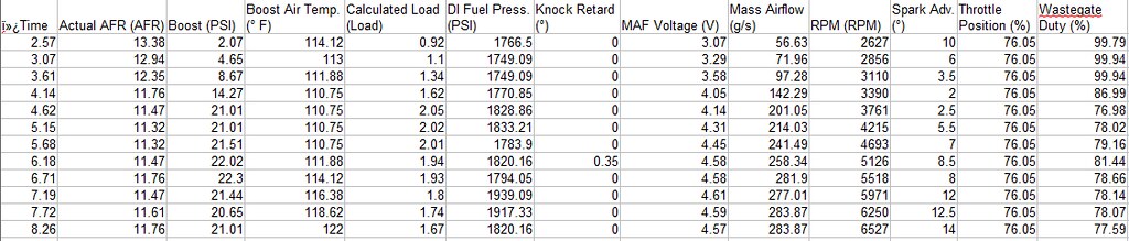

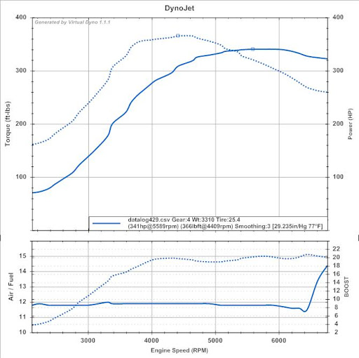

I wanted to post pics of these logs but with the new higher resolution from the AP, they look stupid. But here they are attached...logs from 2 dyno pulls today.
Flow is on the low side - you should be well over 300 g/s to really say it's above and beyond a K04. Strange that the flow is that low on 21 psi. Looking at load as well - its very close to a maxed out K04 - something is off there.

for what its worth i hit 275 g/s on the K04 @ 20psi and hit 29X whp

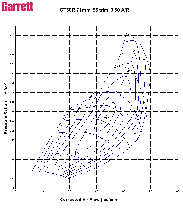

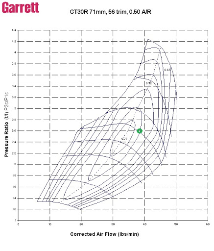

so here's something I learned from Lex and cld12pk, which I'l lattempt to apply here to start on really tuning this thing for myself.
^ It's simple - the y axis is absolute pressure (ie at sea level atmospheric pressure = 1 bar) and the x axis is the compressor flow.
The islands define compressor efficiency - so you know that when you're flowing x amount at y pressure, you are z efficient. Flow is in lb/min but you can convert it easily to g/s:
Pound Per Minute [lb/min] To Gram Per Second [g/s] Converter
Remember that this is only the cold side of the turbo.
Here is an example of the key elements on the compressor map:
To further refine upon what Lex said:
The y-axis is the absolute pressure ratio between the outlet of the compressor and the inlet of the compressor.
So to get this you need to know the pressure drop in the intake to the turbo inlet. Most of the time I see this modeled with ~0.5 PSI when free flowing aftermarket intakes are used.
So the inlet pressure is assumed to be 14.7 PSIa - 0.5 PSIa = 14.2 PSIa.
You also have to add the pressure drop through the intercooler for the discharge pressure so you really cannot use manifold boost pressure. Assuming 1 PSIa for fairly free flowing IC yields the following at the turbo discharge for 23 PSI boost gauge pressure:
23 +14.7 + 1 = 38.7 PSIa
The compressor's pressure ratio is then 38.7/14.2 = 2.72.
Garrett has some pretty good turbo tech info here if you want all the math:
TurboByGarrett.com - Turbo Tech103
so I will try to apply this to the GT3071R...
I'm running about 21.5psi on the log...pulling about 288 g/s logged...
21.5 + 14.7 + 1 = 37.2
37.2 / 14.2 = 2.61
288 g/s = 38lb/min
If I push this up to 24 psi...
24 + 14.7 + 1 = 39.7
39.7/14.2 = 2.80
...I'd still have lots of room to play with...so yeah, something's off...
-- Mario Andretti --

Sorry I didn't get back to your PM ... I was trying to sort this out a bit in my head. The motor is an air pump. You have to efficiently pull air in as well as pump it out.
You can be at the same pressure ratio and have different flows depending on the motor's ability to flow air. We know that our motors should flow more air using this turbo at that boost level.
Given that the MAF is calibrated correctly, I would be looking at a restriction in the intake or exhaust.
Looking at cruizto's dyno, he's at 22-23 psi and makes ~370 g/s at ~430whp. So your 290g/s would calculate to 290/370*430 ~ 337whp which lines up with your dyno.
Nothing to scoff at but it seems that the motor should flow better at that boost level with this turbo. Any more 3071 logs at the same boost level you can compare with?

Here's mine. We're kind've in the same boat. I'm hesitant to post a tuning thread until I get everything sorted out.
The car pulls substantially harder than when running the K04 but like Fobio said, g/s is g/s. More flow should be had.
Also, I need to tighten up my WGA to get it to spool quicker. I've been in the engine bay so many times over the last 2 weeks that I'm going to just drive the damn thing for a while before I get my hands dirty again.
EDIT: Meth was turned on, hence the screwy AFRs. It's direct port so (measured) BATs aren't affected.

I'm able to hit 297 g/s today...also flipped the switch over to boost tune and it feels smooth, while requiring some tweaking to my wgdc table. This is what I'm currently running as the WGD - BEC table:
Code:
0.05	0.05	0.05	0.05	0.03	0.00	-0.05	-0.24	-0.40	-0.40	-0.40
Basically, this uses the BEC table to add 3% when it's under boosting by 1psi, to the WGDC table. The goal is to shoot for within 1psi of your target thru wgdc tuning and then allow this table to make minute adjustments to achieve a smooth boost curve.
Whereas my load tune got stuck around 2.02 calc load, the boost tune map immediately got me up to 2.20 calc load...the current boost tune spikes to 23psi and holds ~22.4 psi thru 6500rpm...
We're now throwing around the possibility that:
a) the steed mani flows less...the 3 locals stuck around 290g/s all run steed's stock mount mani w/ the 3071...hmmm...
b) we all have dirty valvetrain and should clean the intake tract along with valves...

I have quite a bit of info to share...
First, here's Christian's reply to my question about g/s...
You also need to think about your MAF calibration. With higher quality fuel, the MAF calibration is lowered. For instance, if you put C16 in the tank, you would then need to lower the MAF calibration to lean the car out. By doing so your g/sec value will be less, yet the car will likely be making more power. Make sense?
The way I read it now, is that g/s IS NOT just g/s...once it's scaled, it's just a number, and it's the CURVE that mimics the hp curve. Also, he told me that it's likely due to dirty valves...I'll look into it.
Second, I started to plot my progress on Virtual Dyno...since g/s can no longer be used to compare runs as I hoped...here's my first street log after my baseline dyno sheet:
Looks to be comparable to what the dyno stated. So I'll continue to use this baseline to compare to my future logs.
So...take away:
1. Not gonna blame parts, such as Steed's mani since others have done well by it.
2. Need to clean valves.
3. g/s is not g/s once MAF is scaled.
4. Using Virtual Dyno, which doesn't take into account for g/s or MAF V is a good way to measure differences made.

So here's after a bit of tweaking...I plan to get on the dyno again in a few more weeks.

tuning is so adictive...I'll likely settle on the output of the green lines, and claim a easy 360whp/390wtrq... the map that netted 400+wtrq gets a bit of 1.8 - 2.1 WOT knock intermittently.
