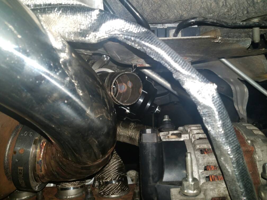

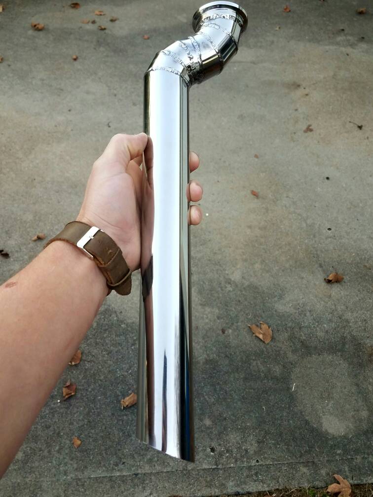

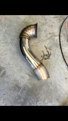

Just a little more dp love.
Sent from my SAMSUNG-SM-J320A using Tapatalk

 Old 09-11-2016, 08:50 PM   #6
davychronic's Avatar
Join Date: Feb 2015
Location: Palmer, Iowa
Posts: 1,155   (View Stats)
davychronic is the leader of the worlddavychronic is the leader of the worlddavychronic is the leader of the worlddavychronic is the leader of the worlddavychronic is the leader of the worlddavychronic is the leader of the worlddavychronic is the leader of the worlddavychronic is the leader of the worlddavychronic is the leader of the worlddavychronic is the leader of the worlddavychronic is the leader of the world
Thanks: 152
Thanked 320 Times in 184 Posts

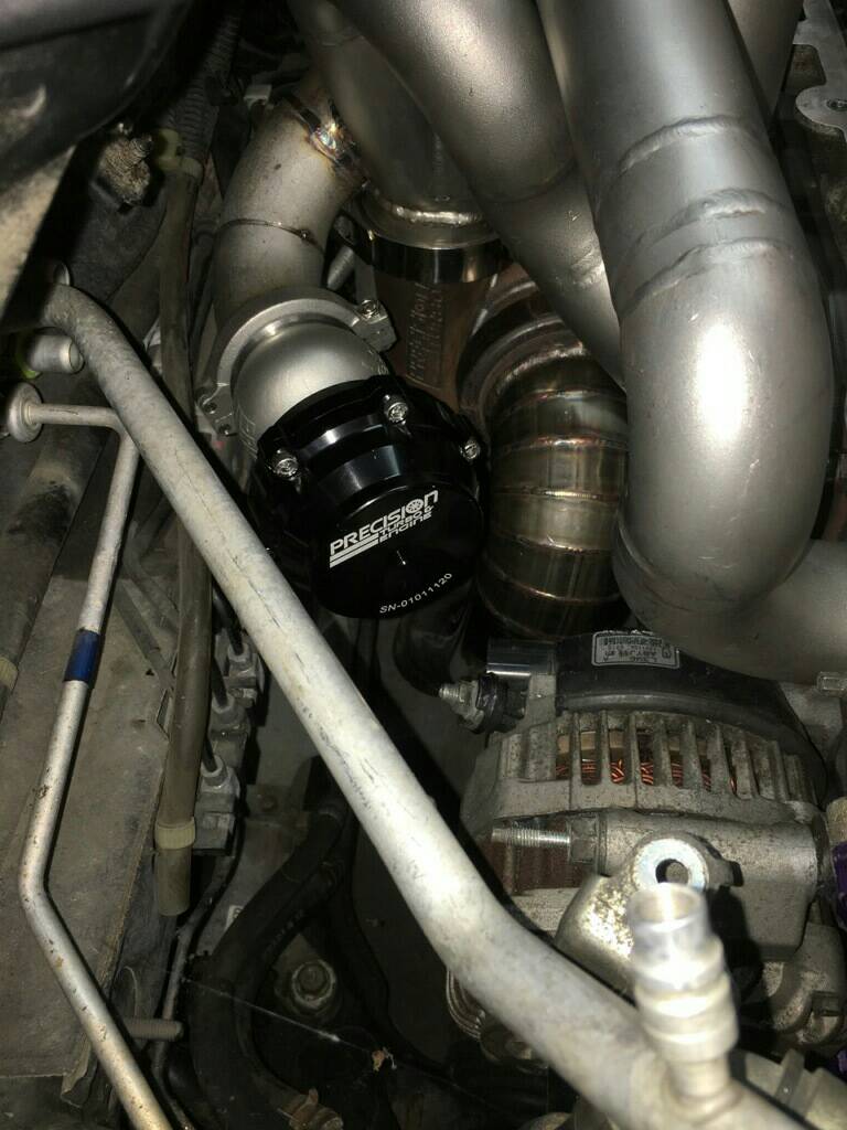

Default Gen1 5858 Build

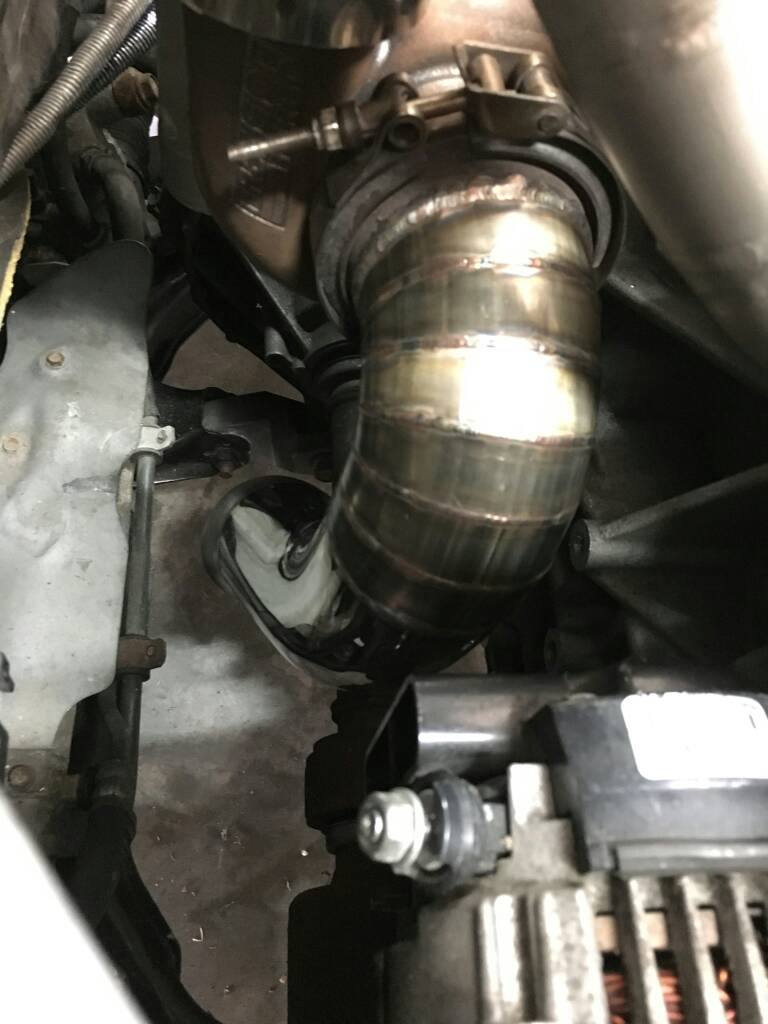

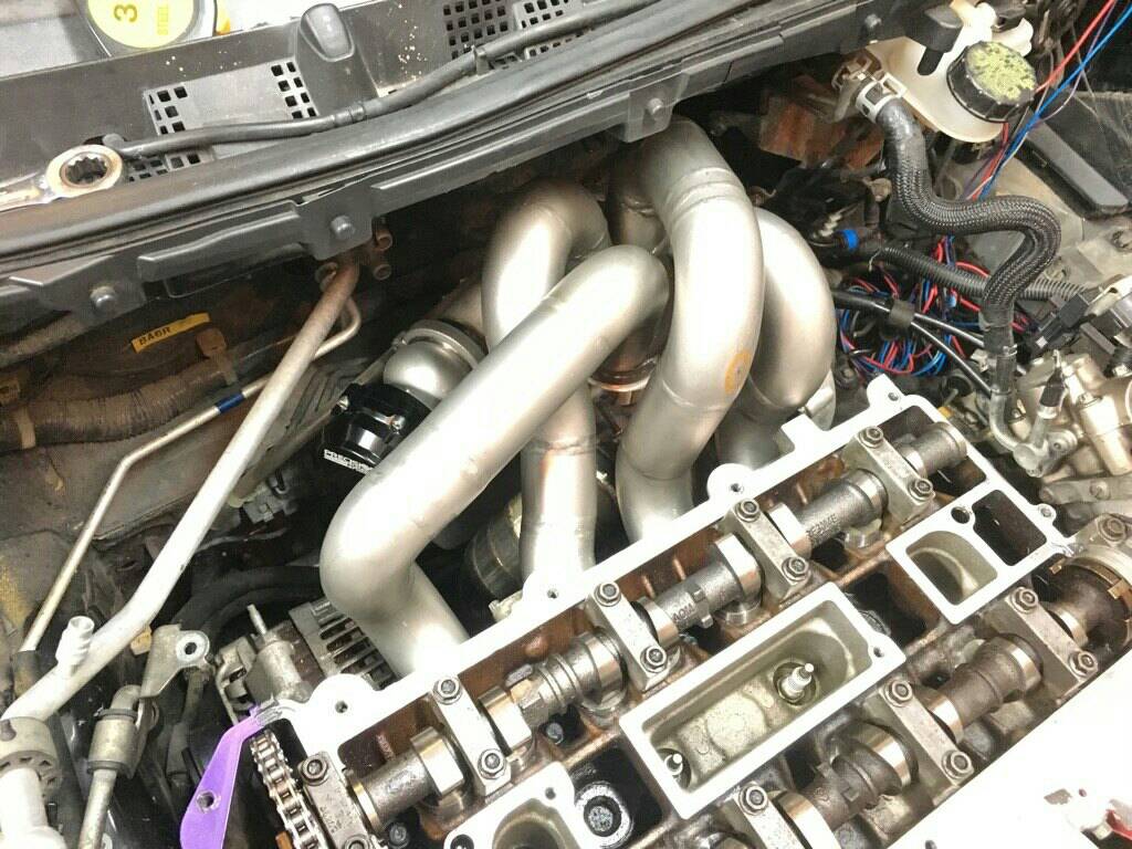

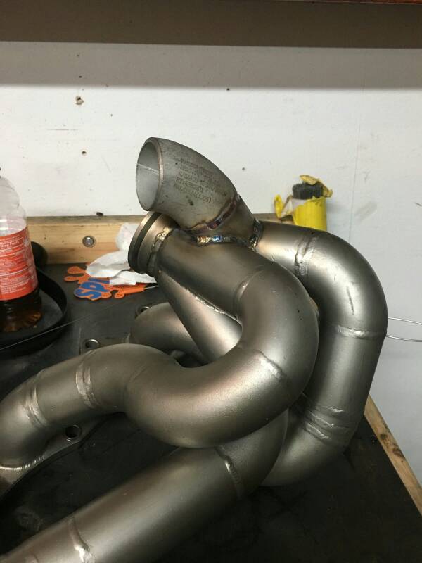

Are you not running a wastegate? I cant see from the pics if you have an ewg flange on the manifold but it looks like you dont and if your collector goes straight to your outlet flange like that then you wont be able to get an ewg flange anywhere where it would work.
06 MS6 GT Titanium Gray II Metallic
davychronic is offline   Reply With Quote

Yeah, you listed that you have PTE 46mm Wastegate and i don't see an EWG flange on your manifold.

The wg comes in the mail tomorrow actually. Will post updated pictures of the manifold when it's finished.

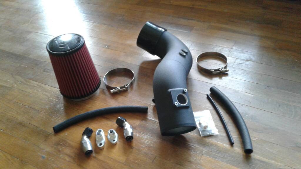

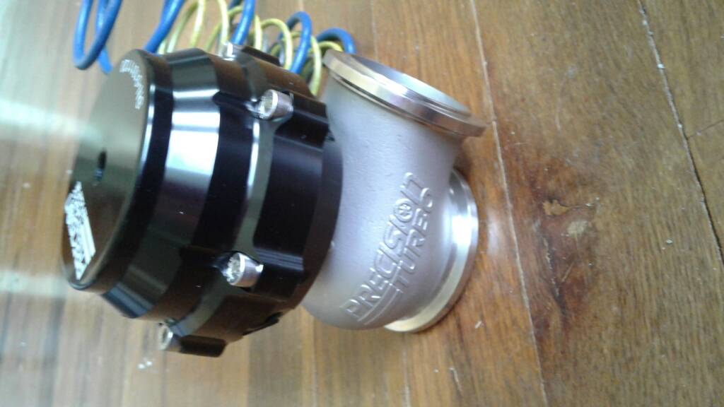

I recieved the wastegate, 4in intake, oil return line and some misc. Meth parts in the mail yesterday.

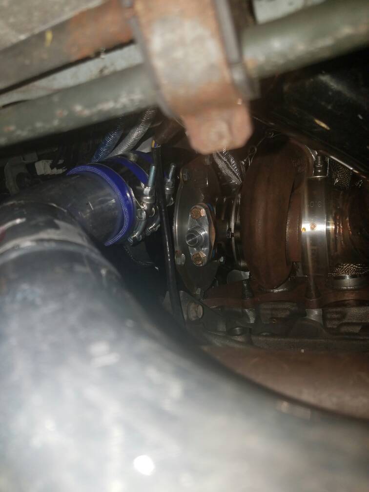

@5doorsoffurry I'm pretty sure they are h11 studs. Lol

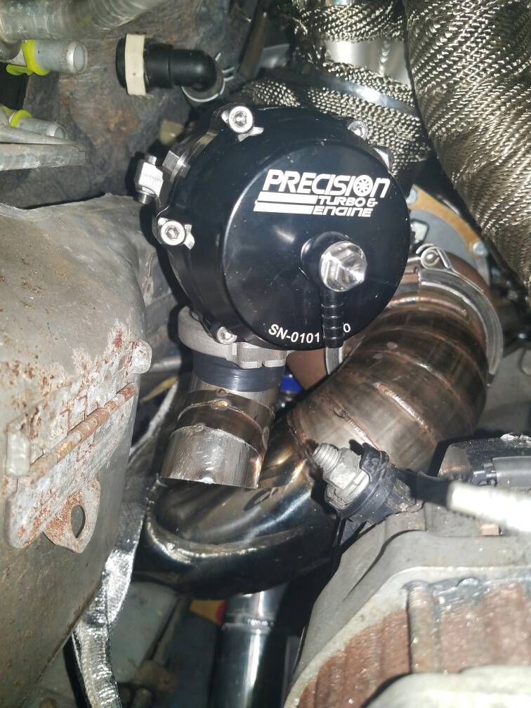

Also got the wastegate mounted to the manifold last night.
Better make sure you start tuning with a low pressure spring because that placement of the wg flange is going to cause a lot of creep

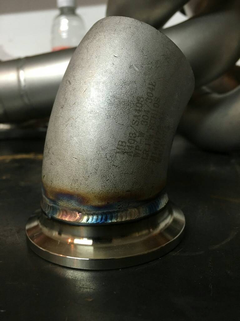

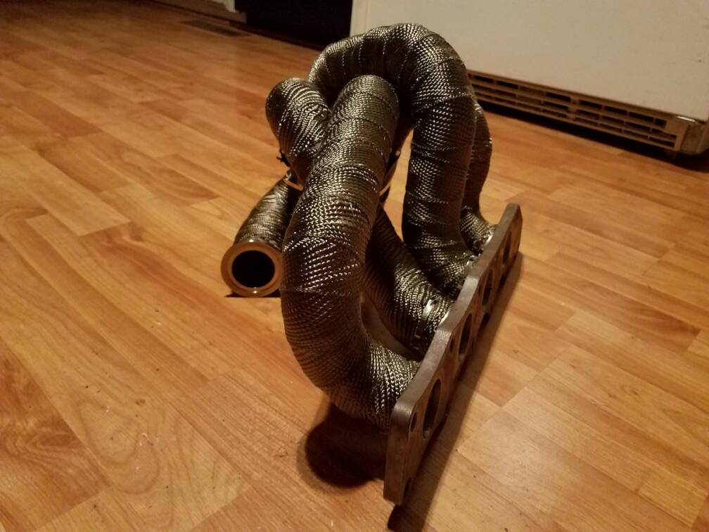

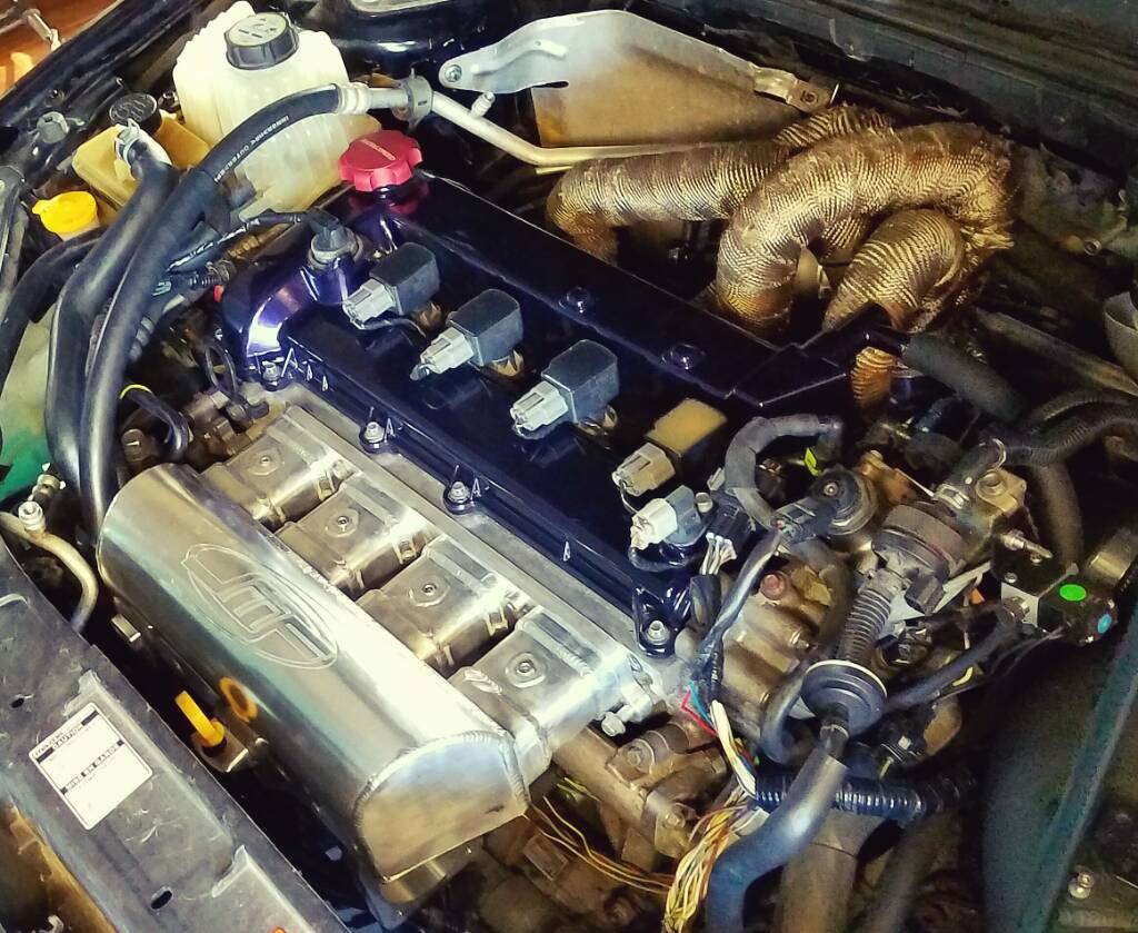

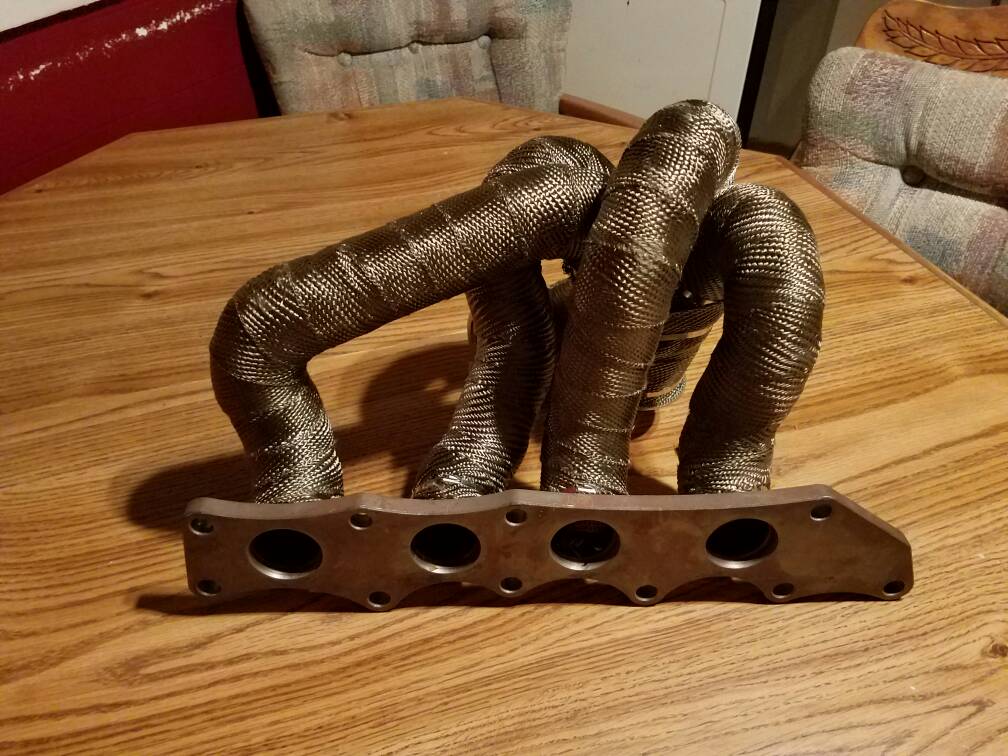

After many failed attempts I finally got the exhaust manifold wrapped.
Sent from my SAMSUNG-SM-G935A using Tapatalk

Correct me if i am wrong but doesn't wrapping a tubular manifold promote cracking over time with no turbo bracket to support the weight?
Any reason you didn't go with the cpe manafold?
It has a good wg placement and it can support a lot of weight.
I only ask since my build is very similar except for manifold/aux fuel purchase. Also are you going meth for fueling and not 5/6th port? If so how is your wireing going to be done? Progressive or boost switch? Why did you pick a 3 inch outlet on a 5858 instead of the 2.5 offered with the ported s cover? What are your hp goals?
Manafold looks awesome wrapped. can't wait to see some numbers!

You could be right about the manifold cracking, but my day job is actually tig welder/fabricator. So if it Cracks I'll just fix it. And I went with a custom manifold simply because it was cheaper. I made a package deal with a guy I work with. He's actually trying to start his own business that specializes in tubular manifolds, downpipes, etc. "Spoolin Fools" on Facebook, check him out.
Yes, meth for fueling simply because it was the less expensive route lol plan on PI after the car is up and running for a while. I picked the 3in outlet because I knew I wanted a 3in dp so it was easier to fab. I'm shooting for 500whp.

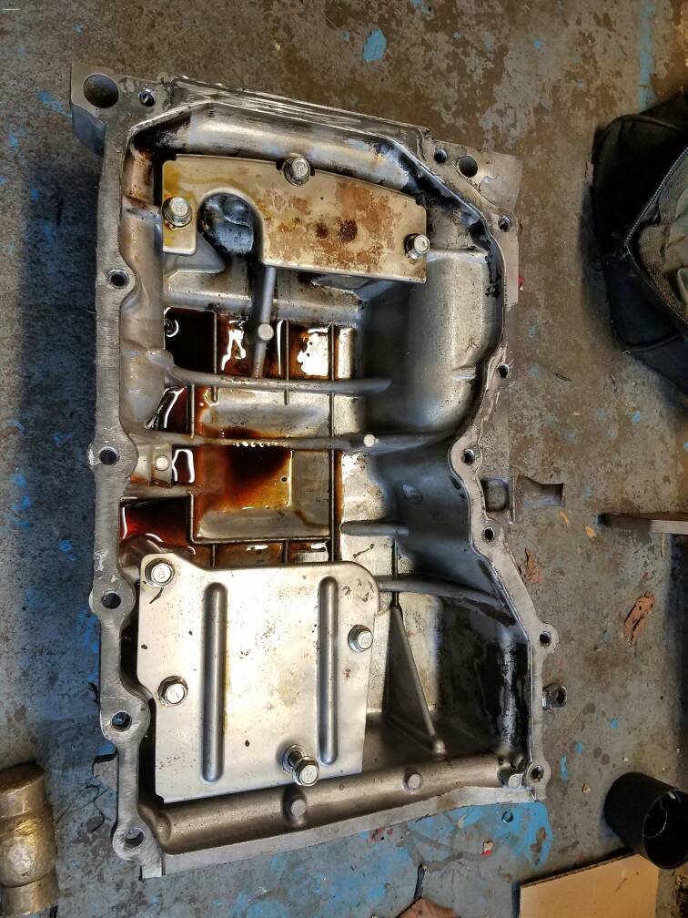

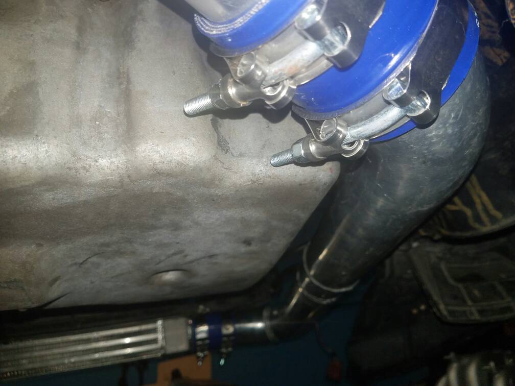

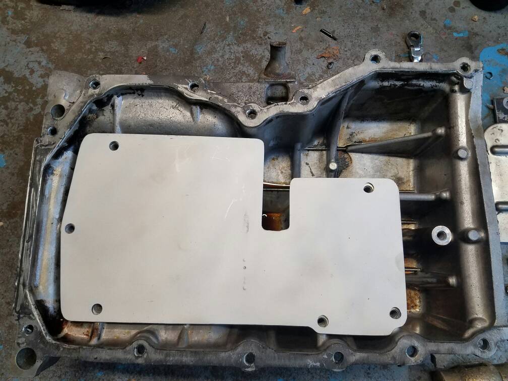

I managed to finally find the time to install my oil pan baffle this evening. I also got my valve cover and turbo compressor housing powder coated metallic purple.
And a little parts pic to go along with it.

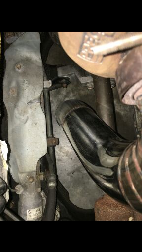

Not a huge update but it's something...
Finished up the hot side intercooler piping today, started the fabrication on the wg dump, and the intake manifold is coming along nicely.

Thanked 17 Times in 10 Posts

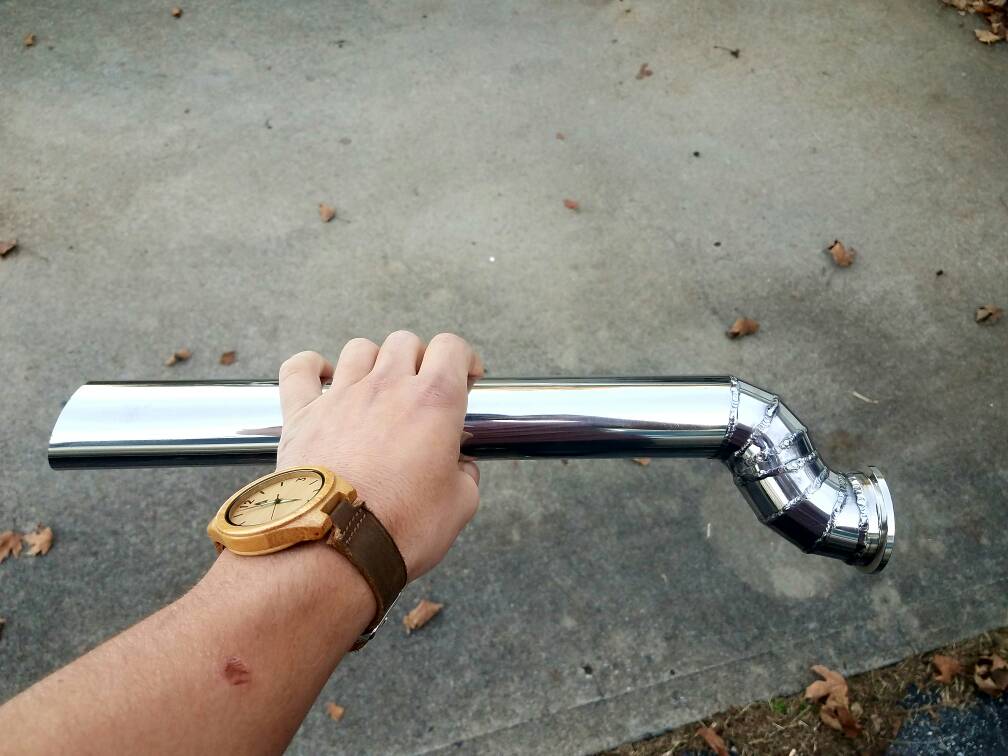

Got my wastegate dump tube free all welded up and installed.

Just a little update picture. I've got everything except transmission fluid, basemap, and a little key on no power issue. I'm sure it's something simple I just keep looking over. I also found a killer deal on this jmf that I couldn't pass up.
