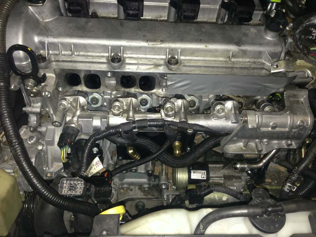

delete
Houstin, Texas
ms6_nate is offline   Reply With Quote
 Old 09-30-2013, 07:00 PM   #29
Rayd's Avatar
Posts: 171   (View Stats)
Rayd has a reputation beyond reputeRayd has a reputation beyond reputeRayd has a reputation beyond reputeRayd has a reputation beyond reputeRayd has a reputation beyond reputeRayd has a reputation beyond reputeRayd has a reputation beyond reputeRayd has a reputation beyond reputeRayd has a reputation beyond reputeRayd has a reputation beyond reputeRayd has a reputation beyond repute
Thanks: 30
Thanked 55 Times in 41 Posts
Originally Posted by ms6_nate View Post
OK so my PCV is still mostly broken. its better, but not working enough still. My current oil leaks are both the main seal dripping at the bell housing, as well from around the starter hole now too. Im going to buy he perm plate, but am trying to figure out the check valaves needed and placement. here is my idea. Would this work or does the valve cover need to be open with no valve to allow constant flow with the IM vacuum?
