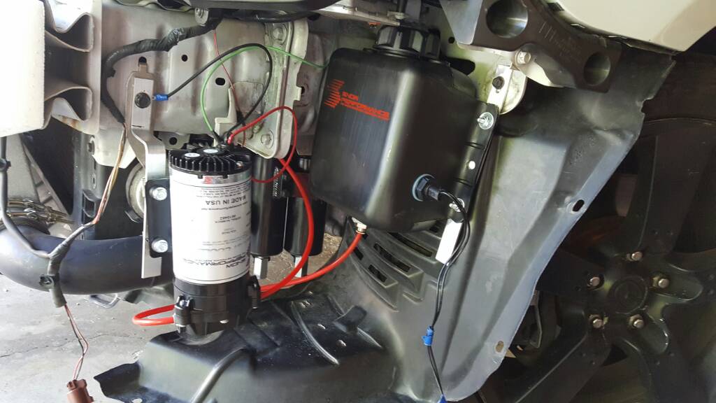

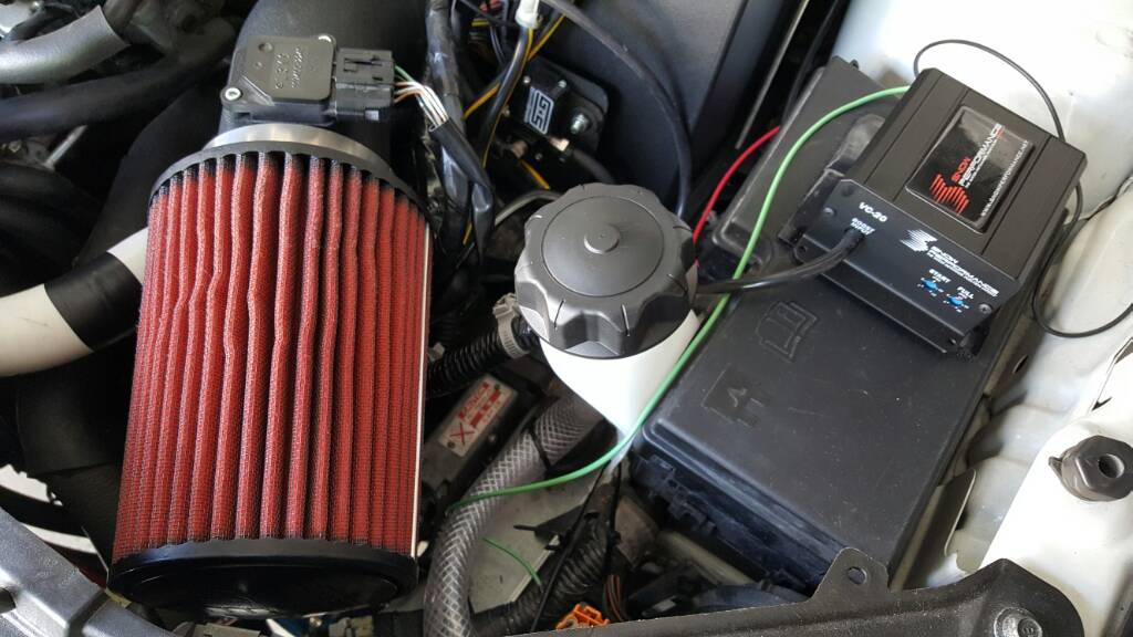

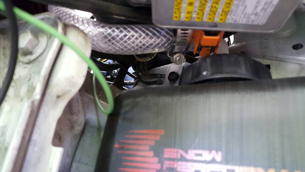

Forgot the pictures of my meth setup:

Wired the meth today. Left LED is low level (red) and the right is the pump activation LED (green). Wired in a kill switch as I don't always want to run meth. That is in the very back of the cubby and has its own LED to let me know if the system is armed or not. This is it off.
And here it is on.

That's exactly where I put my red and green led's, when I installed my kit 4 years ago. But I actually put the lights in the left most switch holder, and moved everything else inward. It was easier for my eyes to quickly look at that spot instead of the inner spot that you have it. Makes for a very clean install!
After testing it out today, this seems like the best course of action. Glad I am not the only one who ran into this. Gonna change this out ASAP
