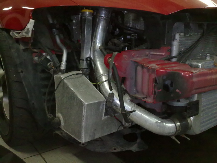

- dual 2" cat-back (some 2.75" overall estimated)
- 3" MAF housing w air flow straightener
- 3 ft of 2" pipe off the compressor outlet
- T3 divided turbine housing

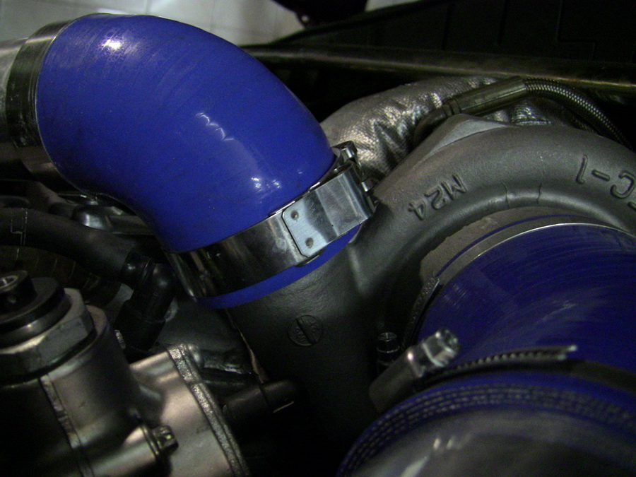

Since I wasn't able to switch to T4 or TiAL housing turbo-kit shortly, I decided to modify intake and exhaust at first.
And since my GT3076R was almost maxed out I decided to switch to FP 3076 HTA.

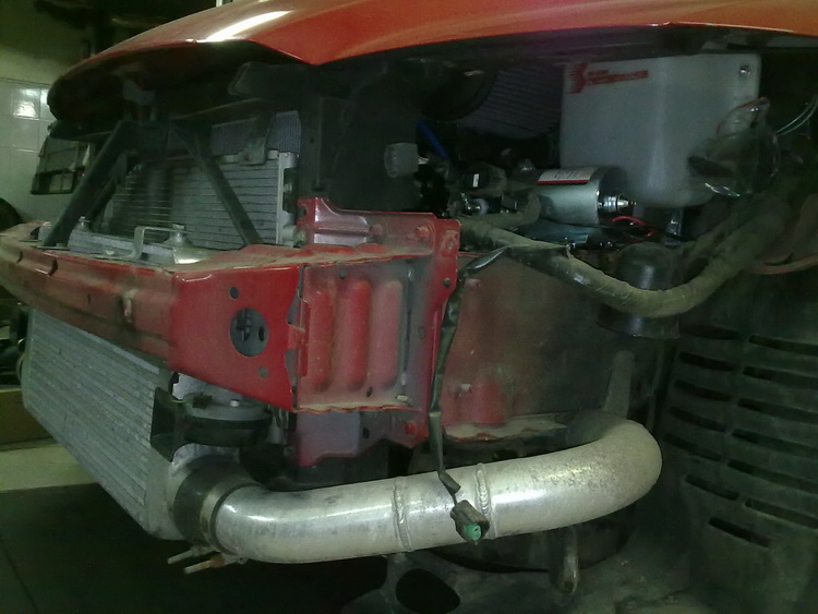

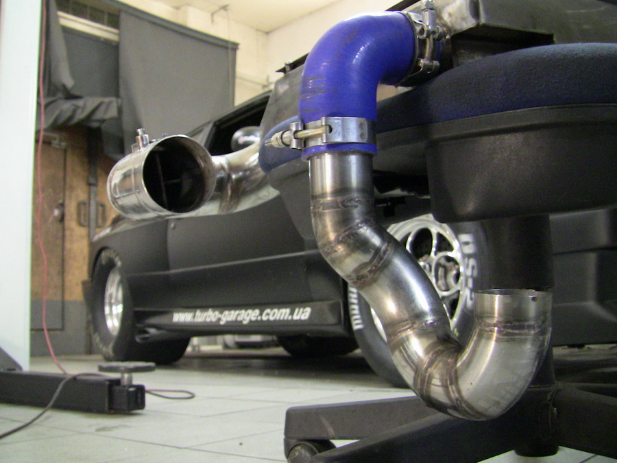

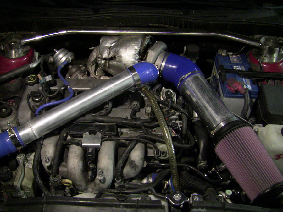

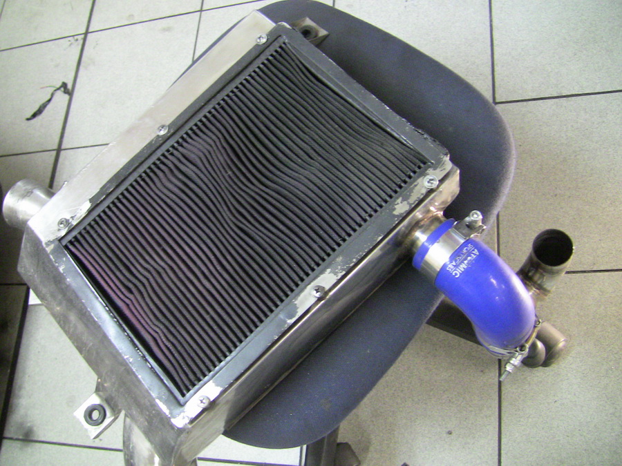

So I've changed my custom complicated stainless steel intake...
...with classic aluminum one utilizing 4" inlet to compressor and 2.5" outlet off compressor...
...and saved some 6 lbs with these mods.
To empty the space for 4" intake I've also installed the smaller battery, saving additional 12 lbs.
I've changed stock 60 lbs driver seat with 22 lbs Sparco Evo II one.
So I've saved additional 56 lbs by the way
In addition I've changed Denso ITV22 with Denso ITV24 (just in case), stock BPV with Turbosmart BPV, straightened and shortened vacuum hoses.
2" dual muffler pipes were changed with 3" ones (3" overall diameter estimated since main cat-back pipe was still 3").

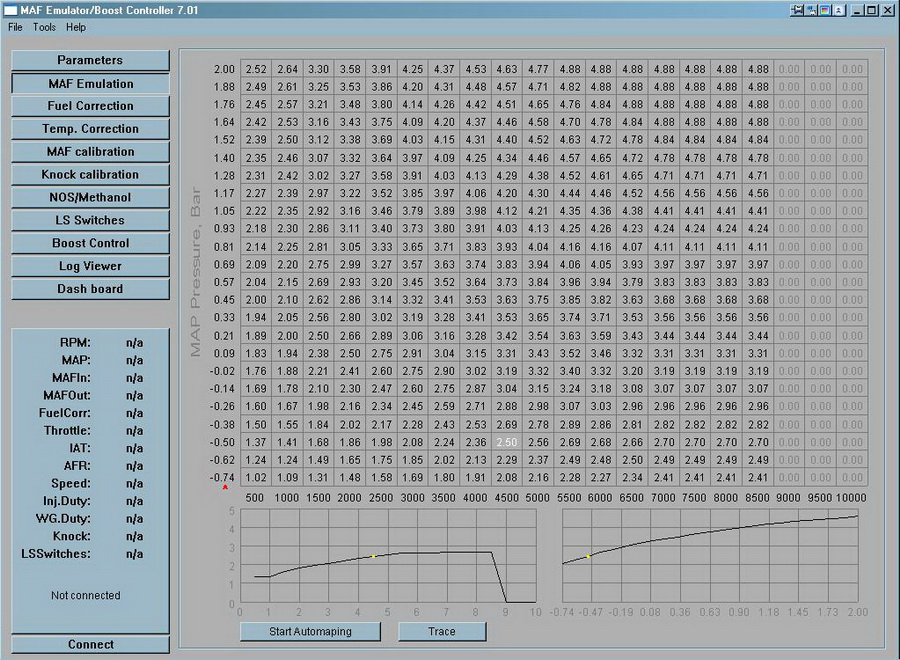

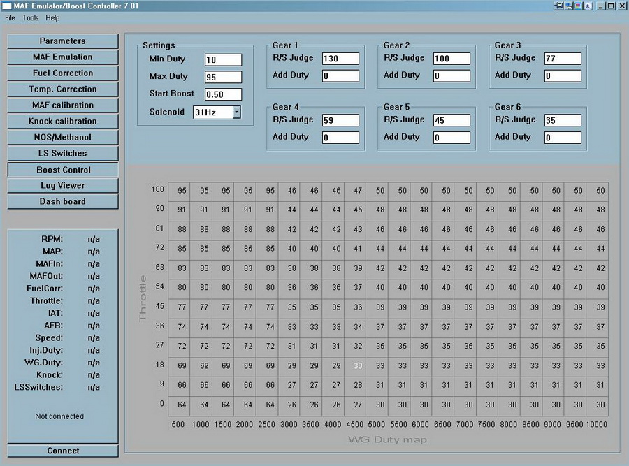

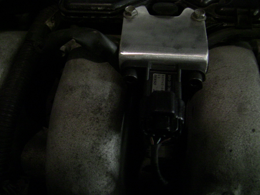

Since it was irrational to install MAF sensor to 4" intake I decided to switch to speed density fuel management...
... utilizing 4 bar Denso MAP sensor
So we've finished my car assembly at friday night (May 27) and I had no time to test and tune it in proper way cause friday night drag session was nearly to be closed soon.
So I tuned WG duty and speed density map almost virtually
Though with 30 psi tire pressure and 5800 launch revs I've hit 11.605 sec at the first attempt !
I was really shocked with this time !
But with my new setup untuned and untested I didn't know even the actual boost hold in that run. I only knew it was above 22.5 psi the whole run (cause factory MAP sensor was maxed out) but 27.5 psi somewhere at 5th gear (by my STRI boost gauge) cause I haven't logged my Denso MAP data that time, just OBD-II PIDs.
I was afraid of running it untuned anymore with such level of boost.
So I've dropped the WG duty and tire pressure to 22 psi both and done two more runs.
