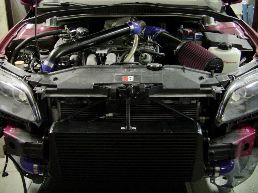

We've just finished the modifications of my FMIC kit today. I hope it'll be the last FMIC setup I'd ever need for the scheduled power.
(Photos of the previous FMIC setup were posted earlier at http://www.mazdaspeedforum.org/forum/foru...tml#post887229)
By the way we've returned back stock washer fluid tank, but have changed power steering fluid tank with custom one.
FMIC became a part of crash bar itself

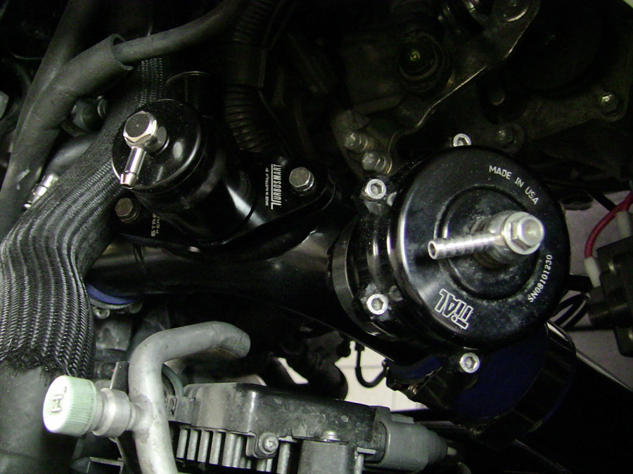

2 BOV's?

2 BOV's?
BECAUSE RACE CAR!

2 BOV's?
First I had installed Tial Q 50mm BOV with 8 psi spring, but it had been opening at idle.
So I've switched to 11 psi spring and have discovered intolerable compressor surge. Then I welded in stock BPV and solved most of the surge issues. One month ago I've changed stock BPV with Turbosmart BPV that has softer spring and thus 'killed' virtually any surge.
Since I already run speed density I can get back to 8 psi spring of Tial BOV and delete BPV easily, but I like the way this combo (Tial BOV & Turbosmart BPV) works.

You don't wanna suck in unfiltered air though, so keep it like it is.
I like dual bov's hahahaha.
