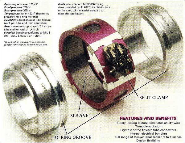

god damn Dustin. Jizz in my pants. Epic setup. Would you hit the track finally.
OMG I went through that on my 240. I swear they sent me Ebay aluminum foil vbands with my 1200 dollar turbo\Dp kit. I had to order a new set cause I wasn't comfortable with what was given. Or if your feeling like a balelr with your tax return you can spend $175 per clamp (and re-flange you piping) to run wiggins connectors........
Holy shit shit.. we run those on our A-10 warthogs

Wiggins are gay. Real men use duct tape.
