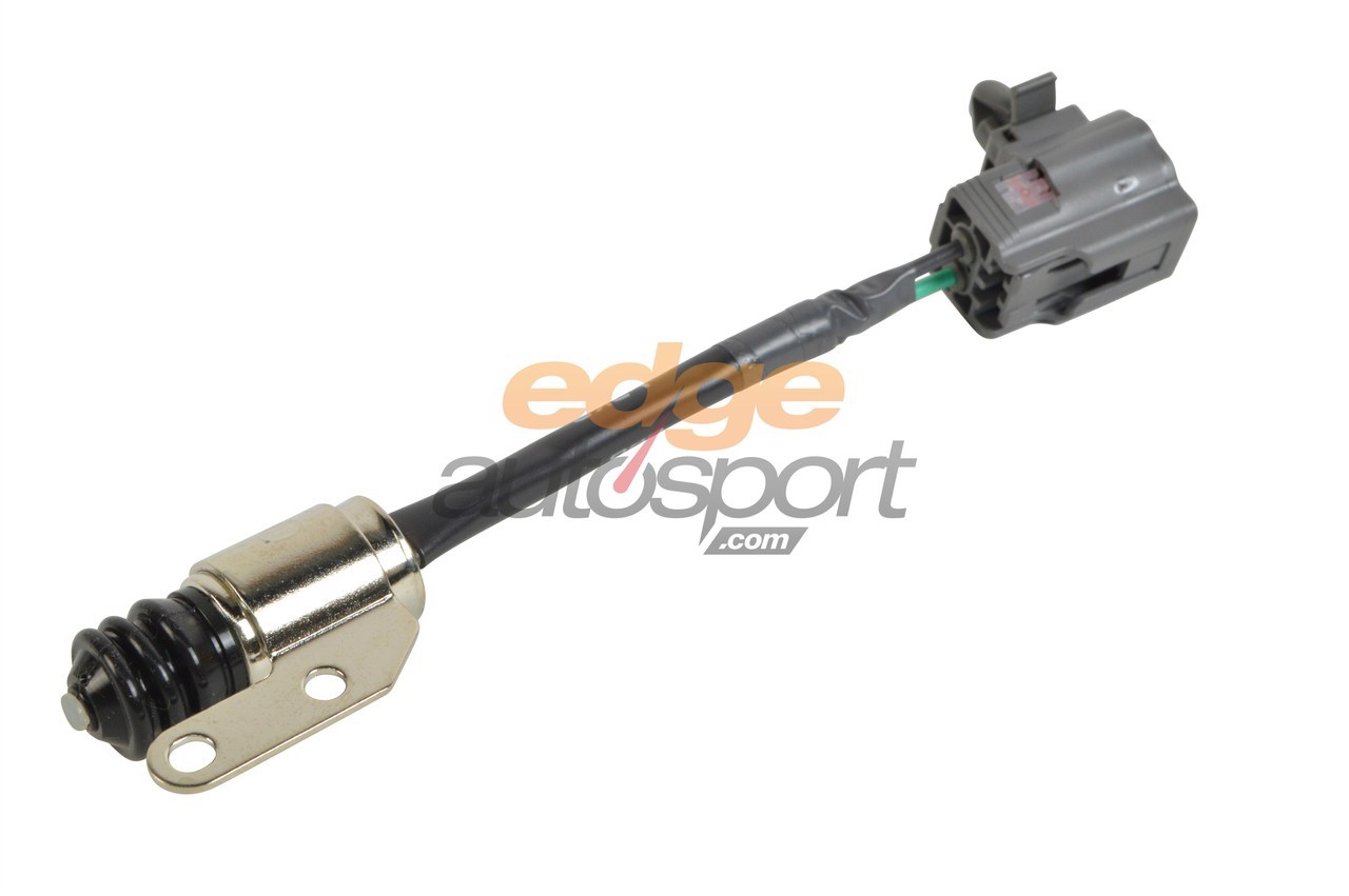

So Im confused here. When I removed the VTCS i removed the actuator rod and everything with it and tapped and plug the hole. I was looking though edge and see this
Yeah, I definitely removed that. I though the TPS was inside the Throttle body? Making sure I dont need to reinstall this with the cut actuator to engage the sensor.
Tht is the VCTS actuator sensor if im not mistaken (may not be 100% technical name) but it goes to the actual actuator on the VCTS and i think is wat sent the signal to the ecu to tell If VCTS was fully open or closed...
You will throw a code without tht sensor unless u wired in a resistor.
Edge has it listed as the Throttle Position Sensor, I was just making sure. I looked up the images of the TPS on Ellis and it says its in the TB. Ok, I'll stop fretting.
