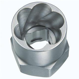

tap and reverse drill bits? or just drill it out completely. have u tried a larger torx socket yet? this is why i dont fuck around with torx's i use snapon ones or die lol... and let they bitches always soak if they are big
Tried the reverse out and all it did was completely round the inside out on the two torx bolts that wouldnt budge. I have the easy out tap set I will try as last resort, I really dont want to fuck up the threads on the head. First I think I might try the Irwin Nut extractor
I saw some videos of people using it on stripped torx heads. I could also try to notch the head and use either an pneumatic screw driver or pneumatic hammer and try and hammer it counter clockwise.
I had the dealership fuck my motor up when they installed the VVT and replaced the turbo 40K miles ago. Thy rolled the cam back and bent all my valves; had to replace my entire head. So I dont know if these bolts are known to seize or they overtorqued the shit but those fuckers are not moving.
i have a set of those bolt removers u attached.. they do work but ive never used on a torx bolt only on regular SAE and metric bolts/nuts... worth a try.. irwin has them on amazon for cheap...
Also the air hammer isnt such a bad idea just make sure u make the notch pretty wide so the air hammer can bite... Other solution with heat would work but u better be careful with where u point the heat. i would pull all the rest of the injectors and use the heat from the injector side flashing the heat away from the current injector still installed...
Success! Came out easy with the bolt remover!
