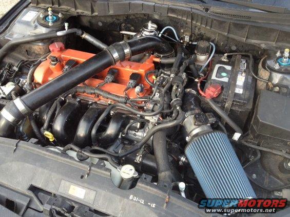

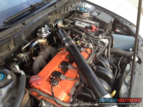

Spent the last few evenings pulling old turbo out and in with the bean. Got the manifold wg flange welded on yesterday and finished up the car moments ago. Loaded a base map with 11* timing and on spring pressure only. Everything is dead on and that ewg with the screamer pipe put the biggest grin in my face ever!! Got out of the car smiling and looked down at my hands to see them shaking lol. I will get some logs tonight and start some tuning and get some pix up for you guys.
Car does not spool like the lil k04 did. But she hits hard and keeps pullin till you let off the skinny pedal

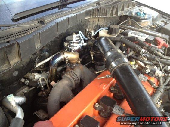

Got any shots of th ex-mani w/ EWG?

Pix will be coming tonight. Don't give me crap for the crappy welds on the exhaust mani. 403 to cast iron is not too easy, especially with no practice lol. I need some freaking 5th port asap

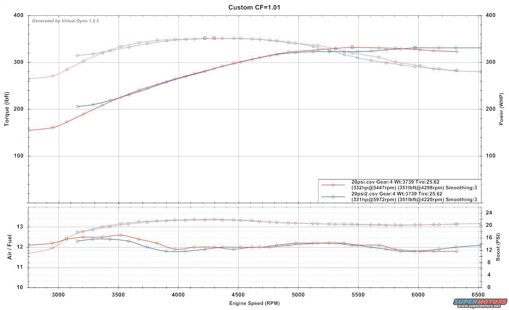

Got my first share of logs tonight that did not include, idc's in the 105 range lol. 20psi, 12.0 afr, max timing 13.* I will get it down to an e30 mix and try to get more boost/timing. Sat at the track should be mid 90's, so I'm not expecting too much. We will see. I will try to get some more tuning done tonight/tomorrow and get some vd results to compare.
Oh yeah, and its hell of hot here. 100+ degree bats with a fmic
Lookin good bro. Clean up that MAF curve a tad. Boost curve looks great but thought you wanted a reversed boost taper?

@RichieRichness;
Yeah I need to clean it up a lil, I will be tapering up to 23psi for now, as long as my idcs don't get too high. Logging/tuning tonight. Racing tomorrow morning lol.

Originally Posted by speed3sailor View Post
how did the racing go?
Ran 20psi so did not expect a whole lot. It was mid 90s too. Did 3 passes, best of which was 12.8 @ 109 with a bad 60ft. I revved out to 6.5k or so, If I would have shifted @ 6k, I would have trapped at least 110. My power dies down up top because lack of boost and timing
If you're running out of injector you should pull back on the E85 concentration. Put in 3 gallons. With that on a BNR you should have more than enough injector for 12AFR and 24-25psi of boost especially in the warm weather. For timing you should be at least around 15-16* up top with that mix.
I am on an e30 mix and run out of injector at 21psi and 13* of timing with a 12.2afr. I am wondering if I run out of injector so early because of the ported head/im and what not. I would have loved to run 24-25psi with some good timing, but I def need meth to do that.
Post up a log!

Thanks: 1,042
Post up a log!
First one is showing my injectors not keeping up up top
Second one is a clean run with the vd posted on first post of thread

Is that vdyno on pump only or do you have E mixed in? Currently with temps the way they are in Jersey, I can't even come close to 13* timing on 93 :/
That was on about an e35 mix. Temps here have been 105+ lately. E-85 makes a huge difference on timing

reverse taper to 23 pounds feels insane!!! Too bad my injectors cant keep up. IDC's 109 and sputtering up top. Guess it'll be 21psi tomorrow

can you lower the e85 mix while keeping knock protection? won't that help with IDCs a bit? obviously spraying meth would probably be the better option either way
I've dropped to an e30 mix. Going any less, the benefits aren't quite there
