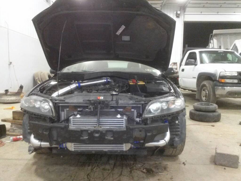

Hey everybody I finally decided to write my first post. I've been using this forum for months and want to thank everybody for the great info. So I'm gonna tell my story and please don't get too mad if I break a forum rule because it is my first time.
I got a 2006 speed6 with 76,000 miles soon after I turned 18. It was about the only sedan that had a strong turbo engine without looking too crazy (my dad bought it for me). It also is a lot cheaper than a Mitsubishi or an STI lol.
Anyway I drove it for awhile stock but it didn't take long until I wanted some more power. The first upgrade was an Access Port. I was kinda disappointed when I first got it because for some reason the off the shelf maps weren't hitting their boost targets. I still don't know why they weren't but I figured there must have been a waste gate problem. So I just made my own load based tunes and they worked great but it didn't seem to give it much more power. The stock turbo was maxing out at 225 grams/s. I even tried unhooking the wastegate and stepping on it at high rpm to see what I could get out of it but even then it only went to 231 g/s. Also my transmission was starting to give out. It was popping out of 2nd gear when coasting but acceleration was fine.
I put a cpe rear motor mount on to see if that would help but it didn't. It did make it nicer to shift though.

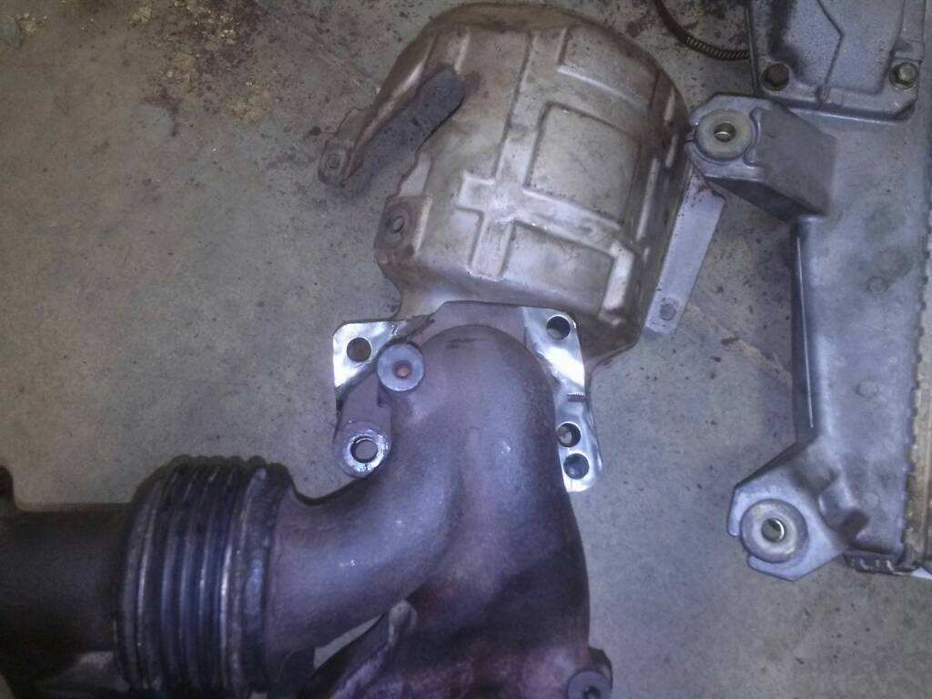

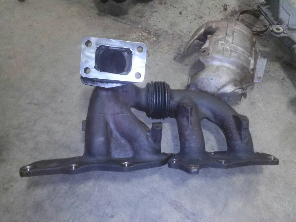

After I determined the turbo was maxed out I pulled it into the shop one afternoon. My initial plan was to take the down pipe out and weld in pipes where the catalytic converters were. But I had no idea how hard it was to take it out lol. I finally got it out and I realized there was no easy way to replace the first cat with a pipe so I ordered an eBay down pipe. That evening I went over to my brother's place and we were talking and he was showing me the turbo stuff he was buying for his Nissan and soon we came up with the idea to put his turbo on my car.

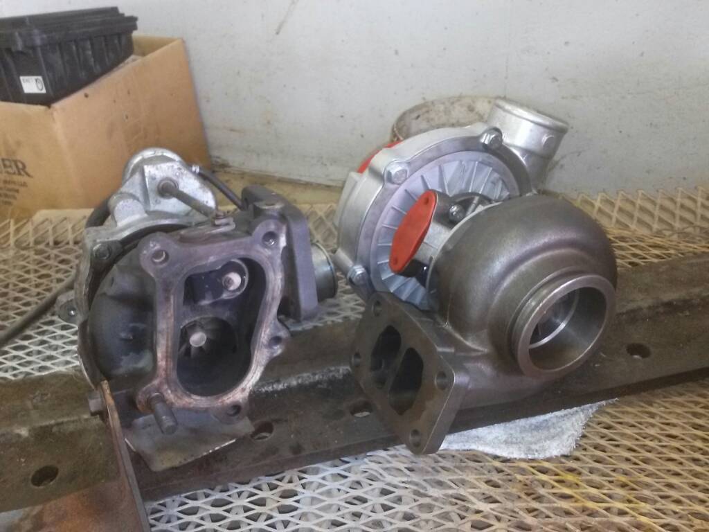

The turbo was a $175 t70 off eBay from the speeddaddy store. As far as I know it has a 56/73mm 70a/r compressor and a 74/58 82 a/r twinscroll turbine. We took the stock turbo out and figured out the big turbo would fit. I got my buddy to weld the T3 flange to my stock manifold and he drilled new holes and did some grinding to make it fit. I got a universal 2.5 inch piping kit, a 25x12x3 inch intercooler and a Bov off of eBay.

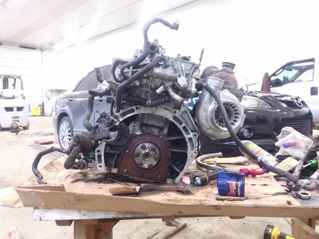

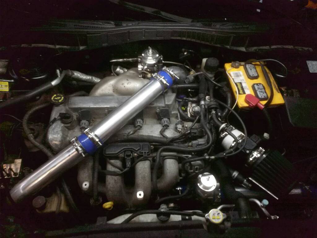

I got a 3 inch intake also. I had to deleted the egr valve to make the turbo fit. With a some help from my brothers and my buddy who is a mechanic we got everything together but I did not put a wastegate on. The turbo spooled at 4000-4500 rpm but it was a pain to drive because I always had to make sure it wouldn't over boost.
A few weeks later i put a wastegate on from obx racing. With my buddys help we drilled a hole in the top of the manifold and welded a flange on. We then put a section of flex pipe from the wastegate to the down pipe. After that was on I finally figured out how fast it was! The air flow went up 350 g/s range and the vdyno went from 225 stock to 350 - 400 HP range. I had the wastegate set at 21 psi. The 0-60 times went from 5.9 stock to the 4s( the best I did was 4.4 and the quarter mile in 13.00. I'm happy!! Lol

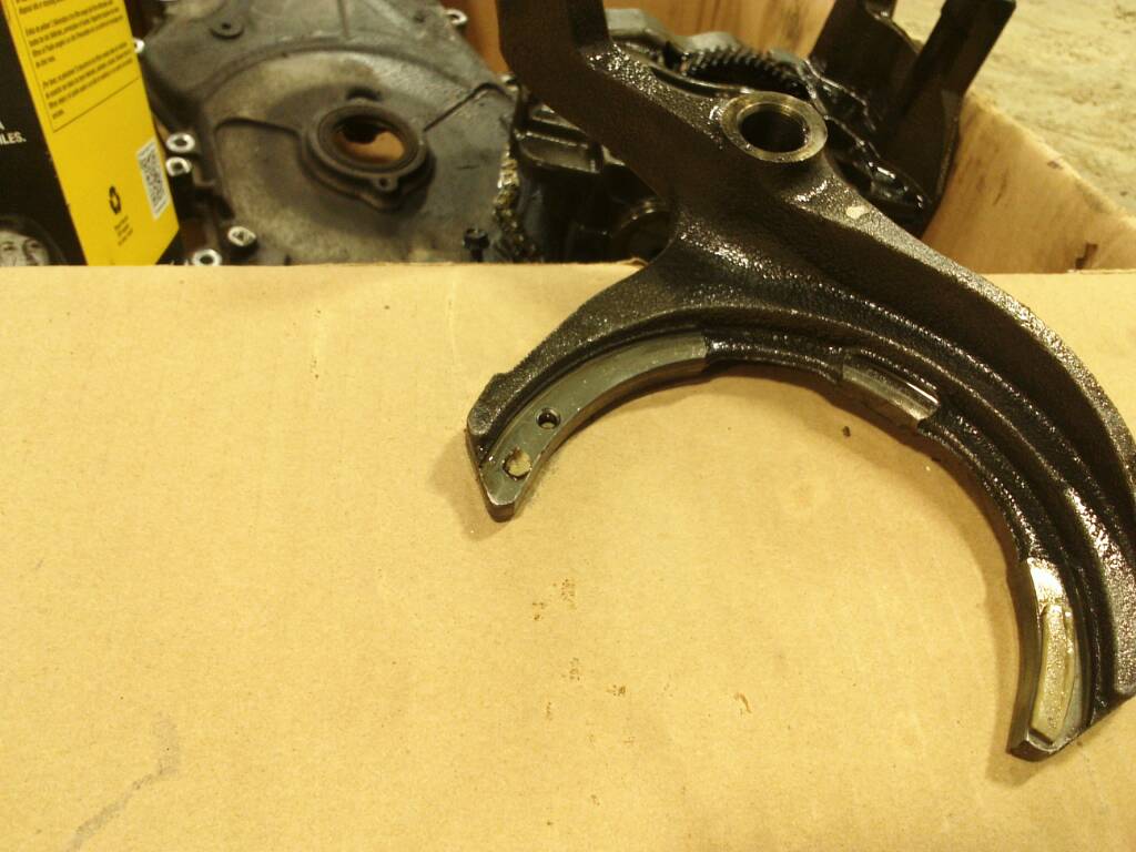

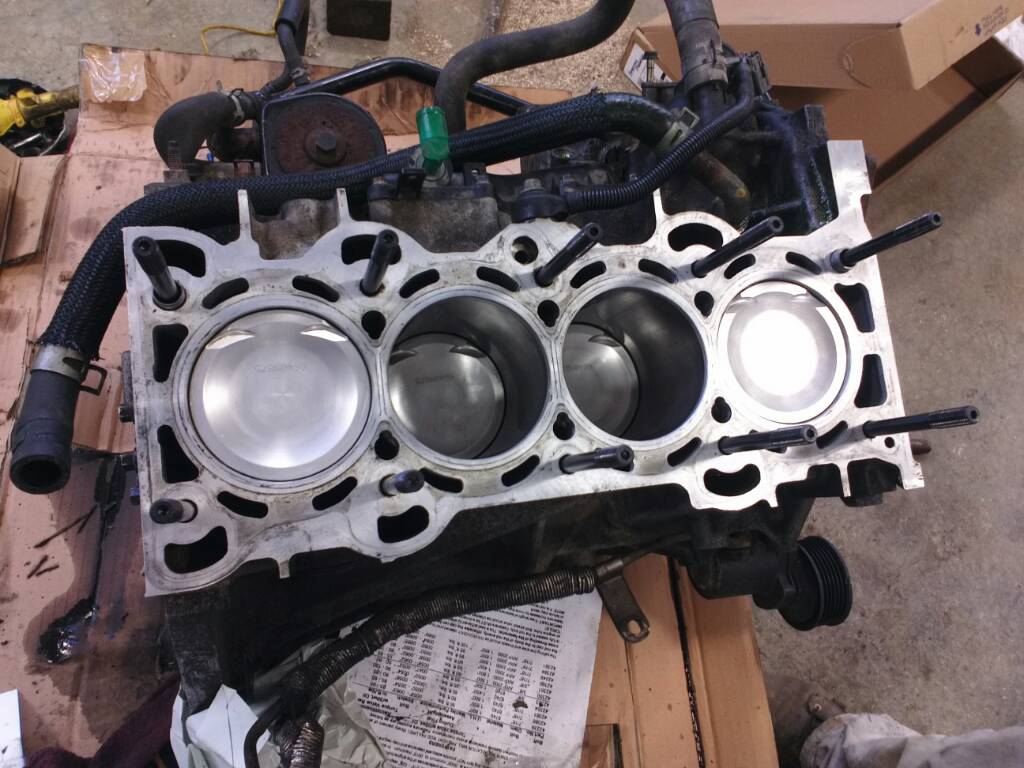

Eventually second gear got so bad it started popping out under acceleration so I had to skip second. At that point I pulled it into the shop dropped the engine and trans rebuilt my transmission, put a act clutch in, and did a full engine build. The transmission fork for 1st and 2nd had the plastic pads broken off so I order 3 forks from speed performance with brass pads. The Transmission works great but I now I have more vibration with the new flywheel and balance shaft delete which can be annoying at lower rpms. And now my fuel pump is maxed out so my engine build didn't help me much so far. I never upgraded the fuel pump internal because I'm assuming that's already done because I don't think a stock pump supports 20 psi of boost or 400 HP. I never dynoed it but it seems the vdyno is fairly accurate from what I read. With air its flowing that makes sense.
Sometime I would like to get a twinscroll manifold, a better spooling turbo and port injectors.
Yes I'm slightly redneck lol. I bet i'm the only one with a stock T3 turbo manifold :-) —But I'm having fun and I think it can be even more fun when you don't quite play by the "rules". So far the turbo has been holding up so I guess not all eBay turbos are bad.
There's a lot more I could explain but I'm tired of typing so just ask questions if you want more details.

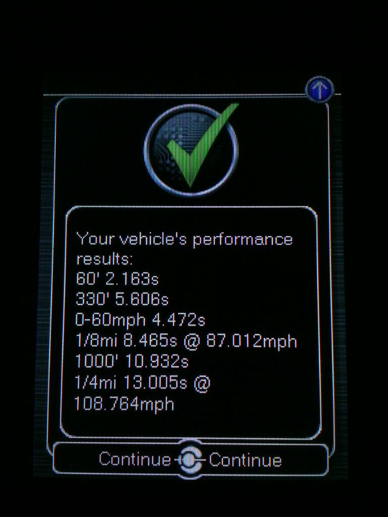

Nice times. What track was that at?

BTW that 1/4 mile I was just on a road. There's a long, flat bridge nearby so I it did at night when there wasn't any traffic.
