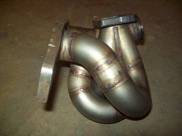

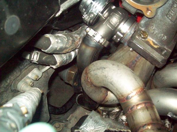

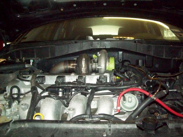

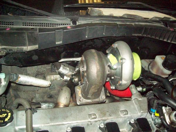

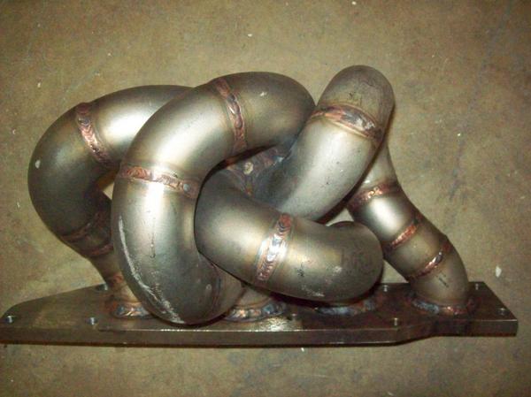

Stole these from my original thread.
Don't know how much help they might be but here you go

That's a band-aid ninja, no matter what you say...
Looks more like a double headed dildo from here....

Not sure how feasible it is, but from looking at mark's pic's i think i can squeeze the EWG runner up under the down pipe, and then just recirc it back to the down pipe.[/IMG]
recirc to down pipe? dump that shit son!

Is it just me, or does that first runner on the right (#1 I believe) in pic 3, look smaller than the others...?

It does but it's just the pic. I've looked at the runner quite extensively and it is the exact same tubing and the exact same size. I think it is just how they did it.

i think the pics were taken with a wide angle lens.

DJ if you want some help of what it might look like from the backside of the motor here is a link to my thread from when I mocked up my setup on a spare block I had.
http://www.mazdaspeedforum.org/forum/foru...rk-road-50510/
and a couple of it mounted in a MS6 in blow through.
anyone interested that whole setup may be for sale, as I think its gonna be MS6 DD and Miata Project car.
looks like a neat idea, but good luck gettin all 10 nuts tight on the head ese!

I was thinking of making it with windows on the turbo flange section, so you can easily get in there. I think it would only need one "window" honestly.
Kinda like this.
We'll see how it looks when i get my motor to use as a jig. And even with a window, it'd provide a gob of bracing.
