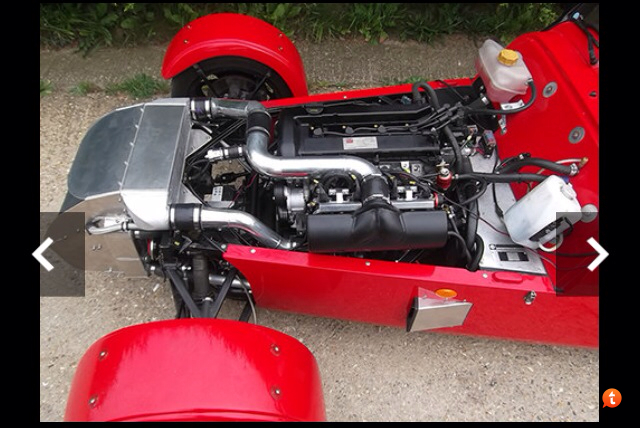

 Old 01-09-2014, 07:24 AM   #57
Total mps's Avatar
Location: UK
Posts: 46   (View Stats)
Total mps is the leader of the worldTotal mps is the leader of the worldTotal mps is the leader of the worldTotal mps is the leader of the worldTotal mps is the leader of the worldTotal mps is the leader of the worldTotal mps is the leader of the worldTotal mps is the leader of the worldTotal mps is the leader of the worldTotal mps is the leader of the worldTotal mps is the leader of the world
Thanked 127 Times in 29 Posts
great job this i few things we have available in the uk for the 2.0 and 2.3 motors
Total mps is offline   Reply With Quote

Is this supercharger for Caterham?
paveltol is offline   Reply With Quote
 Old 01-09-2014, 01:25 PM   #59
Total mps's Avatar
Location: UK
It's for a Westfield but perfect for in Mazda block too

Thanks: 399
Thanked 416 Times in 279 Posts
How much does one of these run?
So I'm sure that pic is just to show off the supercharger but why is there a supercharger on an engine with ITBs and velocity stacks?

The trumpets are removed and air tight plenum gets bolted on . Itv still remain in place will put image of fully assembled kit on Monday when back In work
what's wrong with boost and itb's?
even keeping the stacks would benefit if they would fit under the cover.

Nothing at all best air distribution you can get
it was the complete lack of a plenum...of course you can run ITBs there's just nothing to collect the air.
I knew it would be a mistake to bring it up but hey that didn't stop me apparently

the plenum clips on over top.
