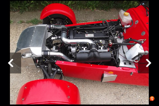

great job this i few things we have available in the uk for the 2.0 and 2.3 motors
So I'm sure that pic is just to show off the supercharger but why is there a supercharger on an engine with ITBs and velocity stacks?
what's wrong with boost and itb's?
even keeping the stacks would benefit if they would fit under the cover.
it was the complete lack of a plenum...of course you can run ITBs there's just nothing to collect the air.
I knew it would be a mistake to bring it up but hey that didn't stop me apparently

Is this supercharger for Caterham?

It's for a Westfield but perfect for in Mazda block too

The trumpets are removed and air tight plenum gets bolted on . Itv still remain in place will put image of fully assembled kit on Monday when back In work

Nothing at all best air distribution you can get

the plenum clips on over top.
