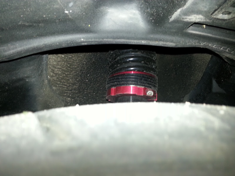

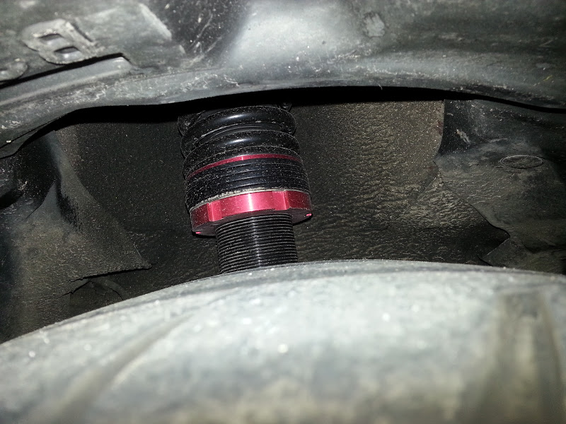

Welcome everyone to the first call thread for Corksport (or is it Crapsport)
Here is my issue, I asked about shock re-valving for the coilovers in August of last year and have still not received any information on it. I figure you advertise they are rebuild-able so why do you keep ignoring me when I ask about it. I'm not pleased with the valving at all, at full height and at the stiffest setting they run out of travel, or the springs bind. Why you went with springs that only have about 2" of travel when compressed is beyond me. You could have went with an 8" spring instead of a 5.5". Isn't that why you do all of that development in the first place.
I have emailed Brydon a few times about the noises I have been hearing and was inquiring if that was normal and heard nothing back. It also took me over a month to receive a replacement rear shock from you guys. It's a good thing I bought two sets then wasn't it. How can I compete if I can't even drive to the events?
Lastly today was the final straw, I noticed that at full lock under compression your endlinks on your coilovers rubbed up against my chassis and have dug into the frame. Thanks a lot Crapsport. Not only have I recommend these coilovers to others helping sales but now I feel like I have given bad advice and steered others down the wrong path of poorly designed parts. You can't blame this one on installer error like you tried to blame the shock.
I don't daily drive this things, I take them to the track and put them through stresses that you supposed engineered around.
I humbly request a refund for both sets of coilovers and the endlinks. I will ship everything back to you I really don't care. I'm tired of having to deal with this. You are making the chassis look unreliable at the track when others see the stupid issues that I'm facing every weekend.

The problem is:
1. Needs an 8" spring for proper travel
2. Endlink bracket needs to be welded in the proper spot
3. Dampening sucks, The hardest setting is what soft should be, anything less then 1/2 is unusable on any road surface.
Rear camber arms are awesome, I have them installed as well.

I also have mine set to the stock height, or as close to stock as possible, and when I go over a sharp bump on the street, there is a horrendous bang from the front. Most likely fucking my front wheel bearings. Not just that but at the track it unsettles the car in a high G corner or if the track is less than smooth or if you clip the curbing.
Here's the front driver's side, static as it sits on my driveway:
Here's the front passenger side, static as it sits on my driveway:

Your car was my main decision factor with these coilovers. I was hoping to have the same experiences.
Could you please check if you are running 8" front springs?
I have 8 track days in June and I need to find a solution for this ASAP.

Damn, those springs definitely look like they have almost no travel at all..
Stock endlinks will work as I'm running stock length PowerGrid endlinks with my CorkSport coilovers.
Why do you have the adjusting ring run up so high?
Nator is what it does.
It almost looks like they used the preload ring to lower ride height.
A little tapa tapa taparoo...
car is set to as close to stock height as possible.
in the absence of roll center adjusters in the front, i found that stock height gave the best handling characteristics at the track.
MajesticBlueNTO is offline   Reply With Quote

Don't think these were designed to be set to that height. I have mine set for about 1 inch drop.

by the looks of them they not deigned for stock height, that would keep the coils from bottoming out, by having less preload would fix the spring binding issue
but valving is a diff story
