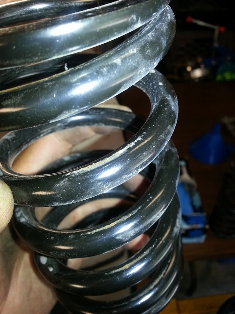

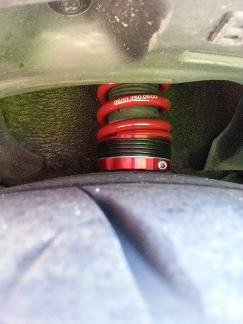

We have changed all 3 sets of Coilovers that were experiencing the issue to the springs that Paul mentioned in the Development thread - Eibach 2.5" ID, 6" length, 500 lbs/in (0600.250.0500)
Before, sitting on the driveway:
Spring removed, you can see the rusted parts from where the coils were making contact while blocking:
After, sitting on the driveway:
These springs ride MUCH better. There are no more noises that were previously chalked up to "because coilovers, bro".
I can take a speed hump at 40 km/h with no horrendous bang like before and they are also, dare I say, comfortable
Hopefully they'll see a shakedown at the track this Sunday.
Thanks to CorkSport for getting in contact with Paul to help us in our endeavours at the track and in helping to better the products for the Mazdaspeed community.

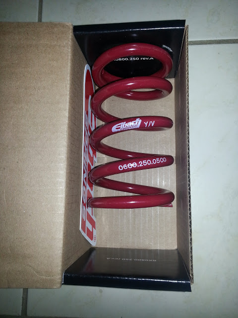

OK I think I found the spring spec I was looking for.
But @MajesticBlueNTO and @Celestspeed3 didn't provide how they did set up the car height with the adjuster ring to get the car as lower and closest to the height, the original springs from this Kit.
Can anyone of you guys who ran this Eilbach spring confirm the following:
1) What helper spring goes with this Eilback 2.5" spring? Is it what cames originally with the Corsport coilover kit?
2) How did you adjust the height to get the car's height lower than stock.
Those are the 2 questions I'm trying to solve now. And I'm running out of time because the first events are starting already this coming weekend and I'll need to hit the alignment shop again after the install.
To anyone who can give some heads up, please feel free to chime in so I can get the car ready for this racing season.
Thanks

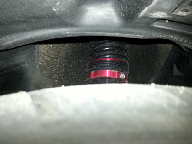

So is this how you guys set up the helper springs with the Eilbach?
Is the helper spring supposed to be all the way compressed, static, like in the pic below?
This is what I'm trying to figure out.

Helper springs are fully compressed at ride height. At some point in droop travel, they become uncompressed. They are supposed to touch the main spring at full droop to keep it seated.
Adjust your perch to whatever ride height you feel like.

Yes the helper spring is supposed to be collapsed.

The reason I was so confused was because I got a 9K spring and the helper spring was all the way compressed. And there was no way it looked normal to me since the front of the car was way to high.
Ii guess I'll drop the 9K spring and go with the Eilbach spring + helper spring.
Hopefully this should solve the stability I'm trying to achieve on the front.

9kg/mm = 503lb/in. Was it a longer spring?
Edit: If it's a no name brand spring, the rate could be WAY off.

Yeah, it was a longer spring. Longer than the Eilbach in this pic and longer than the one that comes with this kit.
What I did was trying to take out the helper spring to get the car to an acceptable height, since the front was way too high. But by doing this, the 9k spring was not being compressed when not install on the car. And when installed, the only way I could get some compression on the spring, was to set the adjuster ring pretty high. Therefore this will cause the car to be up very high once the car is of the jack.

Good call. The shorter spring with helper is the only decent way to solve that. Calculating proper spring lengths isn't as simple as it sounds, lol. I think I've figured out what my 6 needs (finally, heh).
Originally Posted by bertrand_CX_7 View Post
BTW, where to get those Eilbach spring?
Thanks
Any Eibach vendor should be able to get them. I prefer MAP for most everything, but I'm sure Edge and the like have them, as well.
