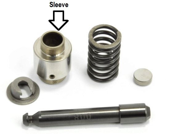

I installed mine last weekend. I didn't have any issues getting the tappet into the spring retainer. I just used the tools and tapped it in with a screwdriver handle.
I did however have a couple issues, none related to the new internals but rather removing the stock internals. I think the instructions could be a little better in describing how to remove them. I also blame myself for being a noob, I'm glad I had my brother there to help out, DON'T DO YOUR FP INTERNALS ALONE NOOB!
Following Corksports intructions, the high pressure fuel line is a real pain in the ass. I think it would probably be quicker and easier to just remove the battery and intake/turbo inlet to actually have good access the the nut. Without doing that it's a world of quarter turns, smashed fingers, and doing some gymnastics and shit with your wrenches to find an angle that they'll actually go onto the nut. MAKE THINGS EASIER FOR YOURSELF. JUST TAKE OUT THE BATTERY AND TIP. SERIOUSLY. THIS DOESN'T HAVE TO BE HARD.
The first issue I had was removing the seal screw from the pump. I didn't realize at first that you have to push down on your socket and compress the spring a little to get the socket to fully sit on the nut. Or maybe my deep wall wasn't deep enough? I nearly shit myself during this bit because I didn't realize that at first, and thought I rounded the nut like a dumb ass. I did actually round the top .5-1mm of the nut because that's how much of the socket would sit on it without compressing the spring, luckily the nut is a lot taller than that, otherwise I would have royally fucked myself and be needing a pricey new pump. You should also use an impact wrench for this part. If you don't have one you should immediately cancel any plans you had in life and go get one. Don't you dare try and use an impact to put that shit back in though, I will find you and smack the shit out of you with a bag of dicks if you try that. DON'T MAKE MY MISTAKE. PUSH THAT SHIT DOWN WHEN REMOVING AND INSTALLING THE SEAL SCREW!
The second issue I ran into was actually getting the stock internals out of the seal screw. All installation instructions and videos I've watched say this is easy as pie and just use your fingernail and lift them out, I'm convinced that this is the way it should be and that mine just hate me. Well I don't know what kind of fingernails you people have but I don't think I would have been able to do it that way even if they were stainless steel. I tried to pry them out with my fingers and a screwdriver for like 30 minutes. No matter what I did those OEM bitches would not come out of there. I ended up using the 12 ton shop press and just pushed them out. MY STOCK INTERNALS WERE ANNOYING CUNTS. I HOPE YOURS DON'T HATE YOU LIKE MINE HATE ME.
My third issue, which was really just a complete failure on my end, was the gas safe container. Gas safe container means get a gas safe container. A red solo cup is not a gas safe container. If you use a red solo cup as your gas safe container you will try to pick it up at some point to move it on your work bench. When you try to pick it up the whole top half down to wherever your gas is will magically detach itself from the rest of the cup. You'll think WTF? The fuck just happened? Is this real life? Then when you realize that your gas safe container is melting onto your work bench, because of all available choices your dumb ass picked a red fucking solo cup to put gas in. Then it's all Oh shit! Oh shit! Shittttt! Fuck! Fuck! OH SHIT! FUCK! as you freak out and quickly remove your nice new internals from your cup and try to pick that melting shit up and get it outside your garage. While doing this the cup will fall apart in your hands and you will spill gas all over the fucking place and hopefully there is nothing around to catch your house on fire. A side effect of this will be you looking like a complete retard juggling a melting cup full of gas and screaming profane language. Many lulz are to be had by anyone around to watch you during this process, you will then join in the lulz because you're a dumb ass and just went full retard. DON'T GO FULL RETARD. A RED SOLO CUP IS NOT A GAS SAFE CONTAINER. CORKSPORT CANNOT BE HELD LIABLE IN ANY WAY IF YOU USE YOUR INTERNALS INSTALL AS A WAY TO BURN YOUR HOUSE DOWN TO COLLECT INSURANCE MONEY.
Holy shit that is a lot of text. Anyways, that's about how my internals install went. Not really that bad of an install, it's pretty easy. It's not enjoyable at all though and for me it was a PITA. Just make sure you pay attention and keep everything clean. This is not the install you want to fuck up!
I've got about 150 mile on these internals now and everything is going good. I went WOT for the first time today. Here are two WOT logs comparing OEM vs. Corksport.

Today, we learned that our recently released fuel pump internals were not manufactured to specification. As a result, we are recalling all pump internals kits sold to date.
Our original designed and validated internals functions as intended. We did our due diligence on the design. However, they were not manufactured in volume correctly and we failed to catch the error internally.
All customers are being offered a 100% refund, including shipping cost or a $200 store credit if they choose to wait for replacements, which are 4-6 weeks out the best we can estimate.
Unfortunately, we did not do our due diligence on quality control of the first batch. The “Sleeve” was manufactured about 0.2mm larger than we designed and tested. This results in the sleeve not fully seating inside the pump housing. This can cause the spring to bind and eventually the pump to fail.
We have had one customer break a pump and we have replaced it. We will do the same for any other customer affected.
We have already reached as many customers as we could by phone and sent an email out to all the others with a 24/7 cell phone number to answer questions.
We take this matter very seriously. We have erred in quality control. We appreciate the trust you place in the CorkSport brand and we will do everything in our power to rebuild that trust.
