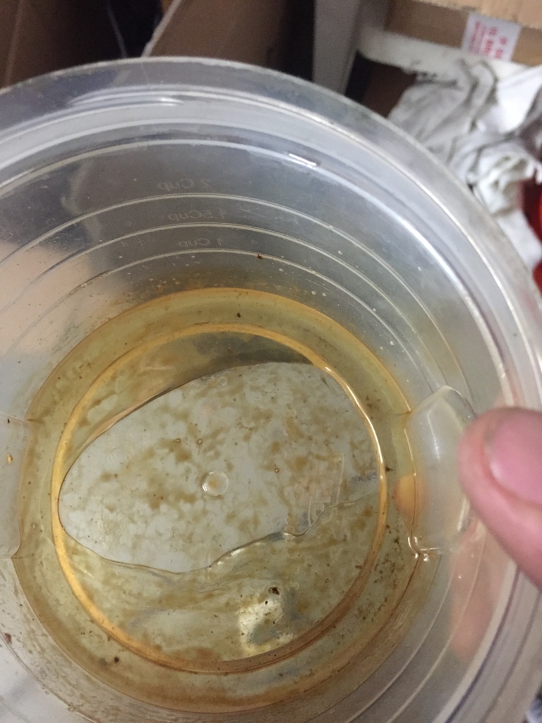

I have never had that much fluid come out of my OCC. I just drained it for first time in months during winter and not much came out. engine dipstick not popping out so don't think it is clogged. Saikou Michi oil catch can.
I will try to take a look in intake to see if stuff is getting by but seems like that is excessive for ~200mi.

Since I have been off E85 I don't get as much. This was from a little under 200 miles
Shit still stinks though.
