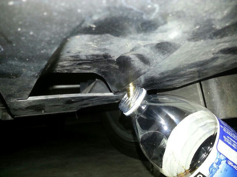

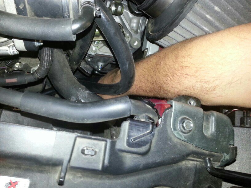

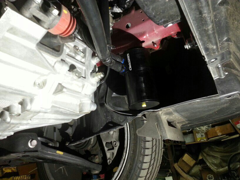

I finally got around to installing Corksport's new catch can they released a few months back. I figured I would share my experience with this contraption.
The new design of the can looks great, and I thought the built in dip stick was a neat idea. I was a little sceptical of how the hoses were routed with the IM being plugged and using the Intake as vacuum source for the PCV & Valve cover Breather. I ignored any doubts that were building up in my brain and preceded with the installation. Corksport's instructions were very clear and easy to follow. I liked how this catch can bolted directly to the frame utilizing unused factory nuts. Installation took about an hr or so.
After the installation I started my car and drove home. I pulled out my AP and monitored my fuel trims, they were normal. When I got home I let my car idle for a few minutes as I looked at my AP and I noticed that my car was idling incredibly smooth. My car has always had a rough idle, and I have been trying everything in the book to smooth it out. I guess the CS catch can was the fix my car needed.

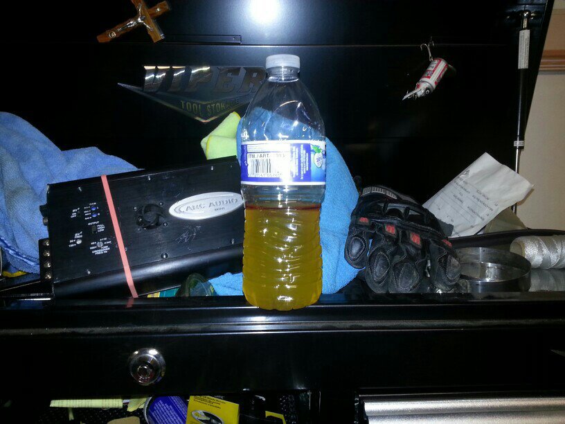

After a few hundred miles my car started smelling of fuel which means its time to empty. so I emptied my catch can like so... and got this
I am amazed of how much crap was going into my IM. I could not be more satisfied with the results of this catch can. I recommend this to anyone who do not already have a CC.
Sent while cleaning my spill valve again...

Wow, that's abnormal for California. where is Ripon, Ca?
Anyway, glad that fixed your rough idle and made your engine happy.

Holy crap how many miles to get that much stuff in your cc?

Most of that most likely formed in the can and not the crankcase. Accumulation is influenced by temperature vs. dew point and by how a particular car is driven. Even just a few short trips of the oil not rising to full operating temperature can cause condensation.
Exactly this, I am in the Midwest and have this same oil can, during the summer I could go thousands of miles with very little accumulation in the can. Now in the winter I have to empty it about once a week due to hot/cold cycle condensation.
If it's really cold make sure to drain it often before the frozen contents can interfere with the PCV system when cold starting.

Why do so many people insist in dumping their catch can where they shouldn't? I just put it in my oil collector and then when I do my oil change, I take the oil to get recycled with the catch can shit inside of it.
They like feeding animals??
Don't worry, its usually in a bottle or my Girlfriend's Tupperware. The main reason for the solenoid is because I am back on the stock intake, and it is too much of a PITA to empty.
Then again a dump to ground would be fun too. But don't worry I'll only pull a Herbie in front any rice and/or Prius.
I drain mine into a water bottle so I can see how much it collected and what it looks like and then dump it into the container of used oil waiting for recycling. I though everyone bumped theirs in with the used oil.
Agree 100%
My commute is only a few miles. After driving only 1000 miles on fresh oil, I noticed my dipstick was above full. I then drove a 40 mile trip and checked it again and it was well below the full mark... Before this, I was about to pull the trigger on a catch can, but now I believe that all that needs to be done is make a 30 mile trip once a week... I read this same practice is recommended on Mobil1's site too, for normally short trip use.
I'm sure the OCC can benefit by keeping more crap out but I'm not convinced that it's critical, especially if you do long drives regularly and keep the oil clean.

Yeah the new hoses are fine. The only problem I have is that my TIP has a lot of oil in it from the OCC connection to the inlet of the turbo. Now I am wondering if I should try to stuff some steel wool into the can to see if it will catch more oil. Mostly I just get loads of water (condensation) out of the can and not much else.
