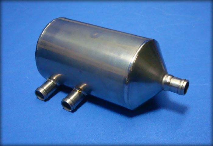

I'm curious as to how different these designs are. Is the media within the can different? Do you have check valves? Or an additional PCV valve? It's a pretty simplistic design.

The version we are testing now does not use media.
Instead, it has an inlet and outlet that are both tangent to the sidewall. This will basically spin the atomized oil out of the air as shown in the picture. Also, the low pressure created in the bottom will also help suck out any oil that may be trying to make it to your intake tract.
-Derrick
I just got a woody.
Solidworks ftw.
Will this be compatible with GenPus? And - what kind of a mechanism are you looking to use for draining? In your test setup it looks like the bottom red hose had a bolt stuck in it
