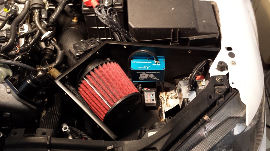

All it really took was opening up the cutout for the intake tube. I opened it up with a 4 1/8" hole saw and then it just takes some aligning the HTP tube to the box.
For me, this is mostly aesthetic. With the CAB, IATs are usually 10-15F cooler cruising and much lower at stop and go (usually peaks around 90-100F), however from multiple tests I have found zero gains from the lower IATs. Zero. Nada. I just prefer the sleeper aspect of it.
It does change the fuel trims a bit vs. the open element in the 1-2.5v MAF voltage range, but I can say that it doesn't impede flow at all.
I think I am going to shoot the TMIC with some black paint next.

Great, now I need to go find me a CS cab for my htp intake and MS6. I too love the sleeper effect. It's why I have a Corksport TMIC and factory shroud.

How does it sound? (any change?)
 Old 08-10-2014, 09:40 PM   #5
dale_gribble's Avatar
Posts: 4,720   (View Stats)
Rep Power: 5431
Thanks: 2,552
Sound doesn't change at all which is actually pretty quiet with the htp to begin with.

that cold air box looks like it fits better with the HTP intake than it does with the corksport intake!

Wow, looks good. Makes me wonder though, I was barely ever able to make the CAB work with the full CS intake. I got it in there but was never really happy with how it fit. Took it out a few months later and now have the HTP 3in. Never even considered trying to get it to fit with that.

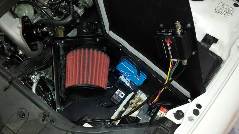

As a follow up, I found the CS CAB is a GREAT place to hide stuff to keep a clean engine compartment. Now my CS CAB has the Guardian Angel, DVC-30 meth controller and fan controller safely protected from elements and hidden away.

Dale - you don't have any issues with water coming up from the wheel well? I have found in the winters here I needed to cover that hole to prevent a lot of the slush and wet crapola from getting up to the filter/inlet...

I was able to stuff one more thing in the cab. I had to go on the lid. Lol. I figured I had better stop here or there won't be room for airflow.
We got a guardian angel, dvc-30 meth controller, fan controller and meth failsafe.
No officer, pretty much all stock.
Best part, everything you see in the box is on quick disconnects so I can pull the entire box out in 5 minutes.

Dale, is you HTP intake attached to the bracket/stud on the block? You are running it with the BNR now -- did you have to trim the coupler to the turbo inlet?
 Old 10-19-2014, 09:41 AM   #25
Rep Power: 5431
Thanks: 2,552
The htp has no provisions for connecting to anything. It just basically is held up by the recirc tube and vent line.
I just ran the coupler as it came w/o trimming.

I plan to use the GA, and a Meth kit whenever I swap turbo's.
Also running their battery box, so it would look nice and clean with that as an addition.
Just gotta hope whenever I swap turbo setups it does not push the intake over more and I can not use either.
