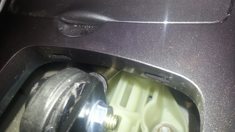

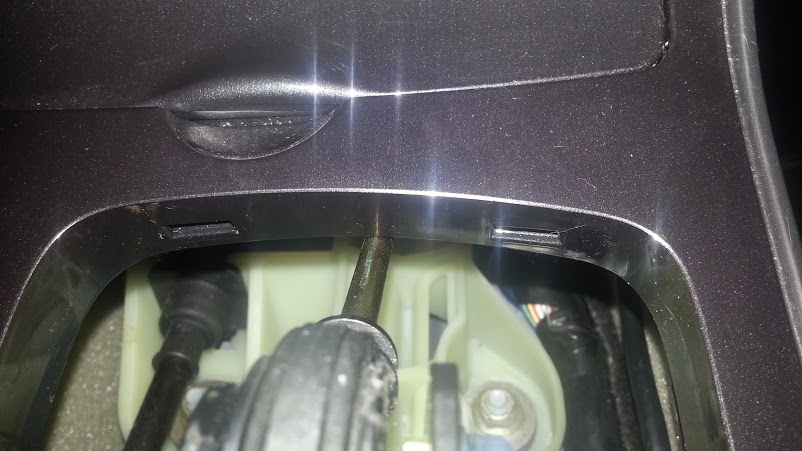

I can understand wanting to keep the install as easy as possible but I had to drill a hole for the bottom bolt on my 03/06 build date MS6 so what's one extra? You could at least leave a hole on the side to help the people out who do want to drill their own hole. If you wanted to go the secondary brace structure route just make sure to trim the piece enough to miss the OEM welds.
Ditching or etching the logo should solve the strength issue and if you paired that with a thicker gauge it would most definitely be overkill.
You should also resolve this issue while you are at it:
(3rd Gear)
(Neutral)

Has this plate been redesigned with these 2 flaws taken care of?

They will be back the 2nd week of never at this point. We revised the shift plate with a thicker steel but they were still too close to the trim panel so we decided to kill the part off instead of going with a version 3.
