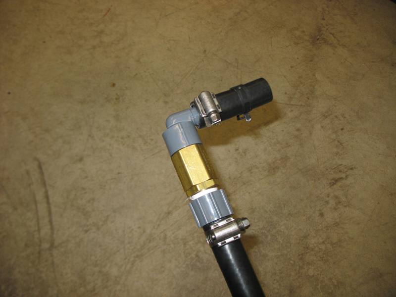

so I'm still talking to CS. my CV is on the CC side, not the intake side. they say their can can't handle the pressure the engine puts to the OCC and says the CV must be on the intake side. My instructions i rec'd did not say that. I know there was a subsequent message sent out (per CS) that mentions the fact that they suggest a CV on the intake side.
However, nowadays they aren't even using a CV. they are routing their tubes to use the TIP. it's quite an 'interesting' design that could put oil back into the intake. hmm.
anyways, we'll see what they say tomorrow.
to check the CV is easy by removing it and using compressed air to try and open it, say give it 25PSI. If its working the PVC is not material to the OCC pressurizing since the CV will prevent that.
one thing is, the parts need to be connected in the right order. so it would look like this.
CC>PCV [OE setup] >OCC>CV>IM
As long as the CV is installed in the right flow direction, meaning it will not allow airflow from the IM to the OCC, you should be good to go.
as stated...my CV is not between the IM and OCC. it's on the CC side. when i installed the CS OCC the instructions did not mention a CV at all. i had purchased JBR CV and so relied on their instruction to install the CV.

no solution from CS. basically a 'too bad for you'. i see where they are coming from, but it's unfortunate that it had to go this route. some miscommunication and what i would consider poor build quality had led to a loss of $140+. After replacing the sub-par lines and fittings supplied with the original kit, it's a total loss. oh well. JBR one on the way.
to those that have the CS OCC and have not had issues, i would suggest that you do two things:
1. if you still have the CV, either switch it to their new routing design (which i still don't like) or pray your CV never fails. cuz if it does, bye bye OCC.
2. forget the $25 replacement lines that they say they'll now sell you to replace the shit lines they gave you initially and go to autozone or napa and buy your own 5/8" nylon-reinforced line. for the length you'll need (~5 or 6 feet depending on how you route it), it'll cost you about $9.

Welded or not welded, the check valve needs be installed on the right side or needs to be re-routed in order not to pressurize the can.
cheers.
I am sorry that you are unhappy with the outcome. We cannot warranty against installation mishaps. We always try our best to provide clear and concise instructions and to make our customers happy so I am sorry that your experience went sideways.
I personally emailed you regarding the addition of the check valve and attached the instructions on how to install it at that time. In the instructions it clearly states the following:
1: Locate the silicone hose that runs between the intake manifold PCV port and the lower port of the Catch Can.
2: Simply, Cut the hose in a location that would be easy to secure the valve. Then, insert the valve at the cut securing it with the supplied hose clamps.
Note: Make sure to install the check valve in the correct direction. We don’t want pressure entering the catch can so the easiest way to tell operation direction is to blow in the valve. One way air travels freely and one way you shouldn’t be able to blow through. The side that you can’t blow through should be attached to the hose leading to the intake manifold. The other side should lead to the Oil catch can.
3: After routing the silicone hose and installing the PCV valve, make sure to zip tie the hoses securely so they will not move or contact any moving parts.

In my email to you, I stated the following:
CorkSport is highly recommending all turbo vehicles add an additional check valve inline on the intake manifold side PCV line (Lower port at the catch can).
We will be adding the check valve as a $10 option to the product listing, but would like to take this opportunity to offer you a complimentary check valve from CorkSport or the option to purchase a check valve from your local auto parts store and receive 10 rewards points on your user account.
Again, I am sorry because we want to maintain your business and the trust of the community. That is why we took the steps we did to ensure that when we identified the customer with the over pressurized can, we took immediate action to ensure no other customers experienced the issue.

you will now get into a conversation with them about an email they sent out about installing a check valve or taking 10 CS credits. But again, maybe you'll have some different issue since it's not a 3. I'm not sure on that one.
check valve (per JamesBaroneRacing.com - his image):
