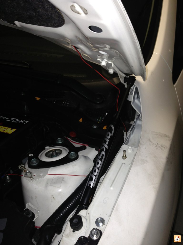

Originally Posted by Corvette Tuner View Post
I got mine on this morning. They do work well and hold the hood up without issue.
When I first started I noticed I was missing 4 nuts that go on the underside of the supplied
brackets. There is no mention of these in the instructions, but you have to have them.
Everyone that ordered these better check your box to make sure you have them!
Corksport, you guys need to check these before sending anymore out!
Anyway I had to go to Home Depot to get 4 M6x1.0 nuts to finish the install .
Overall it's an easy install except for geting the nuts started on the bottom of the brackets,
which was a bitch.
I am happy with them and think they have a nice oe look.

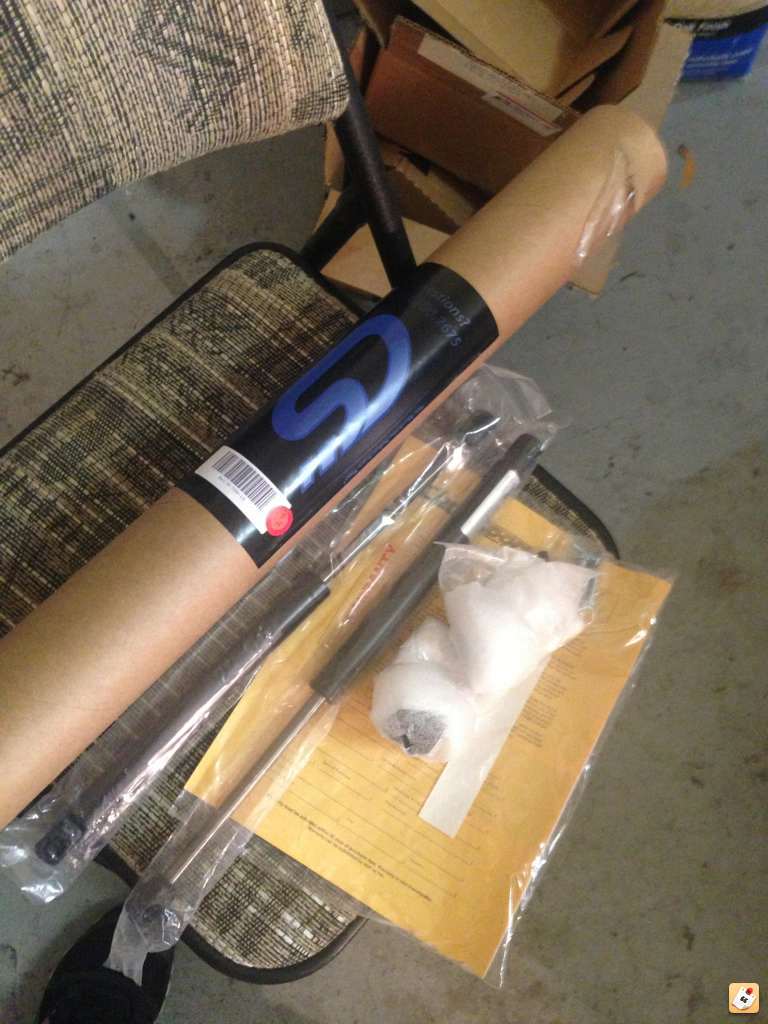

For anyone missing the four nuts that does not want to wait on Corksport to send them...
You can pick them up at Home depot in the bolt section. They look the same as the two larger nuts they included, but are smaller.
Pic of pack:

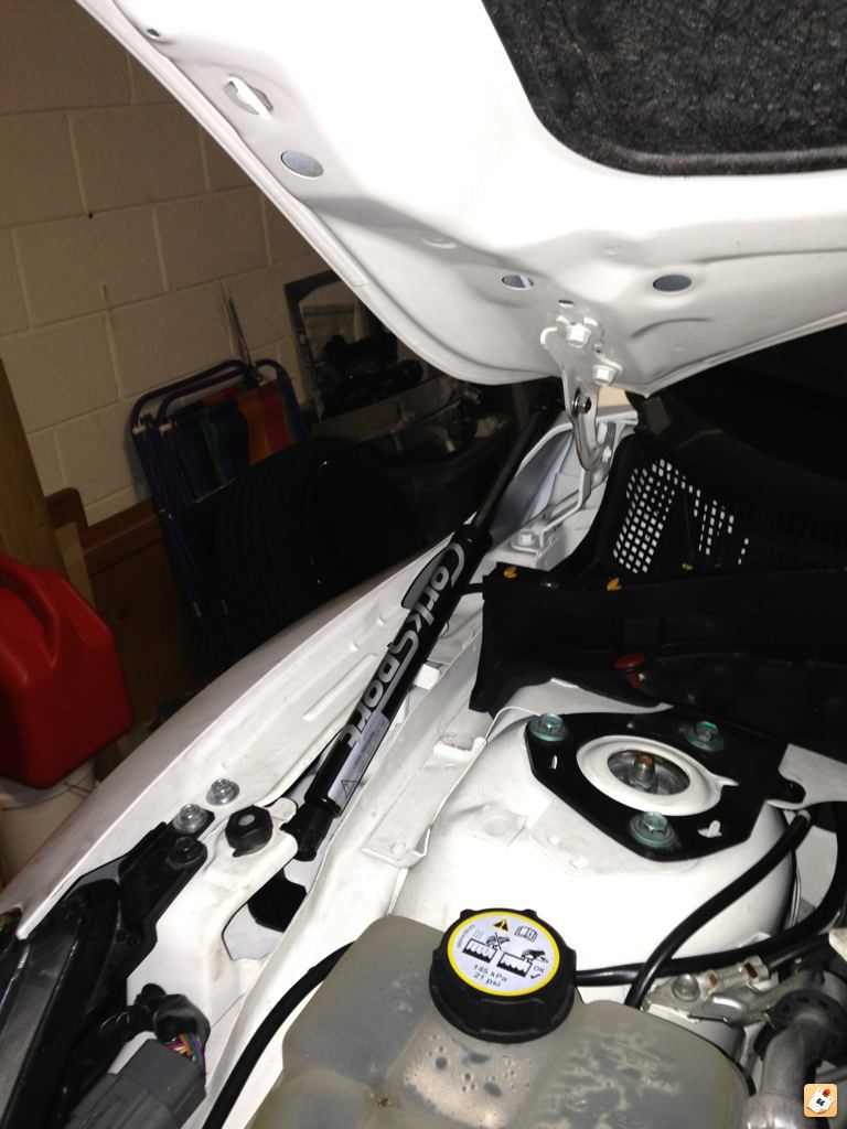

Having an Install issue and I sent pictures to @Spencer@CorkSport. I have my brackets in correct (I think); they look the same as everyone's photos above. It seems like the strut is too long by 1 cm.
I've attached some photos. First photo is fender bracket and second is hood off of prop rod full extension. My struts cannot compress by hand (even using my weight on it against garage floor) which seems wrong if the hood should be able to compress them. Am I missing something dumb?
@balababum ; @evil MS3 ; @Corvette Tuner ; @Joel@CorkSport ; @CorkSport
no its not, just push the hood more(like opening) until strut click to ball joint
Originally Posted by evil MS3 View Post
Do you have the hood raised all the way? It can't be resting on the stock hood prop.
The brackets look good. But can you get a shot of them from the side?
Also, I found it much easier to attach it to the hood first then get it on the bracket.
I'd the hood is all the way up, loosen the brackets and see if they'll move at all to give you a little more room.

I took one of those pics too! As I said in my previous post, that's with the hood full extension off the prop rod. I feel like I'll start bending the hinge if I lift any higher. Did you guys try hand compressing your struts? Mine will not budge.
PS - I remembered to rotate the image this time.
no, i didnt i just push hood lil more raise, and then fit perfect

I didn't have to compress. Brackets look good.
The ends of the strut can be loosened, were they tight?
I'd suggest trying to put them on the hood side first. Easier to get them on the bracket after.
A little tapa tapa taparoo...
I tightened them as much as possible to the point I had to rotate the strut rod to get the ends 180deg from each other.

Only thing I can suggest again, loosen the bracket bolts and see if you can get the bracket to rotate a hair towards the front of the car.

But first, seriously, take them back off the bracket and install on the hood side first.

Got it. I Loosened bolts on brackets and they turned about 0.5 cm so the strut was only 0.5 cm off. I snagged my wife to hold hood in place all the way up so I could push on strut and not bend hinge and got strut to compress enough to get it in the last 0.5 cm and in. After that, 2nd one was a breeze because the first strut kept the hood in the right spot.
It was odd because it was a tad off and it felt like I was going to force it and I'm super careful because it's cheaper than pushing too hard and breaking stuff.
Pics of said happy wife included.

Glad you got it. Yeah you just gotta play with it to get it just right.

got mine installed today. bolting the brackets on was a little bit of a pain. if you guys at @CorkSport; would weld the nuts to the bracket it would make the intall 100xs easier IMO. other than that...fits great and im happy with them. here is a link to a few pics
http://www.mazdaspeedforum.org/forum/foru...ml#post2232525
I was thinking the same thing. Probably only need to do that on the one that doesn't fit around the nut tacked to the frame.

Welding the nuts could take away some of the flexibility in the install though. Remember, none of these cars are exactly the same, especially the body panels and the way they are fitted. That 1/8" could be the difference needed in a car that has seen a lot of potholes or was built on a Friday. It would make the install a bit easier... but at least you have the pride of being able to do it right???
