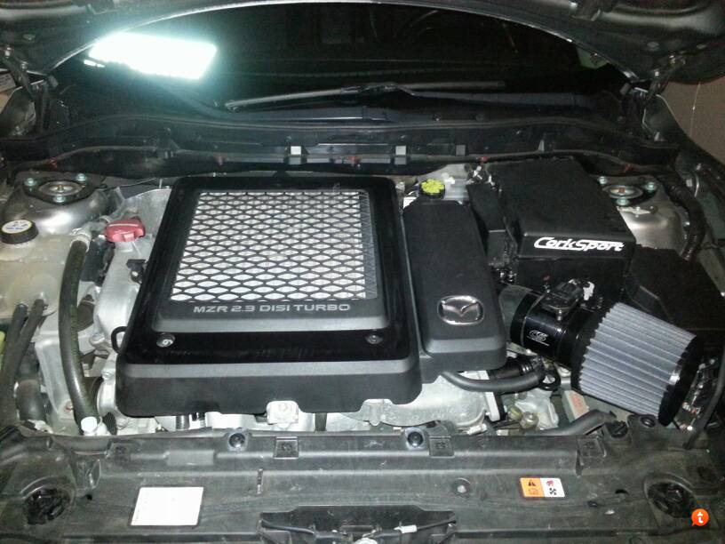

Better get the battery box. Eventually the rubbing will make a hole into the fragile ECU plastic cover.

I installed this intake on a friend's Pu. As with most CS products, some fitting was required but I only had to trim the recirc hose an inch, hog out the first two battery box holes, and remove the ecu cover. The battery box was snug up against the intake but was not crushing it. Slim battery box was not needed.

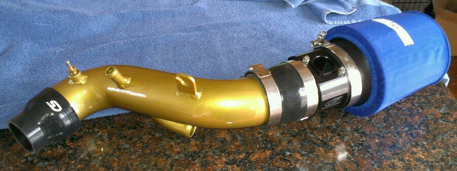

Looks good in gold. Just sayin..

The red coupling is still growing on me. I'm wondering if I should a went black like on my old one :/
