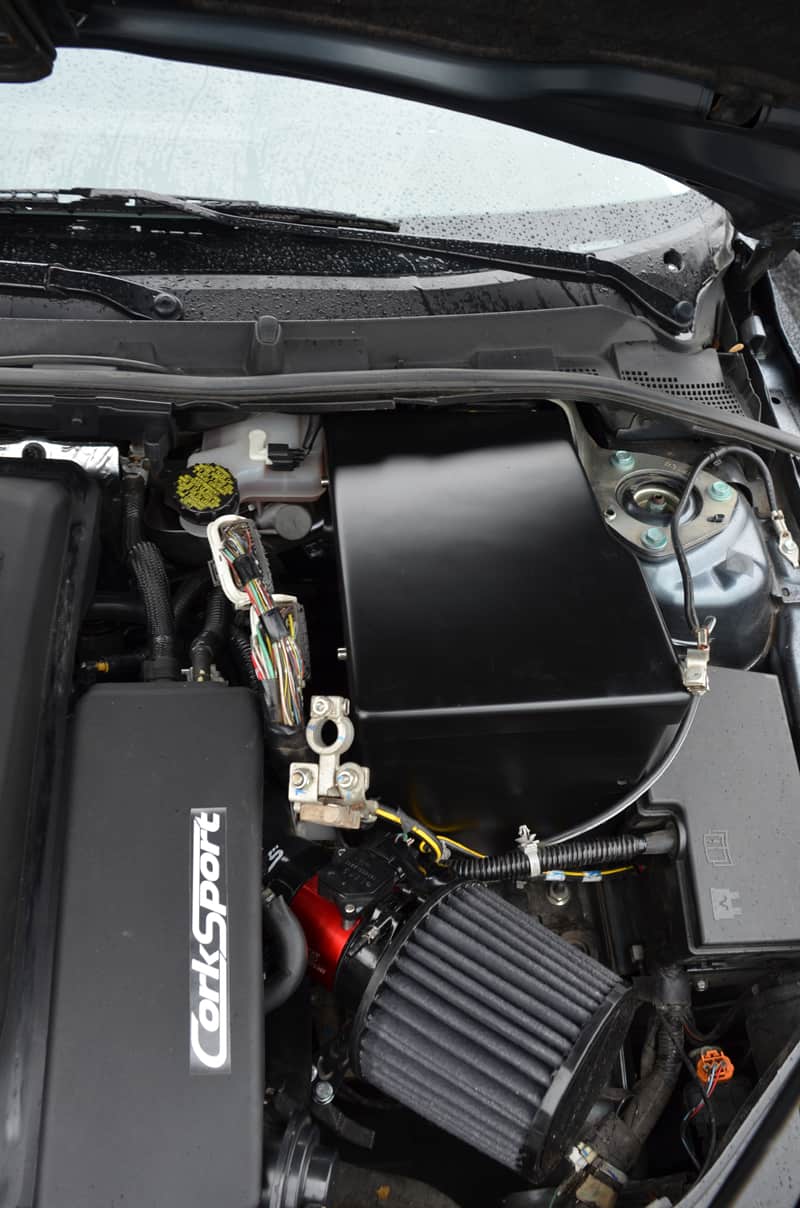

@Spencer@CorkSport; needs to fight for getting these new CS products made for the First Gens since he has one... Bat box, Coolant tank...

I'm trying.
Also to everyone questioning if I have an AP.
I do. Sorry I forgot to mention that. It's a V2. Already been running some logs and of course just running an OTS Map for the CS Intake and TIP that I installed this weekend.
I might see if I can "borrow" a battery box soon and get it to fit. No promises or guarantees though, just a thought.

It will fit a GenJuan no problem, as long as the intake is smaller than 3.5". At least that's the issue I had on my Juan with the prototype box.
Only time I've ever had an issue being too big at my 3.5"

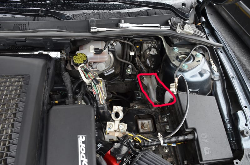

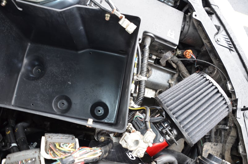

Here it is test fitting in my MS3. As you can see it doesn't fit perfect. With minor modification it should work fine, but for now it is not being sold for the Gen 1 due to the fitment issues.
You can see the hole in the back doesn't line up.
The red circles show the locations the box is hitting slightly thus causing the mis-alignment.
Hopefully our engineers can get this modified slightly, until then, it doesn't work for Genjuan without modification, so in our book, it doesn't work at all.

I'd love too. As seen above I test fit it, and they told me they would be working on it. Took photos, measurements etc. but I think the priority has fallen back.... what with HPFP's, BPV's, Intakes and more that are being worked on/just were released.
Honestly I'd have no issue buying this myself if I had a 3" intake and grinding away just the small portion where it touched, plus enlarging the bolt holes. That's just my thought.
