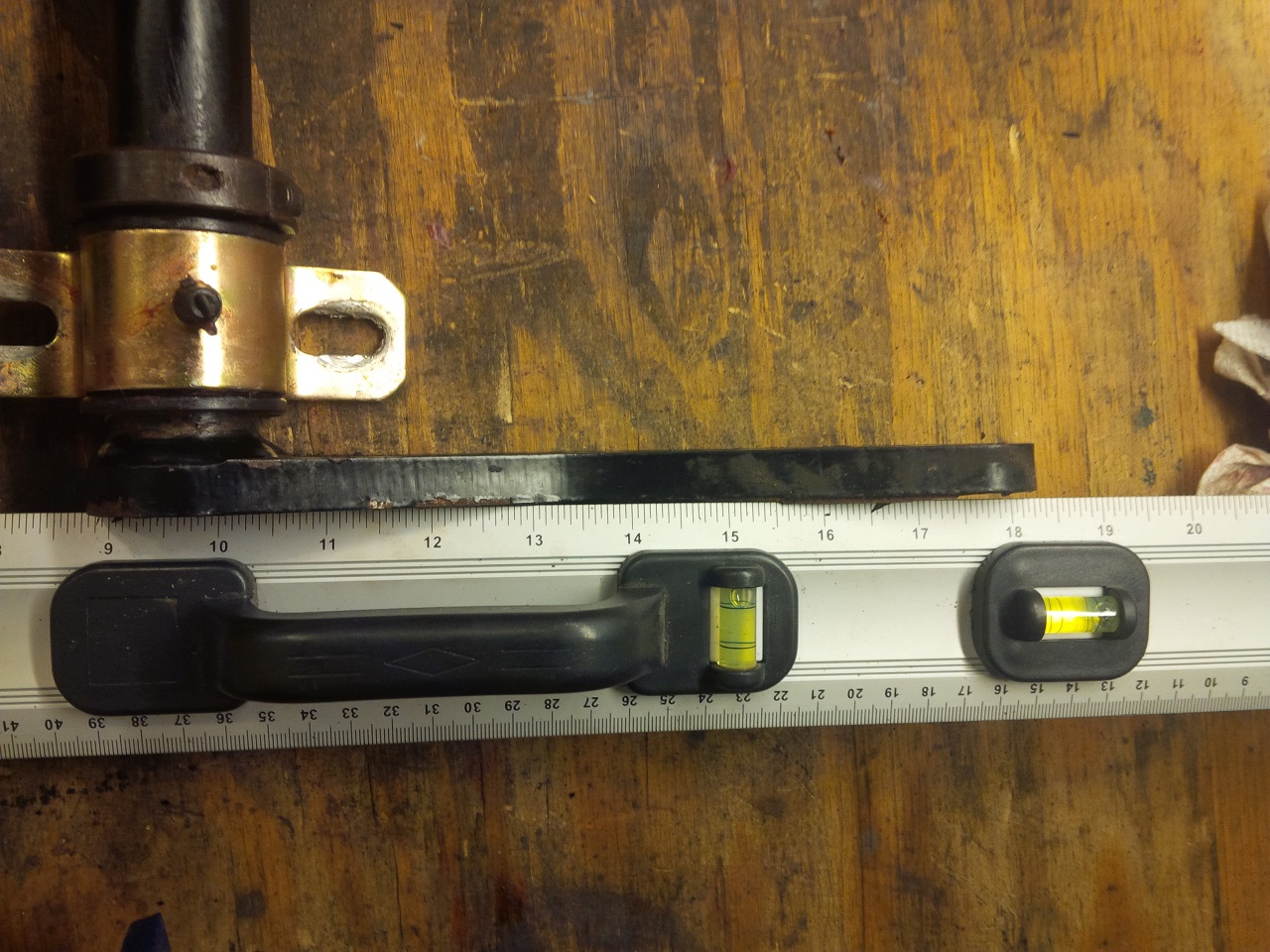

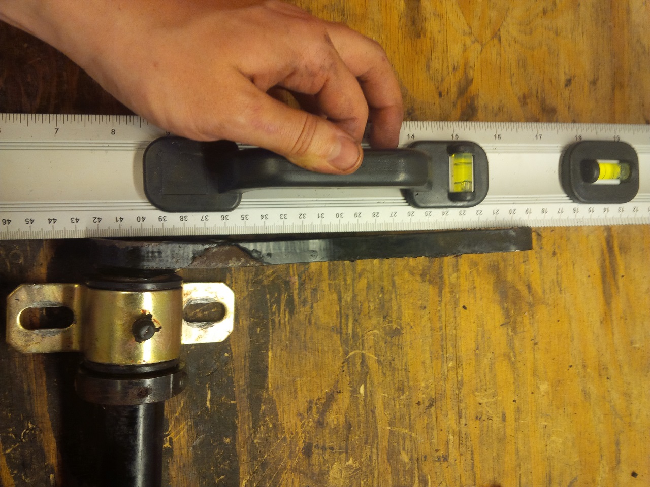

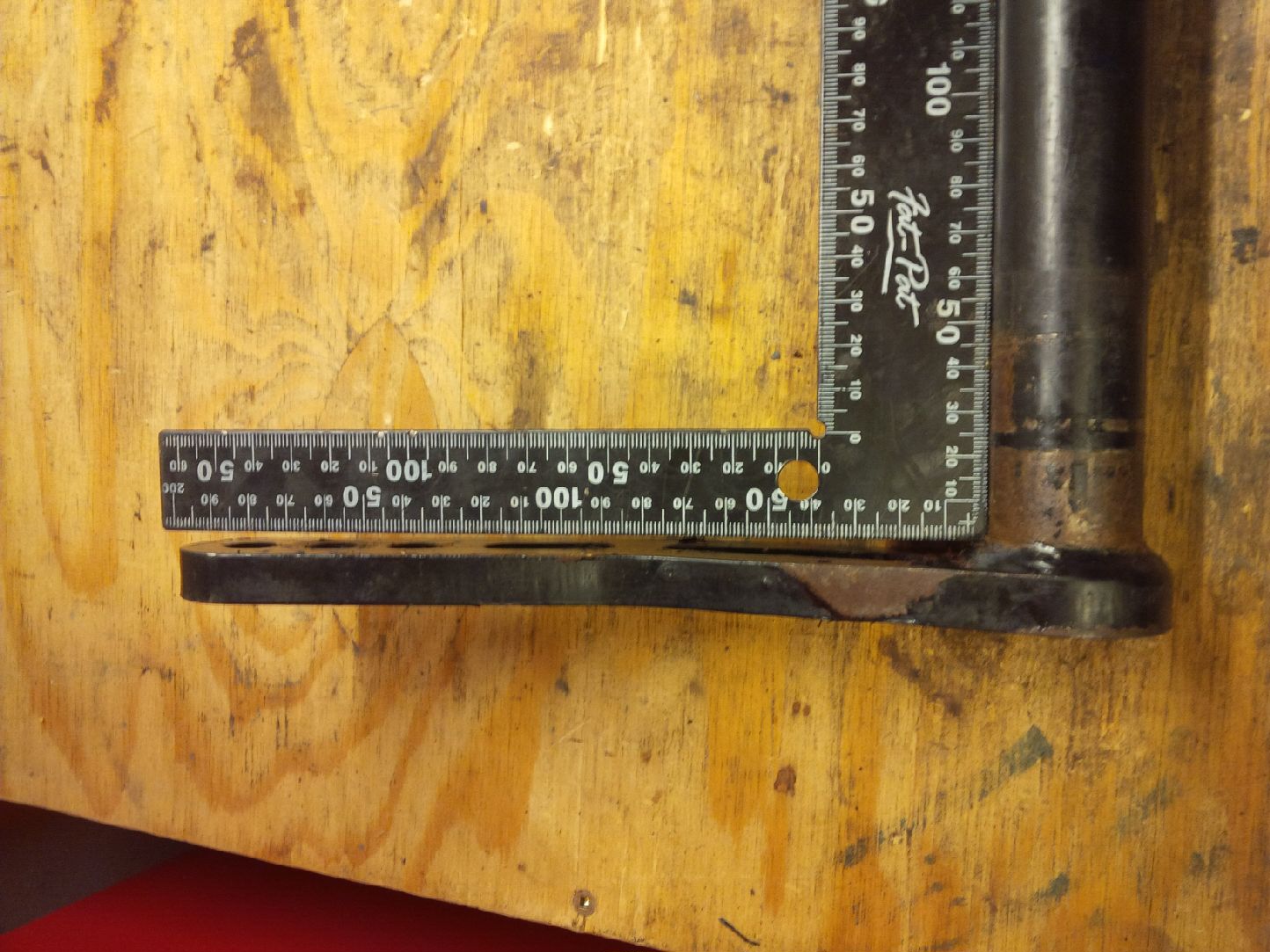

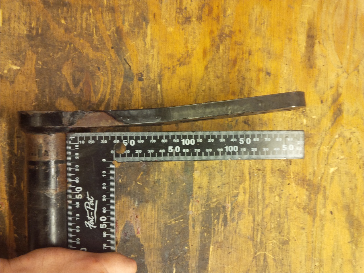

I've had some clunking in the rear end for a while that I've been trying to sort out and couldn't find what it is. Had checked near on everything and all looked good and was tight. So since I still have my extended warranty on the car I decided to remove my Corksport RSB (only suspension mod), put the stocker back on and take it in to Mazda to deal with.
Well...as I'm cleaning up I notice something a little odd.
That's a little off eh?
Yup other side looks good...
I wonder how out of square that is....WOAH

That doesn't look like a defect to me... Looks bent from some sort of impact

Well obviously it didn't come like this from Corksport many years ago lol...that said, I've never had anything happen to the car that should have caused this. Car is just daily driven, never tracked, hasn't taken any big hits, stock suspension otherwise, only probably 30,000km on the bar itself, etc. Seeing the amount of deflection I'm shocked that the endlink isn't broken or bent or anything from it as I would have expected it to be the weak point.
No matter, it's just an FYI post...not blaming corksport for this.

That's a hell of a hunk of steel you bent.... Let's be honest that would take a pretty serious hit to do that.
There is no other way to provide enough force to bend a piece of steel that thick.

LoL it's never taken a hit guys...probably been bent over time, just fatigued metal. If it was a hit (which I can't remember ever happening), the little 1/4" endlink should have snapped rather than the 1/2" thick steel plate bending.

LOL yes it did. You bottomed out, maybe hit a deep pothole or something. My Cobb RSB did the same thing.

Dude, you can see where the paint/powder coat flaked off. That's from an impact. Or at least that's what it looks like to me.

That's what 3 Canadian winters does to car parts...and that's the top side of the bar, up away from the road, would be pretty absurd for something to impact up there don't you think?
Fatigue might not be the perfect word, point is, the more you stress metal (constant vibration, force, flexing, etc) the weaker it becomes and the easier it is to bend.

Well actually if you look at how the force is applied to the bar, the endlink is on the one side and has swivel/ball joints which can make the force not completely parallel to the bar. You can't really see it in the pictures but it's twisted slightly too, basically if you pulled really really hard upwards on the endlink (like tons of force) I imagine this is actually how it would end up bending.
As said though, it's all speculation as to why it bent...I can be 100% certain there was never any direct physical impact to it, which leaves a very hard bump (of which I can't remember happening) or just prolonged fatigue.

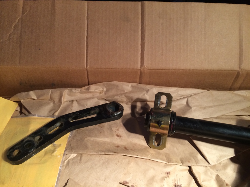

Well, now that I have a new (scratch and dent) bar on the way I decided to see just how much effort it would take to straighten the bent bar back out.
Surprisingly not much, a few minutes in the vise and some muscle and I was able to get it back to almost right on. It's good that Corksport changed the design, the 1/2" steel plate isn't that tough at all. I have no doubt in my mind now that the forces applied while driving without hitting something would be enough to have caused the bend.

Consider yourself lucky. Mine just straight up broke. Very low Km on it. Defect in the weld from manufacturer. No potholes at all. Next to zero support from corksport. Lesson learned.
