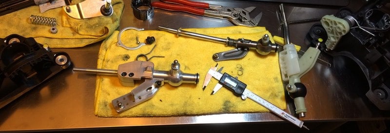

We're working hard on an amazing shifter. If you got to choose whatever features you wanted on a shifter for your speed, what would you want???

What i'm looking for:
Something to get rid of the stock shifter slop
Something that won't fall apart(i see you are using the threaded holes for multiple cable adjustments like the cobb)
One that won't eat up the stock plastic shifter housing on the gen 1.
or if it has a chance of eating it provide something like the seriouspeed plate.
http://www.seriouspeed.com/seriouspe.../i-541335.aspx
EDIT: i'd also like to see a perch for the shift boot.

look at the design in the picture it's the same basic design as the cobb shifter with the 2 allen bolts clamping the threaded shifter rod. it looks like it's going to be height adjustable.
It is height adjustable, slight less side to side movement and adjustable forward and back. But it is not the same design as the cobb. There will only be machined surfaces that touch the factory pieces. So no need for a plate like seriouspeed.

If you guys want less slop, at minimum the entire shifter base needs to be replaced (e.g. The TWM MS3 full replacement shifters), but really the issue is the cables. Nothing really can be done about that. The design of the chassis and trans don't lend themselves for metal shift rods, and unless you want to convert the engine to mount longitudinally, you can't mount the shifter directly on the trans.
The only novel thing CorkSport could do is add adjustable shift knob height.
I see Knipex's plier wrench on your table.
Awesome tool. You get +1 respect.
